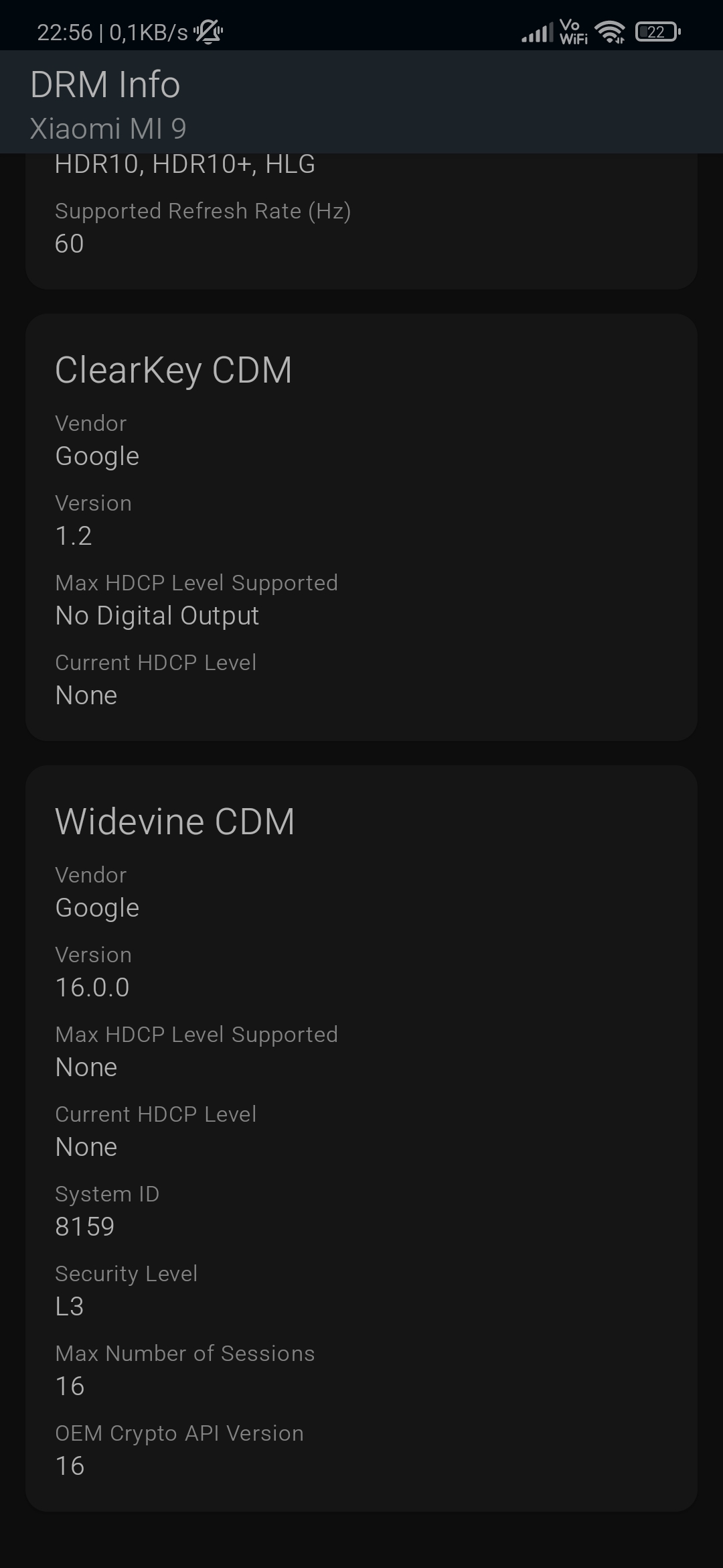

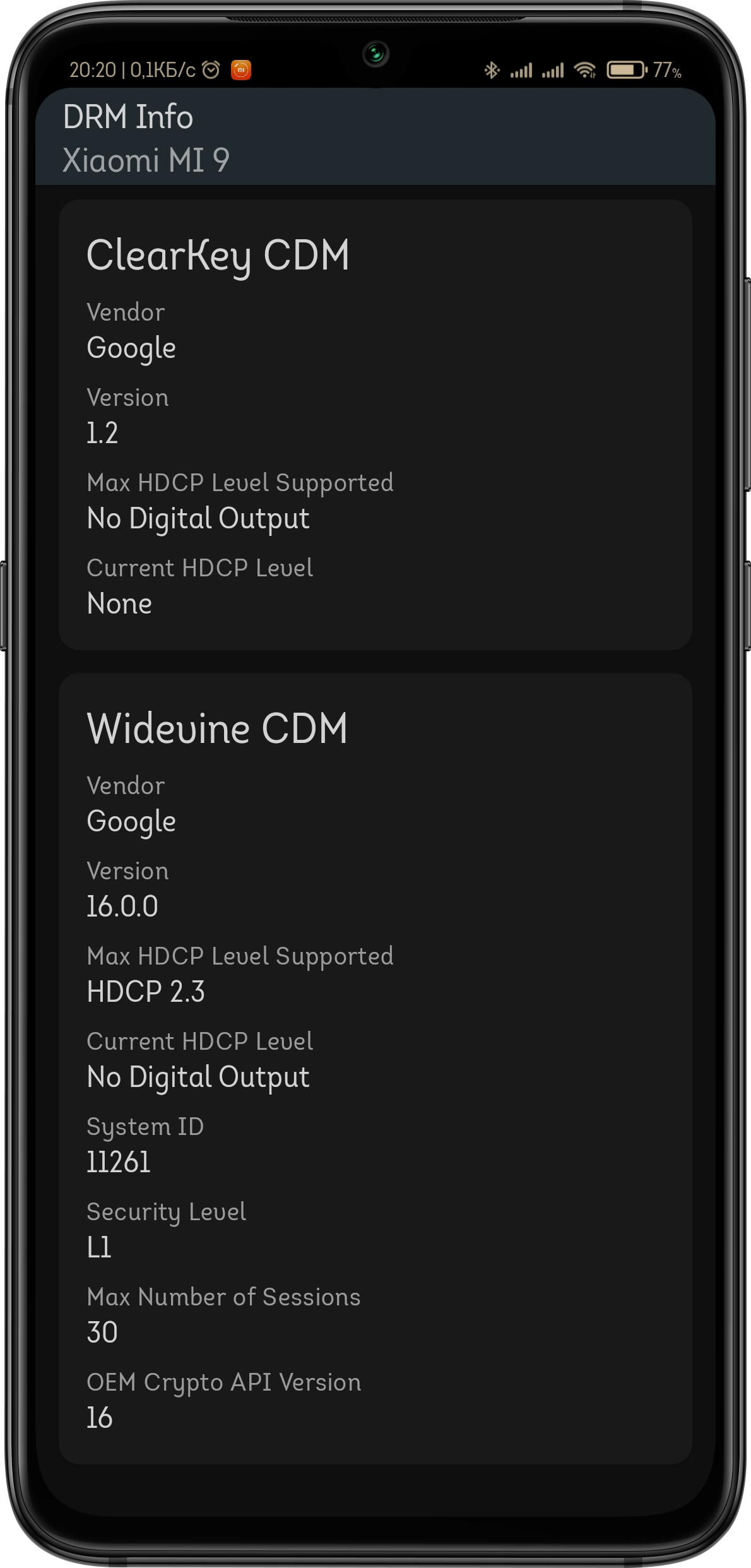

On Mi 9/9T/9T Pro and some other device: Flashing the "persist" partition of your device = Widevine L1 permanently lost...
It's the second week that I don't have L1. Didn't make anything on my phone besides the usual flashing of the ROM like every week. I have to admit that I am on a magisk rooted device. But this issue wasn't a problem at all in the past ROMs. Passed SafetyNet and L1. With Android 11 I have several problems on my Mi9.
I have never flashed the persist partition before! The bug should be elsewhere.
All of you guys that have l3 try delete cache play store play services and Netflix too.
For me working.. I have l3 now i have l1.
Try it
delete cache of
1. play store
2. play services -->(I cant find this name)
3. netflix
I still get L3.
Did you do anything else?
Try it
Which device do you have? L3 Problem occurs definitely on MI9pro
Perhaps problem if because device model is now Redmi and not MI9TPro anymore
Not sure why you would think that, since Mi 9 never had any special Global name and some of its users are also having this issue...
