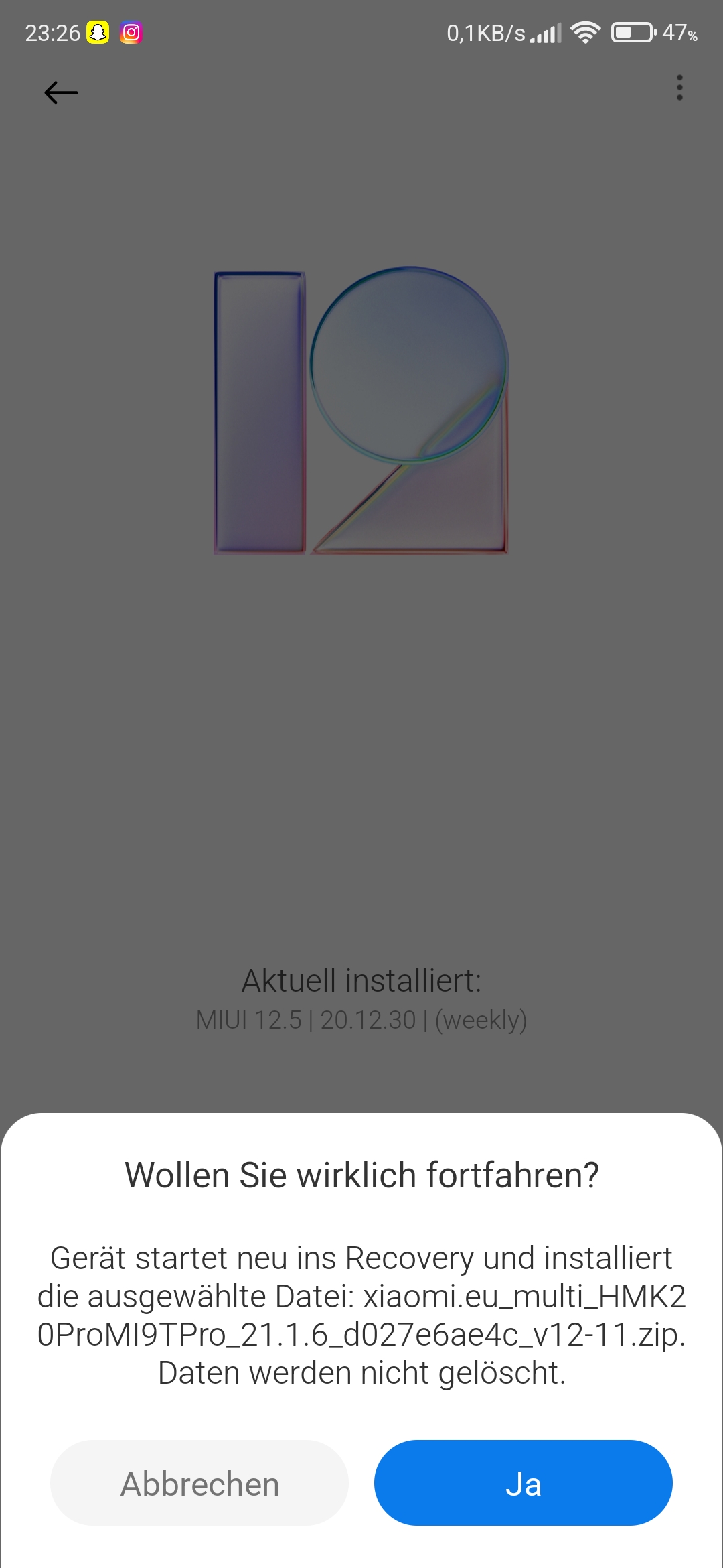

Guys i cant click "yes" on this step but i can cancel it. And I cant flash it trough twrp the file wont show. Can anyone help me? My twrp version might be old how do i update it?
I have a Mi 9T Pro
