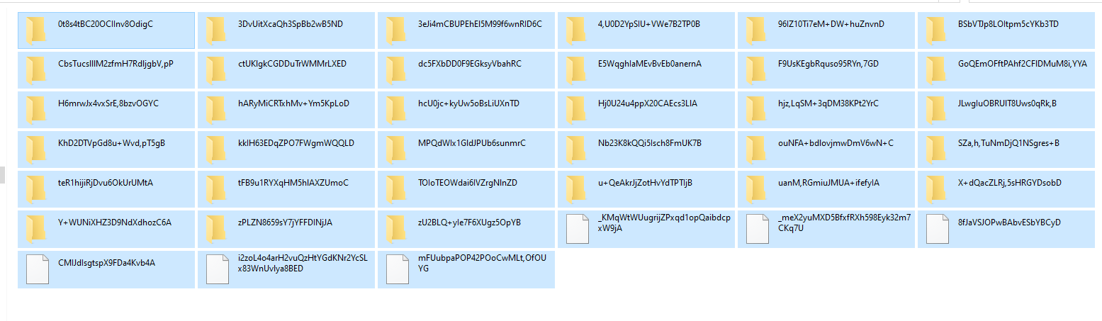

I could not solve the problem neither. I restarted this morning and found that twrp-3.5.0_9-0-grus-teamwin.img can be a solution because I can reboot in recovery with this (with others only to fastboot). The problem is that this version did not request a pattern to unlock and the sdcard is not decrypted (just files and folders with random letters) and I can not copy the ROM to install. How should I recover the normal file structure in order to reach sdcard to copy the ROM to flash?
If latest Official TWRP can't decrypt /data partition, you have to wait for a new Official TWRP version. :(

1. By some reason none of flashed TWRP's request the unlock pattern now (earlier it was requested and file structure was ok to copy the ROM) for this reason on the sdcard there are files and folders with random letters and can not copy the ROM in it. What is that and what can be do to be able to copy the ROM?
33899
2. How can I install the ROM with USB-OTG device, I have not found a description to do that.
3. I would like to avoid clean install, because after several try i could install the previous ROM with format data only and spent two days with restoring.
