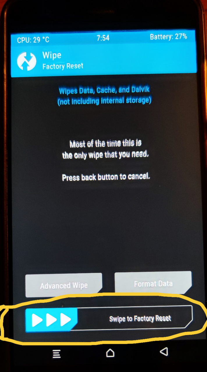

If you have not already tried it, try a Factory reset from within TWRP.
[Edit: ... and do not install any else like Magisk until you are sure that all is OK]
