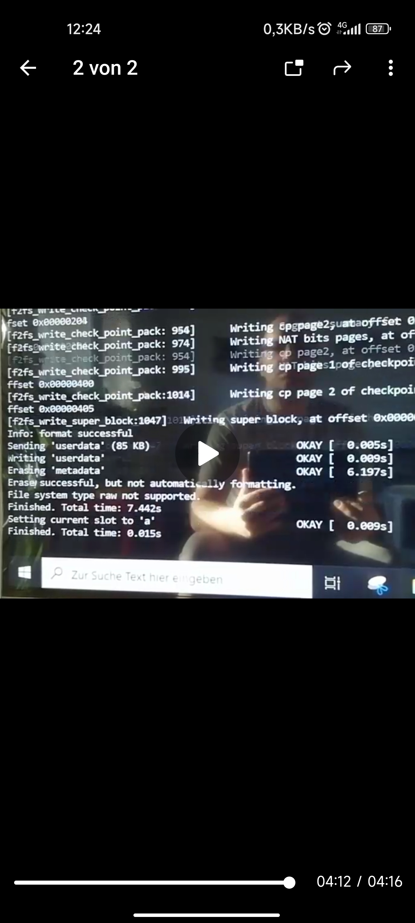

Hey guys. I have a serious Problem here and can't find a solution. Phone Mi 11 Ultra
Im somehow stuck on Version 21.11.11. After updating to latest EU Roms in boots and im still on version 21.11.11. In Terminal while updating fastboot ROM all looks good i can't see any issues.
I tried formating and flashing Stock CN Rom with MiFlash Tool and it worked well. After that i flashed latest EU Rom it showed me again Version 21.11.11..
Tried also formating and wiping with Twrp still the same as somehow the 21.11.11 is hiding somewhere and won't go away. What i am doing wrong?
Ill post last line of Terminal while flashing maybe there is something wrong.
Appreciate any help. Thank you
