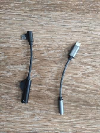

I have a problem on grus(Mi9SE) while playing sound over usb c connector on headphones. The phone says "playing sound over usb" after connect and there are settings for headphones and so on. The problem is that the sound is like a robot in a tube without touching a setting. The rom is a clean install. With my other adapter with usb c for charging the phone play well but there is no settings and no notification about sound over usb. There is only a headphone displayed in the headline.
On the photo which i attached: left working right not working.

Because the connectors are the same at both ends, it does not mean that the circuitry between them is the same. Similarly, some USB cables might be good for charging, and some might be good for data. It does not mean that all cables are good or suitable for both.
Edit: As an example, I just plugged in my Turbo charge (30W) USB cable into my laptop. It charges from my laptop, but there is no data connection.

If it is the problem with the sound over the headphones, then you could do what I have done. Because with the wired connections, the wires kept on breaking, and so I have gone over to using Bluetooth. I have the good quality of Xiaomi hardware sound, with the good software, and the good quality headphones, I therefore have excellent quality sound (better than any of my speakers!) with no problems of wires breaking, or partly breaking.
