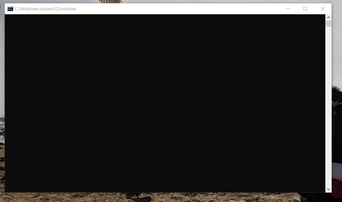

Once again i downloaded this version as the latest one, i posted a doubt in last version but it had no answer, this time same problem, downloaded, all fine, when trying to execute the windows_fastboot_update_rom.bat nothing happens, if i try the first install it starts. Anyone has an ideia about this issue? Mi11
Thank you allView attachment 35911

Hi there guys again, havent had any help.. can please someone help me on This?
Tyvm
I don't have a Mi 11, but maybe you should start by giving the output of the .bat file (by launching it with cmd), or posting in your device forum section.
Most people here don't use this file for their device, so your question is quickly overlooked.

Thank you very much for your help, just do it like you describe, but not working for me, still same lage.
Edit: after ejecting the sd card and reboot everything works fine.
