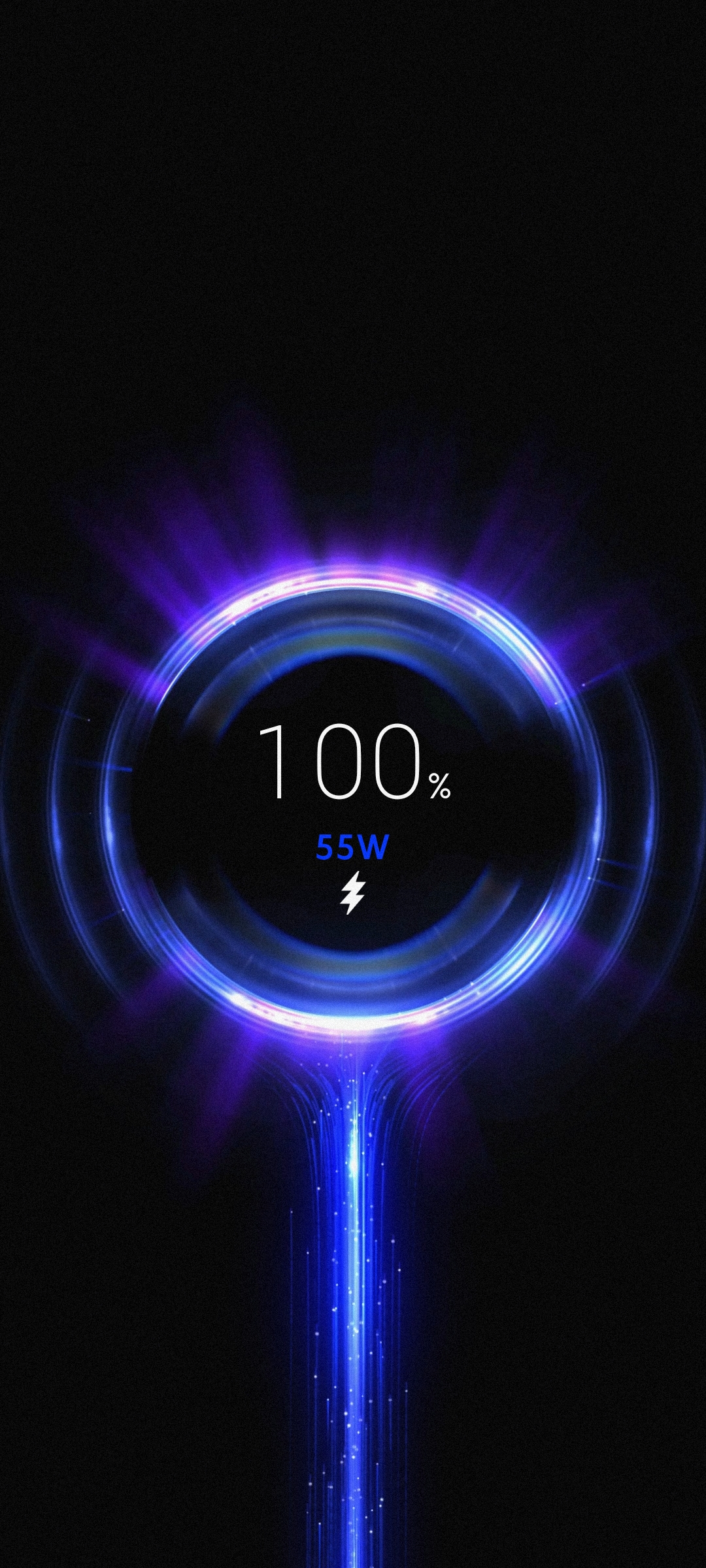

Any idea why the 120 Watt charching mode doesn't work? I have an 120Watt Charger.. But it Shows me 55 Watt..
