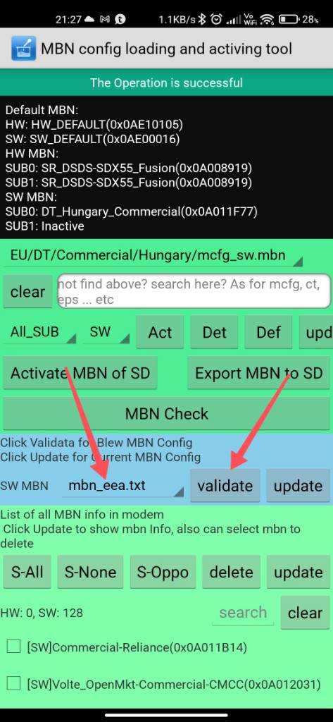

I can also confirm VoLTE and VoWifi not working, but I'm on a MI 10 Pro....
Also no issues on previous builds.
Both VoLTE and VoWiFi are working great on my Mi10Pro.
Open Modem test tools by using *#*#663368378#*#* code in dialer > Open MBN config loading and activing tool > select mbn_eea.txt for SW MBN > tap on validate > wait some secs for update.
See attached screenshot
This did work, thanks a lot!

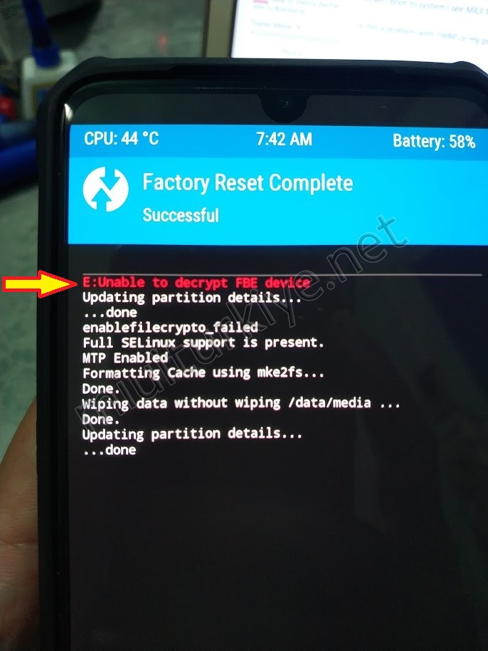

I know that the following error in the latest twrp for tucana (3.5.0) "unable to decrypt fbe device" is not important since the installation is done succesfully. But still wonder how to get rid of it. Could anybody know how to fix it completely?
Thanks for the latest rom btw.
Hello, this error message means your data are not encrypted. It's normal if you used a DFE (Disable Forced Encryption) zip. ;)
You're a genius, this actually worked.... Thank you!
Maybe not a model issue, but a country issue, since I'm also from Germany...
Maybe you should try and flash this twrp version from here 3.4.10.I have this one and it works great with android 11 and with no encryption problems.​
