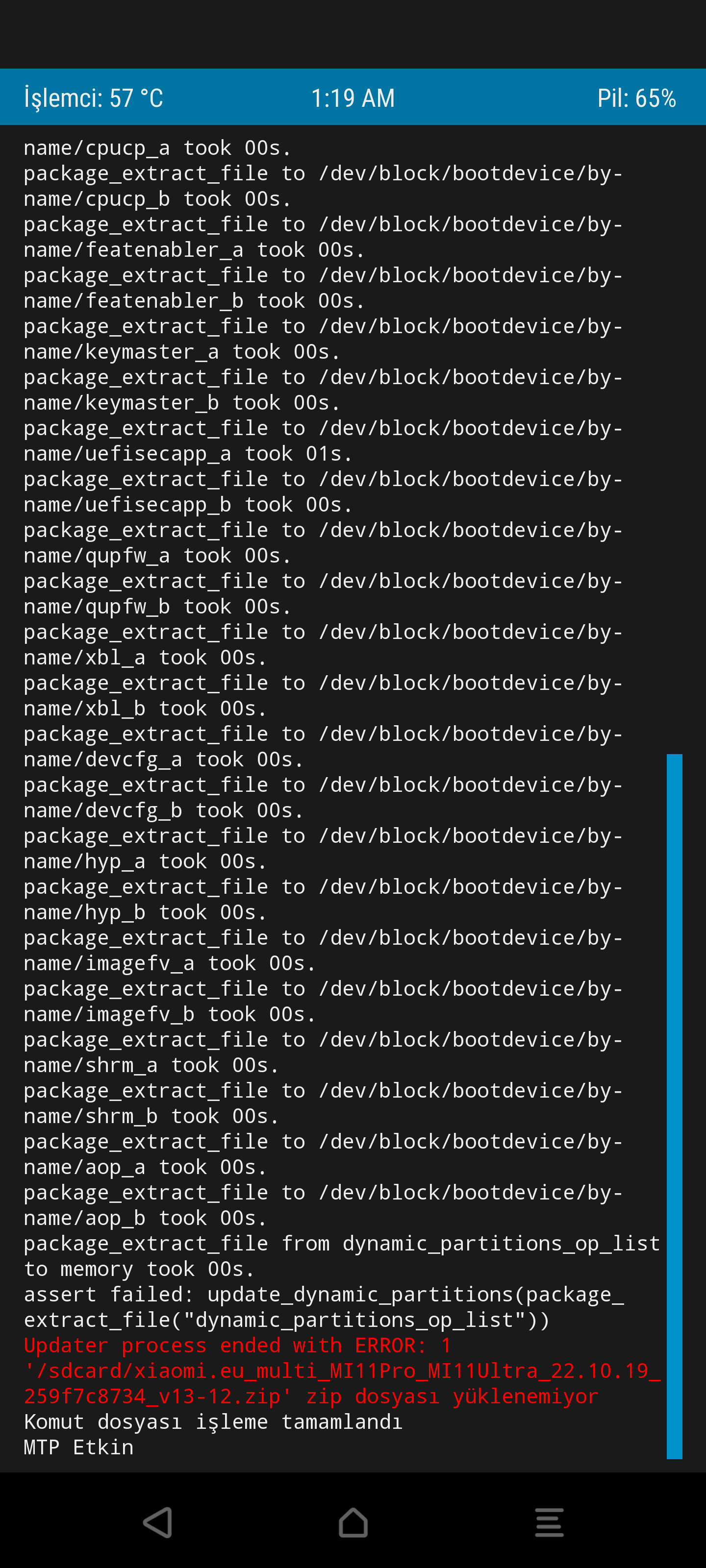

hello, I can't install frimware upgrade twrps, it gives this error, can you help me?
Device mi 11 ultra (star)

look here...
TWRP update shows ERROR: 1 / can not mount system ...
- this error can occur if you try the update with updater app or if you started TWRP manually
- Solution:
-> while you are in TWRP reboot your device in recovery mode
-> try to install the rom again
-> if it will fail, reboot in recovery again
"reboot recovery" means to restart TWRP Recovery from TWRP "Restart - Recovery"
-> or use "fastboot boot twrp.img" again
-> sometimes you need more then one try
-> if it will not work choose another twrp version
or try this: system partition setting RW in the TRWP options
Reactions: gogocar62
