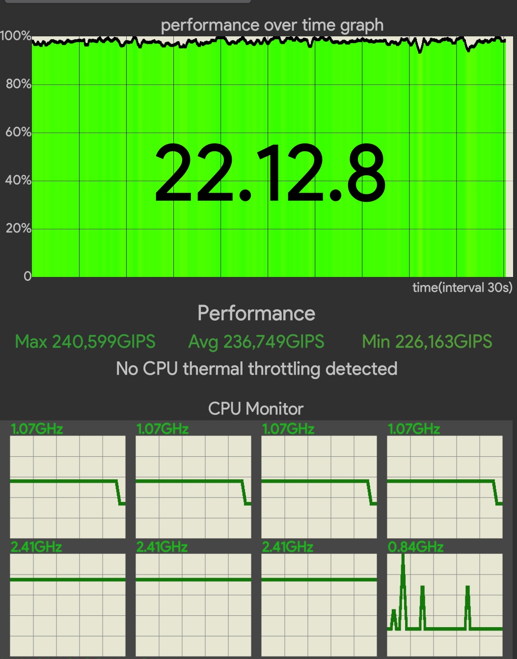

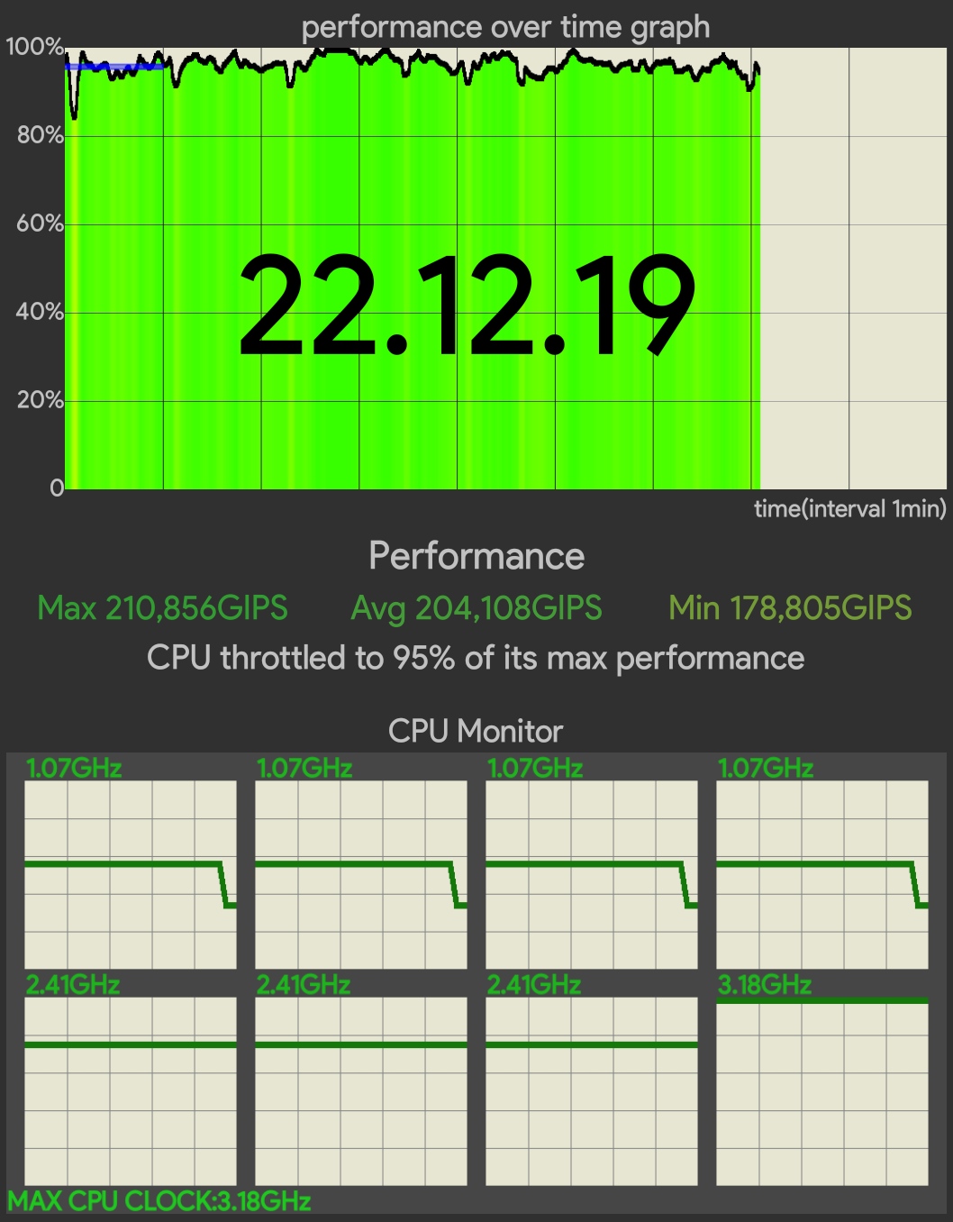

Hello I'm using Poco F3 and it seems it is overheating when playing Genshin in 22.12.19 this is not the case in 22.12.8
If I downgrade to 22.12.18 do I need to reformat my data?

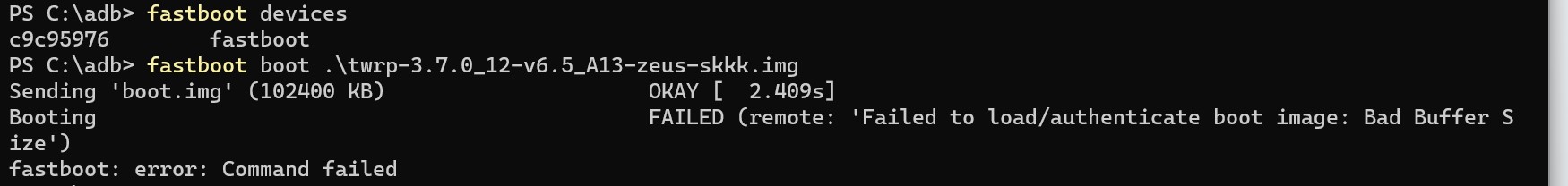

Hallo, So i followed these steps. However I get attached error when trying to install TWRP on step number 8. Any ideas, why this is happening? Device XM 12 Pro, after that got stuck on Fastboot. I had to redo the steps again from 1 to boot into system? Thanks.
Dude unplug the cable and reboot the phone in fastboot mode. And try again. You may need to do this a few times
You are using instructions that are not suitable for your model. Inappropriate fastboot command.

If I first flash it to recovery_ab using your command and then do "fastboot boot twrp.img", it won't boot to twrp and stays in fastboot.
Here is the code from cmd:
Code:
D:\Downloads\xiaomi.eu_multi_XM12Pro_V14.0.22.12.19.DEV_v14-13-fastboot>fastboot flash recovery_ab twrp.img
target reported max download size of 805306368 bytes
sending 'recovery_ab' (102400 KB)...
OKAY [  2.187s]
writing 'recovery_ab'...
(bootloader) Partition recovery_a flashed successfully
(bootloader) Partition recovery_b flashed successfully
OKAY [  0.363s]
finished. total time: 2.559s
D:\Downloads\xiaomi.eu_multi_XM12Pro_V14.0.22.12.19.DEV_v14-13-fastboot>fastboot boot twrp.img
downloading 'boot.img'...
OKAY [  2.168s]
booting...
FAILED (remote: Failed to load/authenticate boot image: Bad Buffer Size)
finished. total time: 2.284s
If I try to boot to recovery using hardware keys, it will still stay in fastboot.
Edit: I need to flash boot.img or patched boot.img to reboot into system
Edit 2: After I rebooted to system, I was sucessfull in booting to TWRP using harware keys
Reactions: katerpanne
