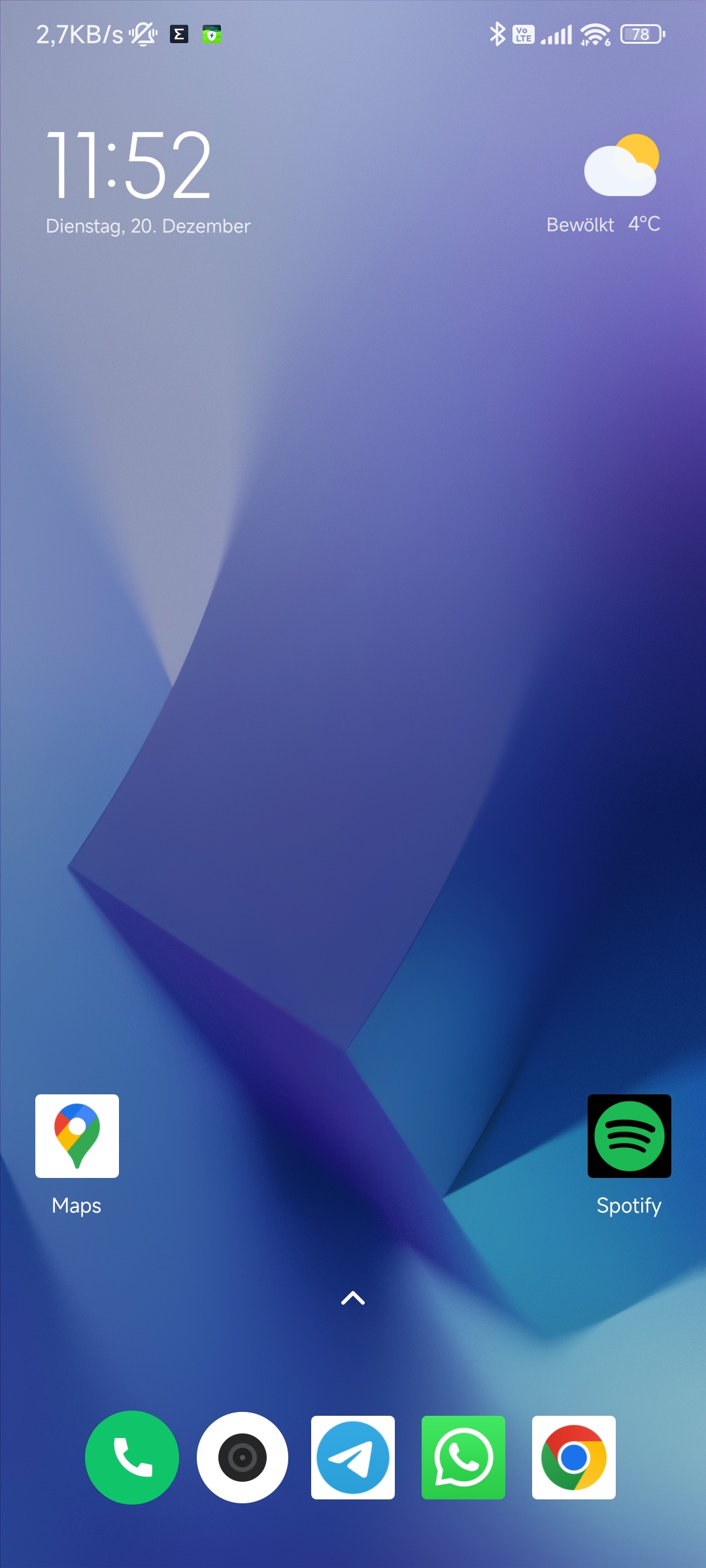

MIUI 14 22.12.8/16
Spaces between the bottom bar and the first icons...
Although it's flawless on Alioth.
Thanks for your work.

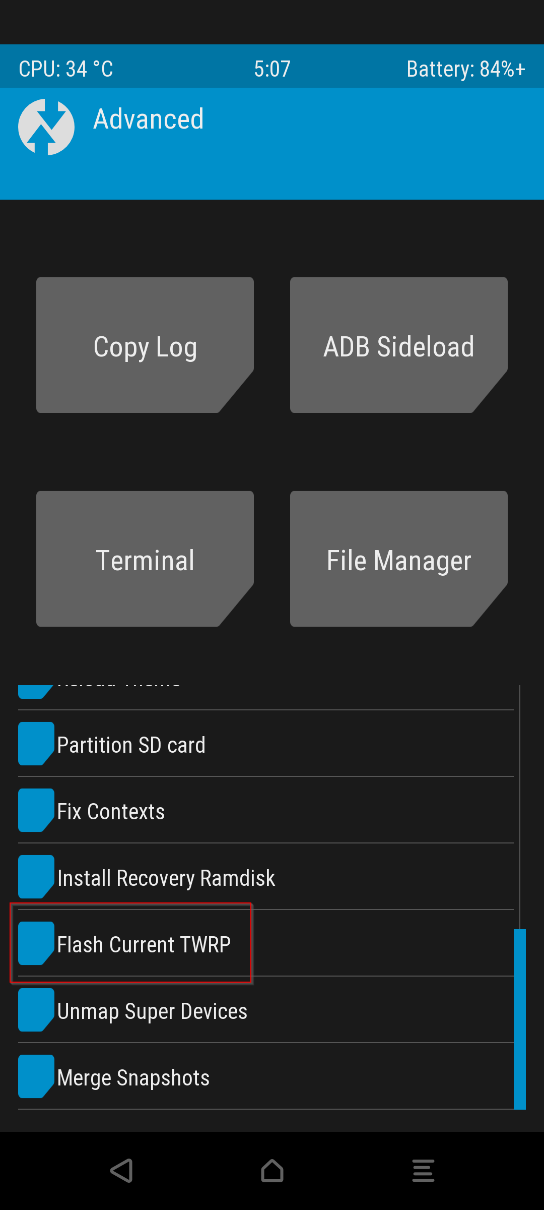

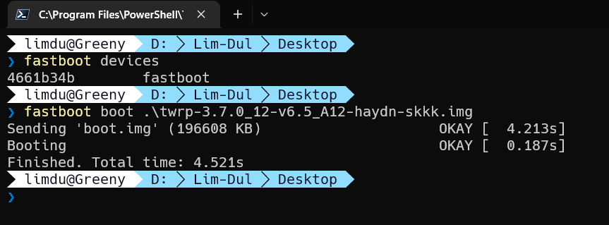

Dirty flashed my Redmi K40 Pro+ from MIUI 13 22.10.26. Flashed TWRP, flashed Magisk 25.2 - everything is working fine, banking apps as well. Didn't check for bugs that were not immediately obvious.
I know this might be pure superstition but when working with fastboot I prefer to only ever do hardware shutdowns / reboots instead of doing stuff like fastboot reboot or rebooting from TWRP. Was burned once or twice by ROMs that bootlooped when soft-rebooting.
So, my procedure, for anyone who is interested (it's SUPER conservative after years of experience with failing at various steps for certain ROMs, especially new ones):
  1. Powered off phone
  2. Entered fastboot via Power Button + Volume Down
  3. Checked phone is detected via
    Code:
    fastboot devices
  4. Flashed ROM via PowerShell with
    Code:
    .\windows_fastboot_update_rom.bat
  5. Waited for reboot - entered system and waited for the update to finish - didn't do anything with the phone yet
  6. Powered off phone
  7. Entered fastboot via Power Button + Volume Down
  8. Booted into TWRP via
    Code:
    fastboot boot twrp-3.7.0_12-v6.5_A12-haydn-skkk.img
  9. Flashed TWRP via Advanced -> Flash current TWRP
  10. Powered off phone
  11. Turned phone on again, waited to get back into system and checked everything is fine
  12. Powered off phone
  13. Entered recovery via Power Button + Volume Up
  14. Installed Magisk-v25.2.apk via TWRP (changed the extension from .apk to .zip, resulting in Magisk-v25.2.zip)
  15. Powered off phone
  16. Turned phone on again - everything is fine as described above
I learned it's better to not rush things when working with Bootloader images. I mean, heck, the initial lack of a recovery ROM kept me from using the phone as a daily driver for like a year. :p

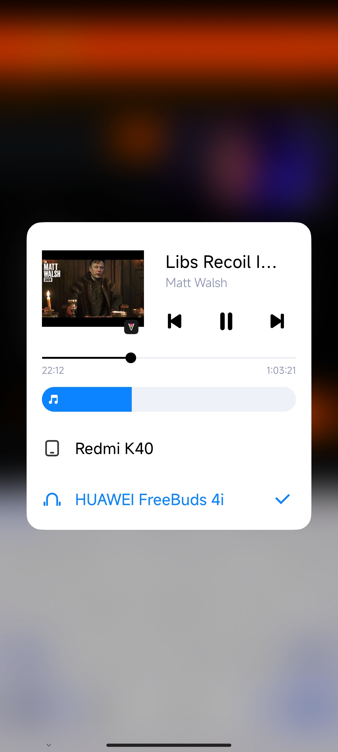

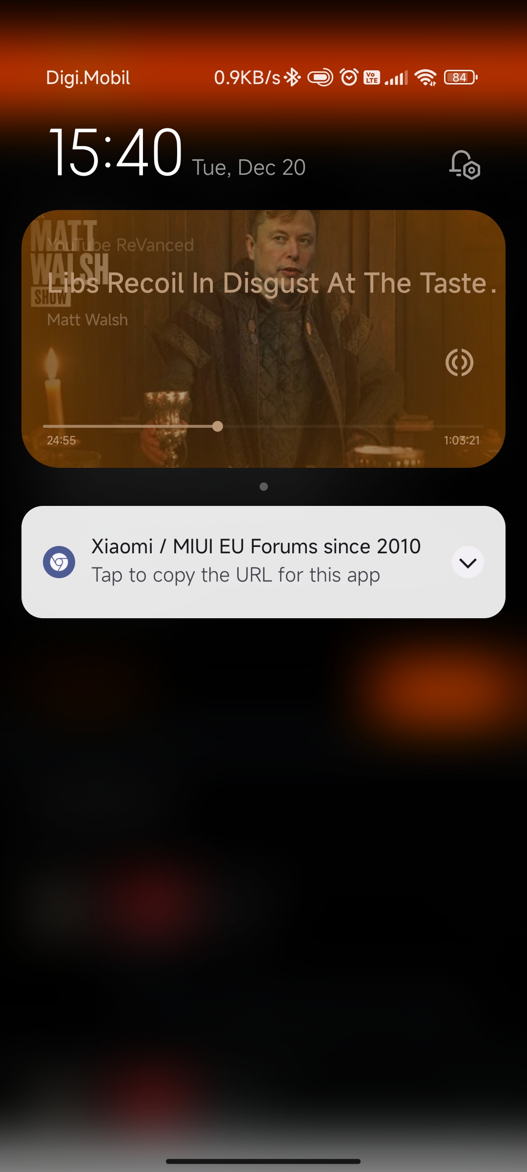

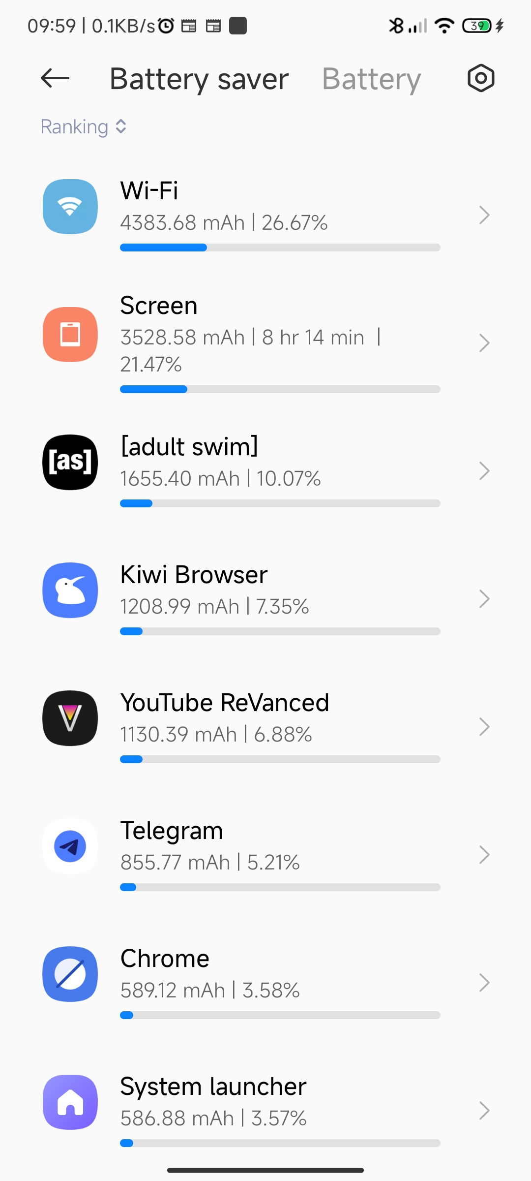

I'm using Poco f3, and I noticed some bugs, here are the ones:
-Wi-fi is consuming the battery quite a lot(picture attached)
-when switching from wireless buds to speaker and vice versa the system crash, and goes straight to lock screen(picture attached)
-the controllers for some media players are missing in the notification shade (picture attached)
The rest is all good, the device is even faster than before! Cheers!

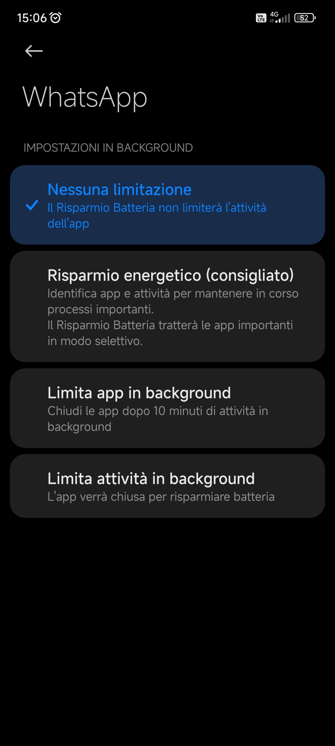

i also try to find a solution because this problem with the notifications is not only on the lock screen. But the problem is not for all apps, only for some apps where the notifications dissapear
I have the issue with miui14. My wife has whatsapp notification issue with the last stock rom that is miui 13 and Android 13. So i think that the problem Is Android 13 and not miui 14. Before update to Android 13 She didnt have the issue

I only noticed that controls only disappear for YouTube
Though huge WiFi consumption is because of mi smart hub
