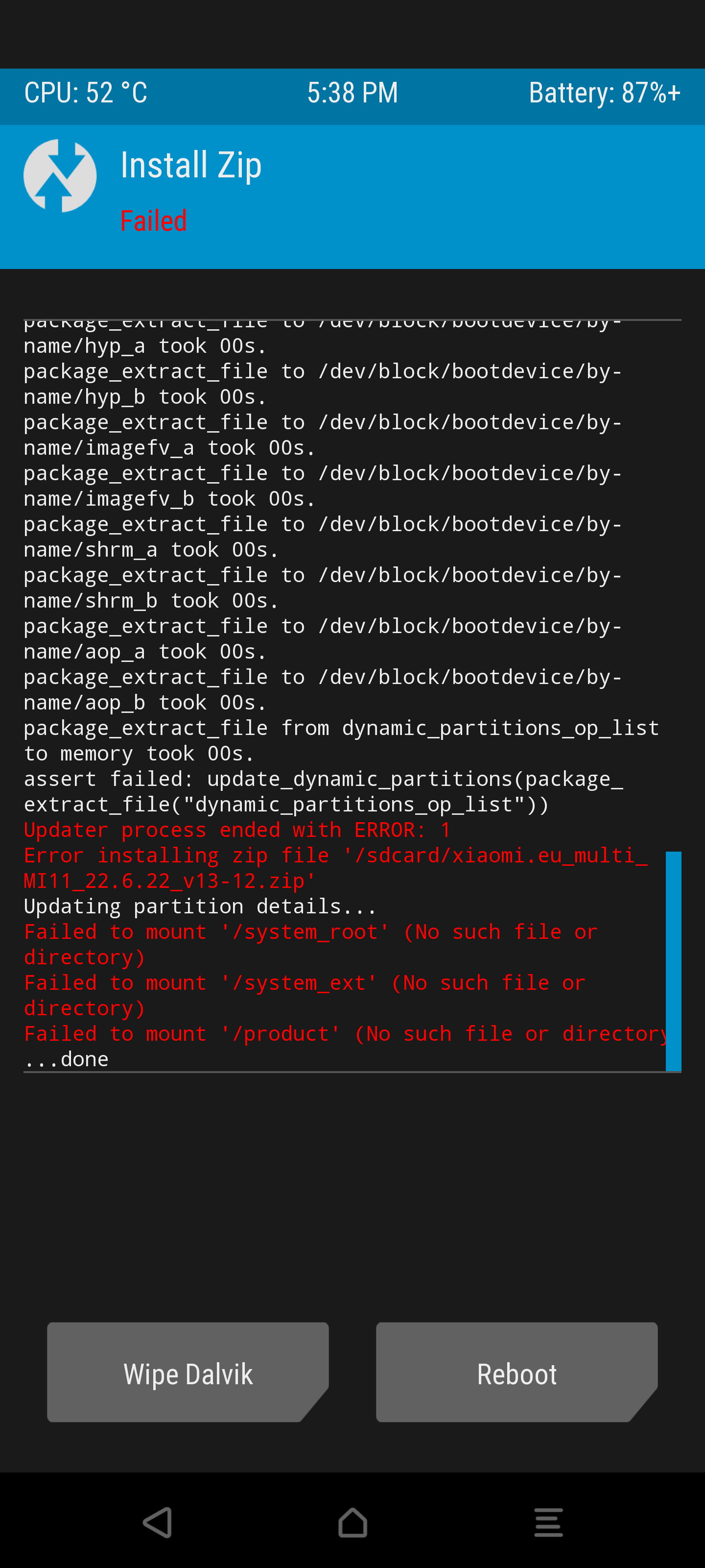

Hello, MI 11 installation of the ROM failed: "assert failed: update_dynamic_partitions (pacckage_extract_file ("dinamic_partitions_op_list")
what does it mean? can i fix this somehow?

I am not able to install the update via twrp on my Mi11 coming from 2022.6.15.
It always shows the following errors:
Reboot to Fastboot again, boot up twrp and it will work, as test, see if you can mount system prior flash.
