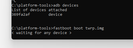

From windows 11 am getting waiting for any device
This is what am doing.I have enable dub debugging and am connecting the phone on the pc. The phone is booted on working state not in fastboot e.t.c

Instructions for A/B equipment ( All devices before Mi 11 era (except Mi 10S, Redmi Note 10 Pro Global iirc) are non-AB).
Updates via TWRP:
- Insert the ROM into the phone.
1. Download TWRP to PC and rename it to twrp.img https://dl.akr-developers.com/?dir=skkk/TWRP/A12/v3.7_A12
2. Run TWRP fastboot command
Code:
fastboot boot twrp.img
3. Install ROM
4. Reboot system
