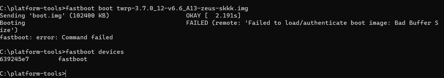

You cannot use "fastboot boot twrp.img" command on your device.
Ingest the command :

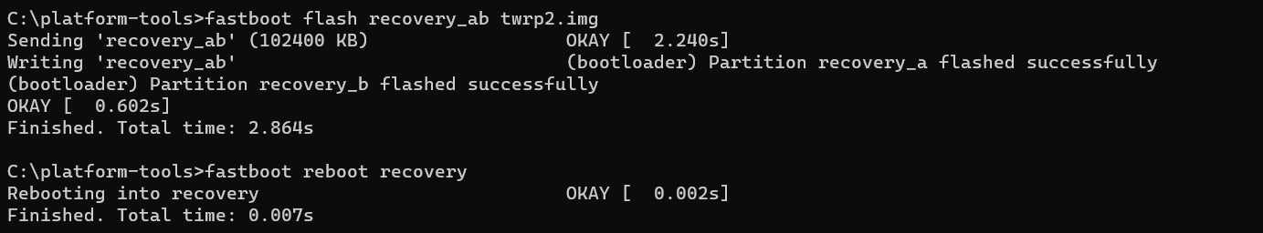

fastboot flash recovery_ab twrp.img
and subsequently:
fastboot reboot recovery
Okay did that installed but its still loading right up into fastboot when it reboots
Or boot into TWRP by pressing the key combination.
Sadly its going right into fastboot, I'm so confused it doesn't show mi logo are anything, just straight to fastboot, volume up power, nothing volume down pwer nothing

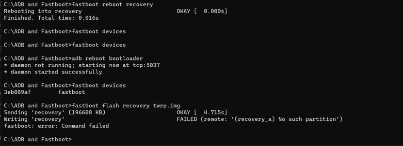

I have the Xiaomi 12T Pro. I just got the prompt for the new update and everything was going fine until I tried to flash the twrp file and I keep getting this error. I am also stuck in fastboot loop so i cant boot back to normal. so I am guessing I can either fix the problem and boot twrp or I have to do a fresh install or my ROM.
