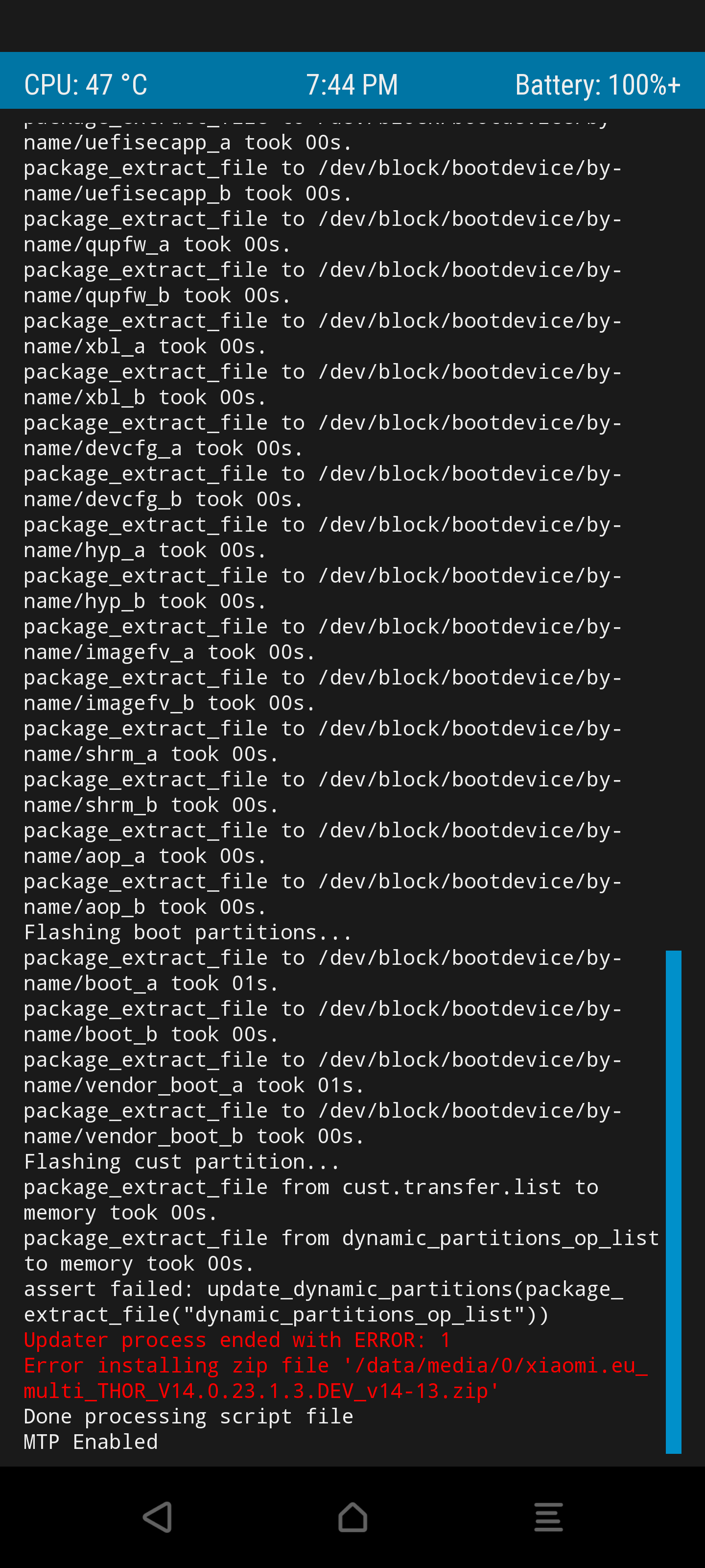

Error happened. Did as told to reboot TWRP and try reinstalling again. Did it multiple times but same results on Thor. Any other 12s ultra people facing the same issue?
still not enough.. sometime it takes more than 10x try to pass this TWRP error.. so reboot to TWRP again and try again..

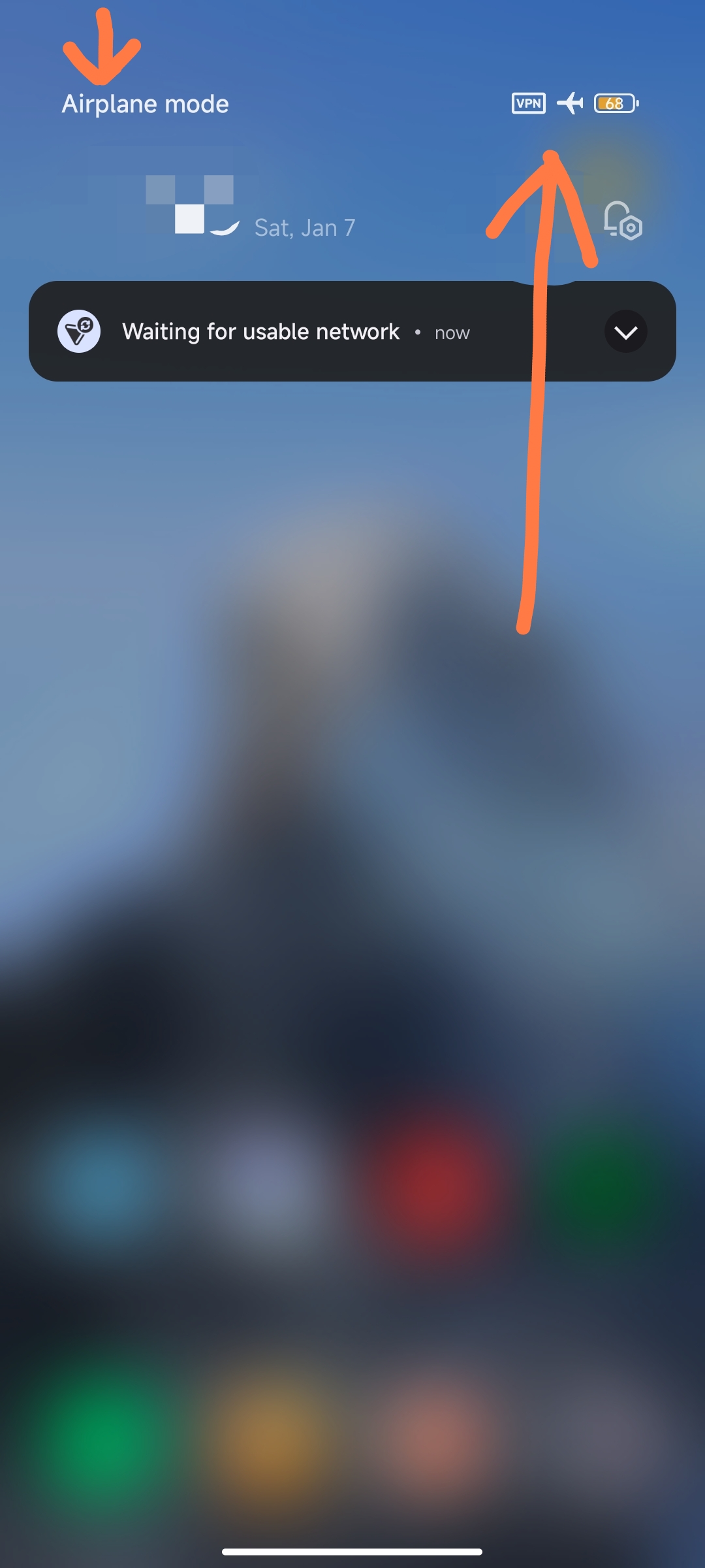

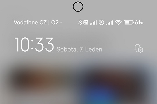

I believe the status bar icons in control center have been pushed down on the latest build
Poco F3

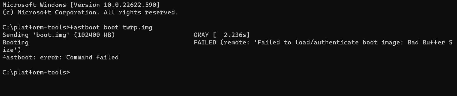

I have POCO F3. When trying to install twrp-3.7.0_12-v6.6_A13-alioth-skkk.img I get this error:
Sending 'recovery' (196608 KB) OKAY [ 4.281s]
Writing 'recovery' FAILED (remote: '(recovery_a) No such partition')
fastboot: error: Command failed
Am I doing something wrong? What should I do?
Poco F3
This is so that all icons can be displayed when the camera prevents it.
You need to use fastboot boot twrp.img command on Poco F3
