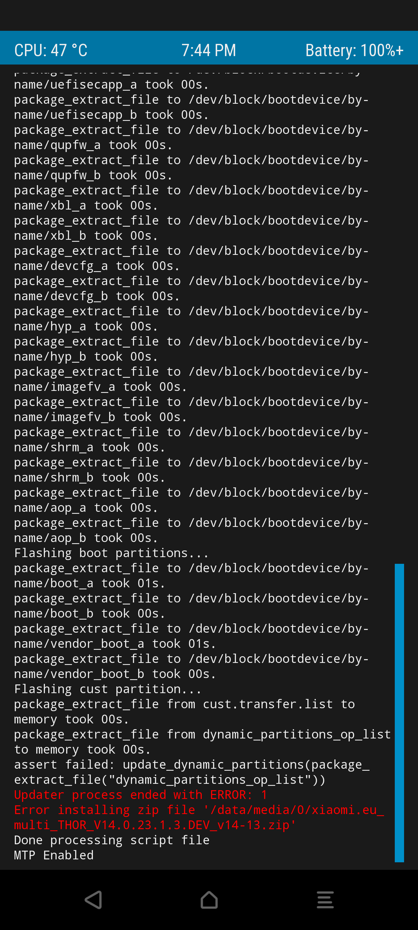

If you will see this error in TWRP during ROM install, just reboot to TWRP again and try again (it is TWRP issue since A12)
Trying to update on thor but getting this error. Have followed instructions and rebooted to TWRP a few times with same outcome. How should i proceed?

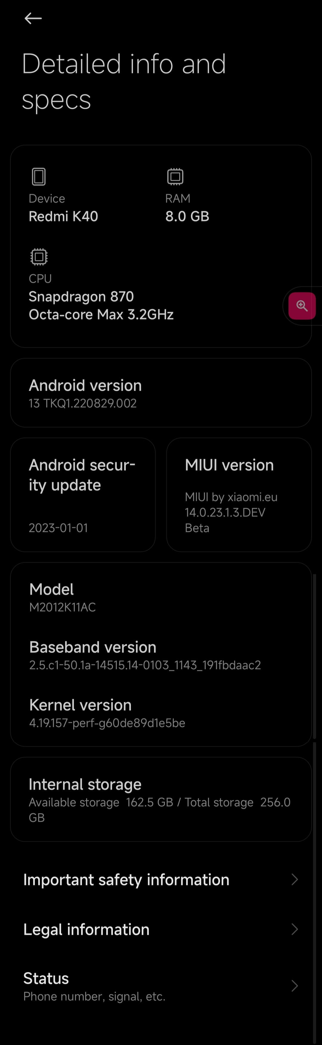

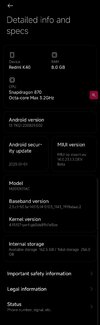

The new MIUl by xiaomi.eu 14.0.23.1.3.DEV Beta (Recovery) updated flawless on Poco F3 using TWRP v6.6 A13 by SKKK
Thanks Dev Team,

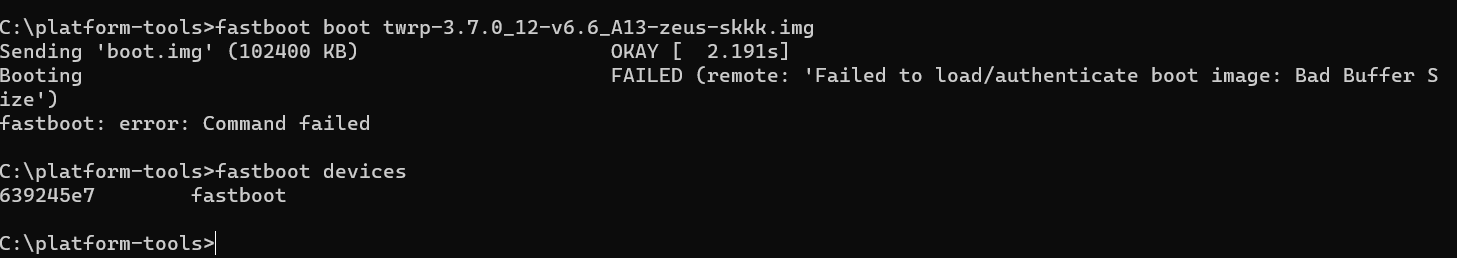

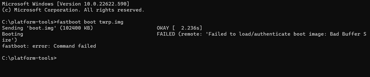

I keep getting this error whenever I try to install A13 ZEUS TWRP on my phone ‍♂️
Phone: Xiaomi 12 pro

You don't have to be afraid my friend. Type the fastboot devices command. Then type fastboot boot twrp (whatever it's called).img
