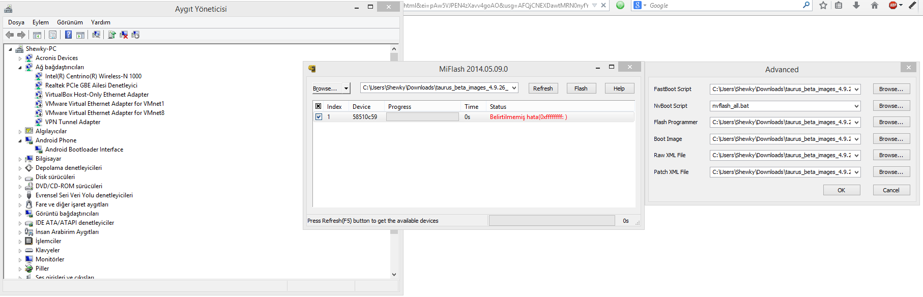

I can't flash with Miflash my Mi2 :( Can anyone help me ? :(

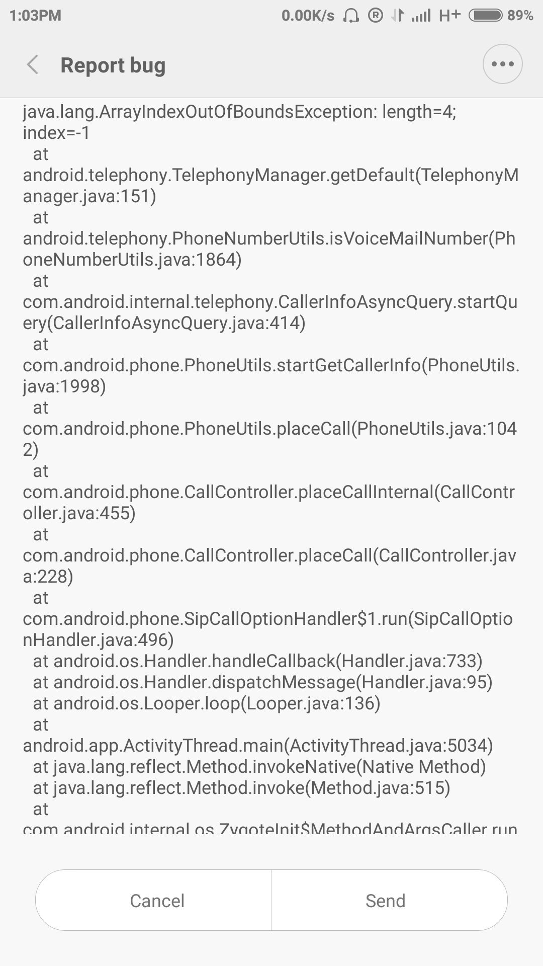

Unable to call using IP dialing feature on the dialer on mi3w. I get a acore.phone force close.
But the call gets transmitted to the other person I'm calling. They get it as a missed call and i won't even know that call has been transmitted because of the force close.

post a log...
did you unpack .tgz file..?
Yes, and I have selected files in rom folder.
Here is log file from Miflash
Code:
[000010E8]CreateManagedObject(1261): Belirtilmemiş hata(0x80131604)
[000010E8]GetFactoryObject(1305): Belirtilmemiş hata(0x80131604)
[000010E8]GetFactoryObject(1326): Belirtilen hizmet yok.(0x800704db)
[000010E8]GetSearchPath(1381): Belirtilen hizmet yok.(0x800704db)
[00000E98]58510c59    0.00    execute C:\Users\Shewky\Downloads\taurus_beta_images_4.9.26_4.4_cn\flash_all.bat
[00000E98]58510c59    0.06
[00000E98]58510c59    0.06    $fastboot -s 58510c59 getvar soc-id  2>&1  | findstr /r /c:"^soc-id: *140"  || echo Missmatching image and device
[00000E98]58510c59    0.13    Missmatching image and device
[00000E98]58510c59    0.13    $fastboot -s 58510c59 getvar soc-id  2>&1  | findstr /r /c:"^soc-id: *140"  || exit /B 1
[00000E98]58510c59    0.19
[00000E98]CScriptReport::DoWork(418): Belirtilmemiş hata(0xffffffff)
[00000E98]GetFactoryObject(1326): Belirtilen hizmet yok.(0x800704db)
[00000E98]SaveFlashResult(1347): Belirtilen hizmet yok.(0x800704db)
How can I fix this :( My drivers are updated but still getting same error

"Missmatching image and device"
you have Mi2A..?

Is anyone facing the android-acore force close issue when using IP dial feature from stock phone dialer?
I have posted this bug already with a screenshot, but no one acknowledged.. So asking again... Is it a known issue which will not be rectified? Or am i the only one having this problem?
