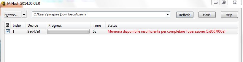

I've flashed via updater two times and nownow no more internal storage in my mi2s. I can't even download or take a picture, what happened? What I have to do?

Need help!!!
Update to this latest weekly this afternoon and now my Redmi Note 2 Prime keeps restarting by itself. When I turn it on and a few minutes later it will restart and keep going on and on!!! How do i fix this? PLEASE HELP!!
