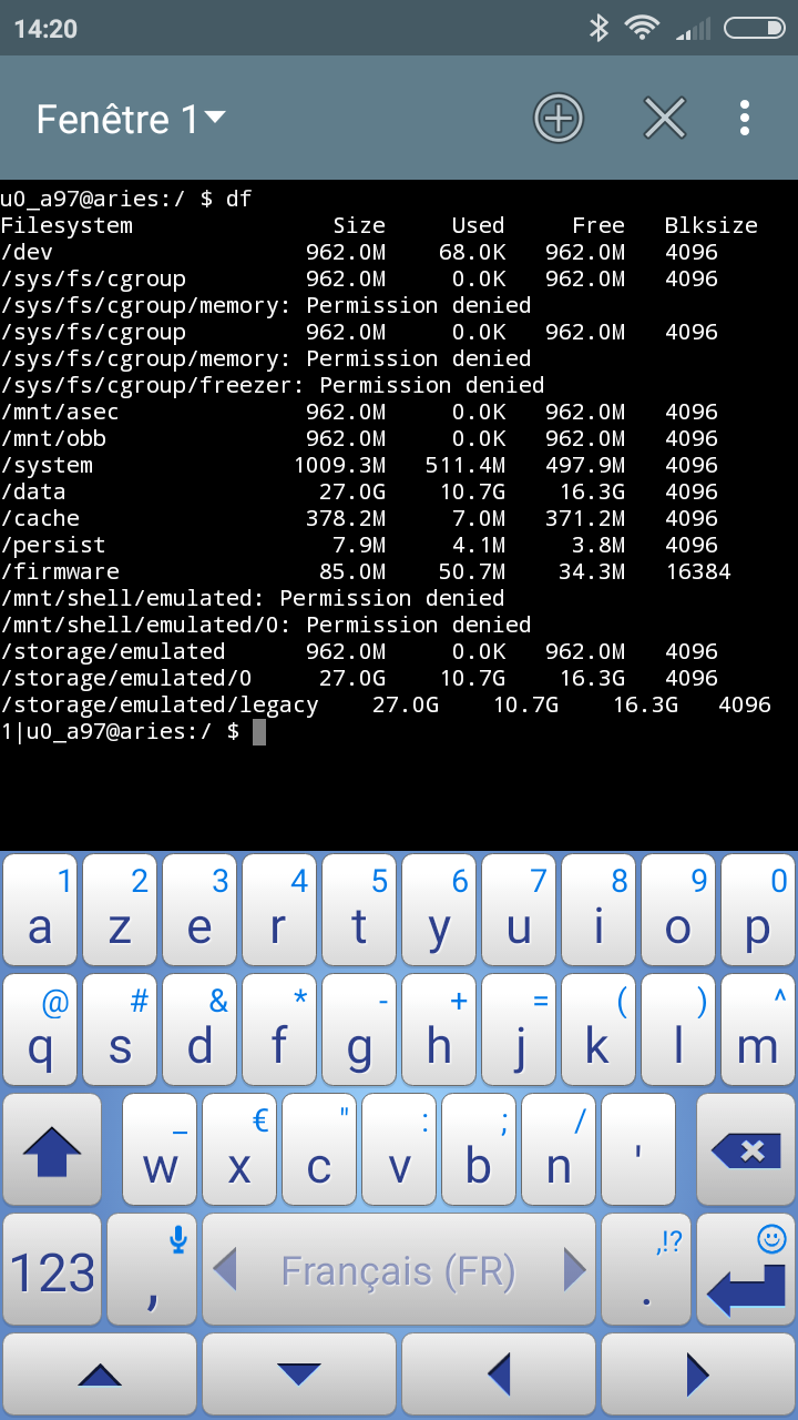

Hello, I use Mi2 and I think my partitions are merged since my installation of Android5.02
I use miui7 5.11.19 and as requested I have installed a second time.. It was very fast..
But when I use to command I don't found same result of 1009,3 Mb but 960 see attached screen shot. What shall I do? install 5.11.26?

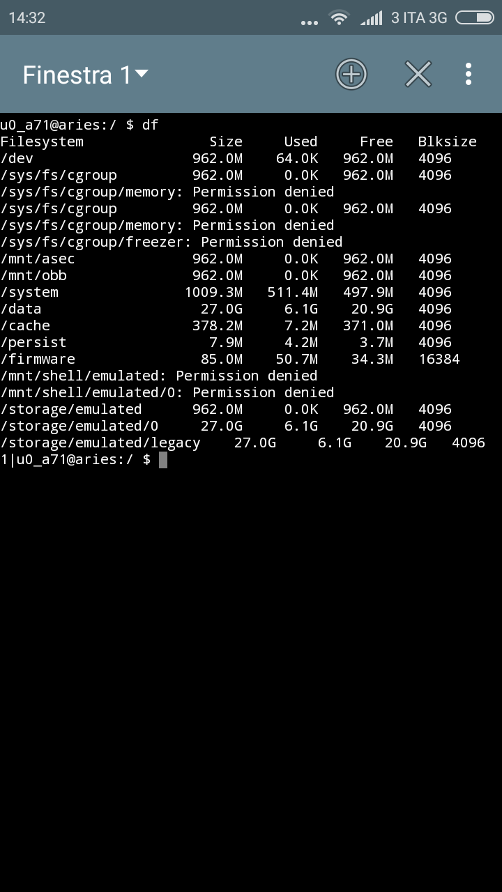

Better flash 5.11.20 china fastboot and then multi via updater, many users lost internal storage via double update ( not all ).merged systems and data screenshot follow
look at the system row, it says 1009,3
It's all correct
based on your screenshot you have merged systems (1009,3MB) and merged data (27GB). You can install 11.26 via updater app without issues
I don't know why you are talking about 960MB. Check your screenshot again! That is 1009,3MB. It is perfect.

Oups I was not looking the good line yes NOW I see.
Merci I will DL and install new version best regards
