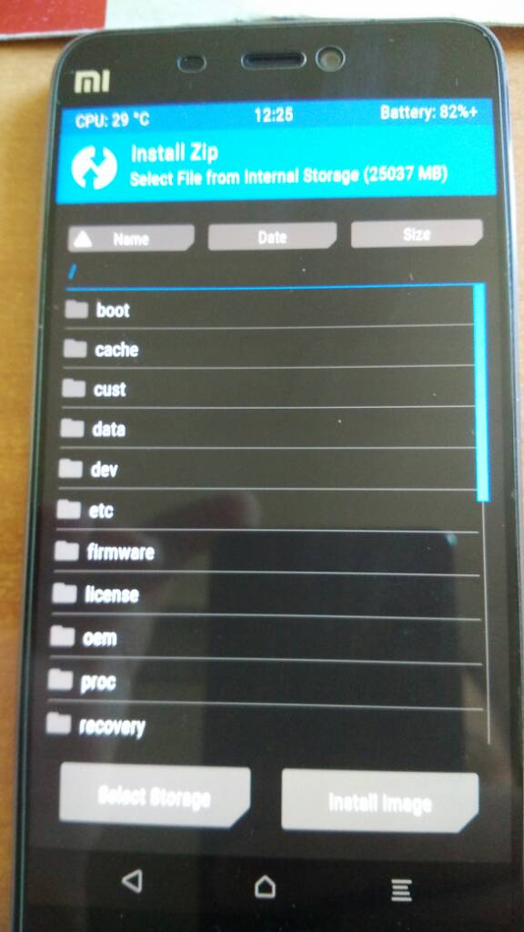

So after i have done the format data in the wipe data when i click install i get this list and don't find the files.
