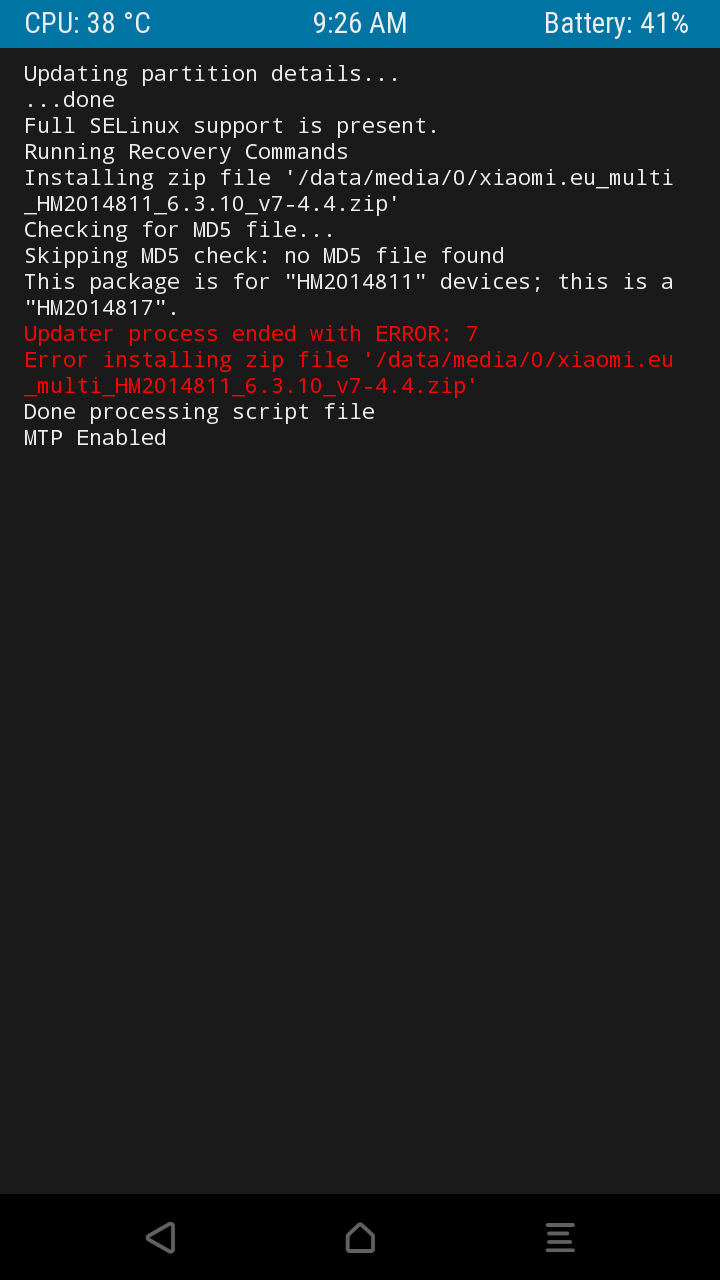

i have a problem to flash the new rom 6.3.10
when i flash with twrp i have this error
that i need to do ?
thnx :)
that i need to do ?
thnx :)
I think I've read in the last rom's thread that users with 2014817 could no longer update with package 2014811, because TWRP could distinguish their devices and does not allow it;
And because here they don't make ROMs for that version, you are unable to use ROMs from here, from now on.

Virgo reuploaded, please try now again... Xiaomi locked bootloader on MiNote without any warning...
So we had to "fix it"...

I updated twrp and disabled signature verification. Update 6 3 10 done fine on redmi2 2014813
