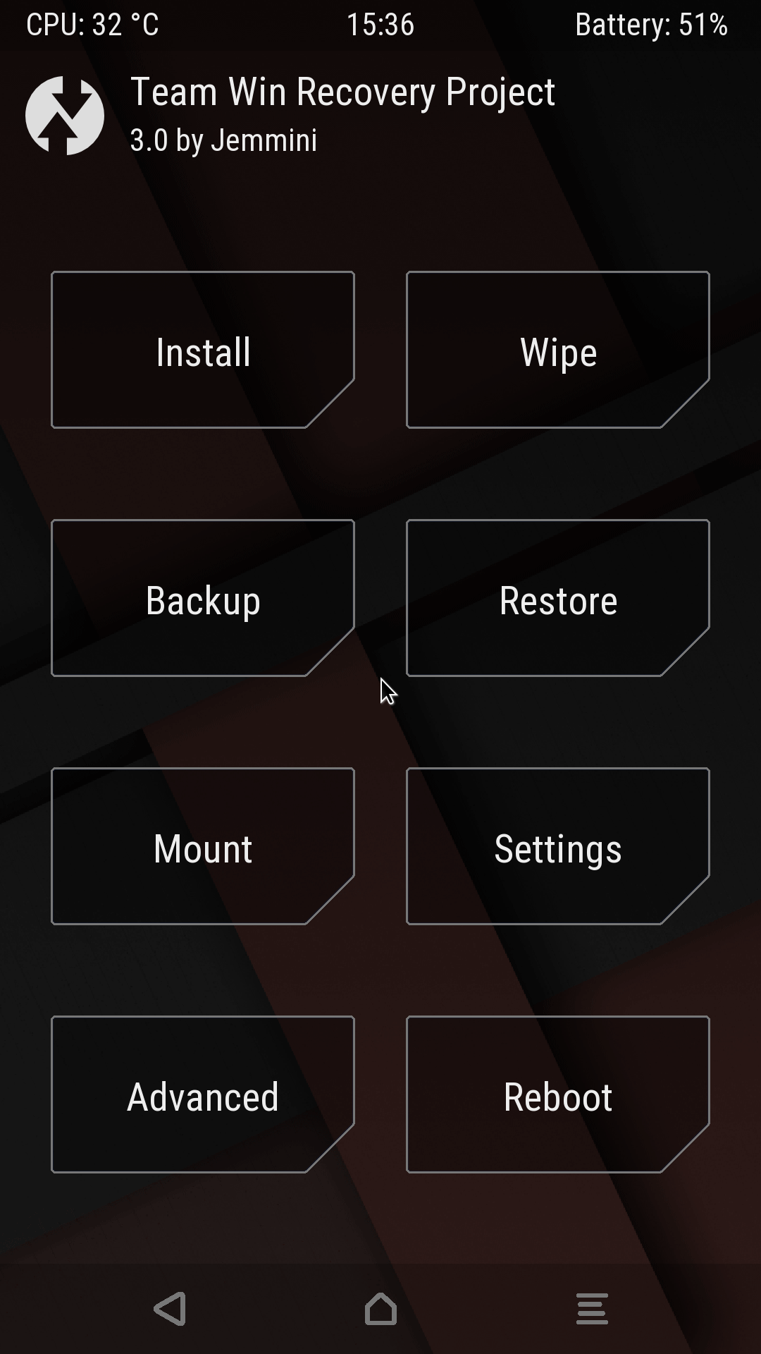

i have touch problems with cofface_twrp_recovery_gemini-20160408.img version
TWRP by jemmini works for me
https://drive.google.com/open?id=0B0XXQYHSxGEwam9DcmI2UWNtbEE
so yo need test which version will work
