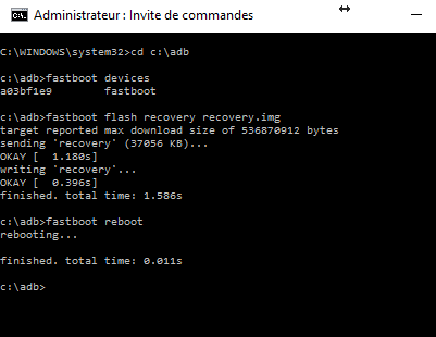

Yes, thanks a lot graw2, I found my last wek mistake I didn't use the good command
Last week I use fastboot boot recovery.img then it worked once..
Now I have used fastboot flash recovery recovery.img then I will not disturb you next week
Process: twrp.img file renamed recovery.img and using ADB:
Now I install version 6.9.1
