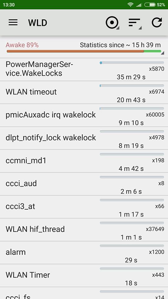

I rooted my Redmi Pro so i can check with WLD what is "destroying" my battery...
Here is one screenshot of WLD...
Also, some other "drainers" are...

This is when we talk about kernel wake up...
And when i check CPU wake up...
- Google play services x 5230
- Android system x 1400
And wake up triggers
- Xiaomi services x 190 times
- Facebook x 206 times
But, here on this screenshot above must be the problem...
Help please...

For kernel wakelocks can't give any advice because most of this shown isn't known to me, but from so much wakelocks it could be issue in Kernel also.
From rest only obvious thing is that your device won't go into deep sleep because either some xiaomi or Google services are keeping device awake, could be that some of them don't work properly or it's too much works to be done. Btw xiaomi service framework and google play service isn't im most cases source of problem but other services and apps which used them.
Do this:
Wipe all except system.
Redownload rom, reflash.
As i wrote in previous thread, when setting up don't login into xiaomi and don't use any backup service as local or xiaomi cloud. Login into Google account, go to settings check and disable Google services which you dont use as Google fit etc.
Don't use Google launcher or Google Now just for testing batery purposes.
Disable Google locations completely not just gps.
Use for a day and check how your battery behave.
If you are satisfied, do restore files or enable xiaomi services which you wanna use.
Now you can have good reference point about your battery consumption.
Good alternative for wakelock detector is better battery stats Xda edition(that version is as payed one but free), it's show stats much clearer.
If you wish what processes are working constantly and gives you more clear picture, you can try Simple system monitor from Google Playstore. Select "active processes" tab.
