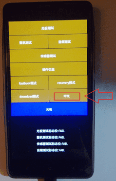

I can't enter TWRP from Icon and with VOLUME+ + POWER (Xiaomi Redmi 3 PRO). The problem is since previous update. I can enter TWRP, if I install it again. But the next time I want restart in Recovery, it doesn't show the recovvery screen. This is the screen I see. What can I do?
The button above the red square says recovery in English. Did you try to click that?
Tap button "recovery" with this chinese marks

Yes, I click on the button that says recovery, but the phone do a normal restart.
You should enter twrp with volume+ + volume- + power (all 3 buttons press and hold). Try it
What I remember is that you can change the language; I had found a YouTube film for redmi4x but it should be the same.
It was something like this: click the button inside the red square and than in right upper corner you have language selection dropdown.
