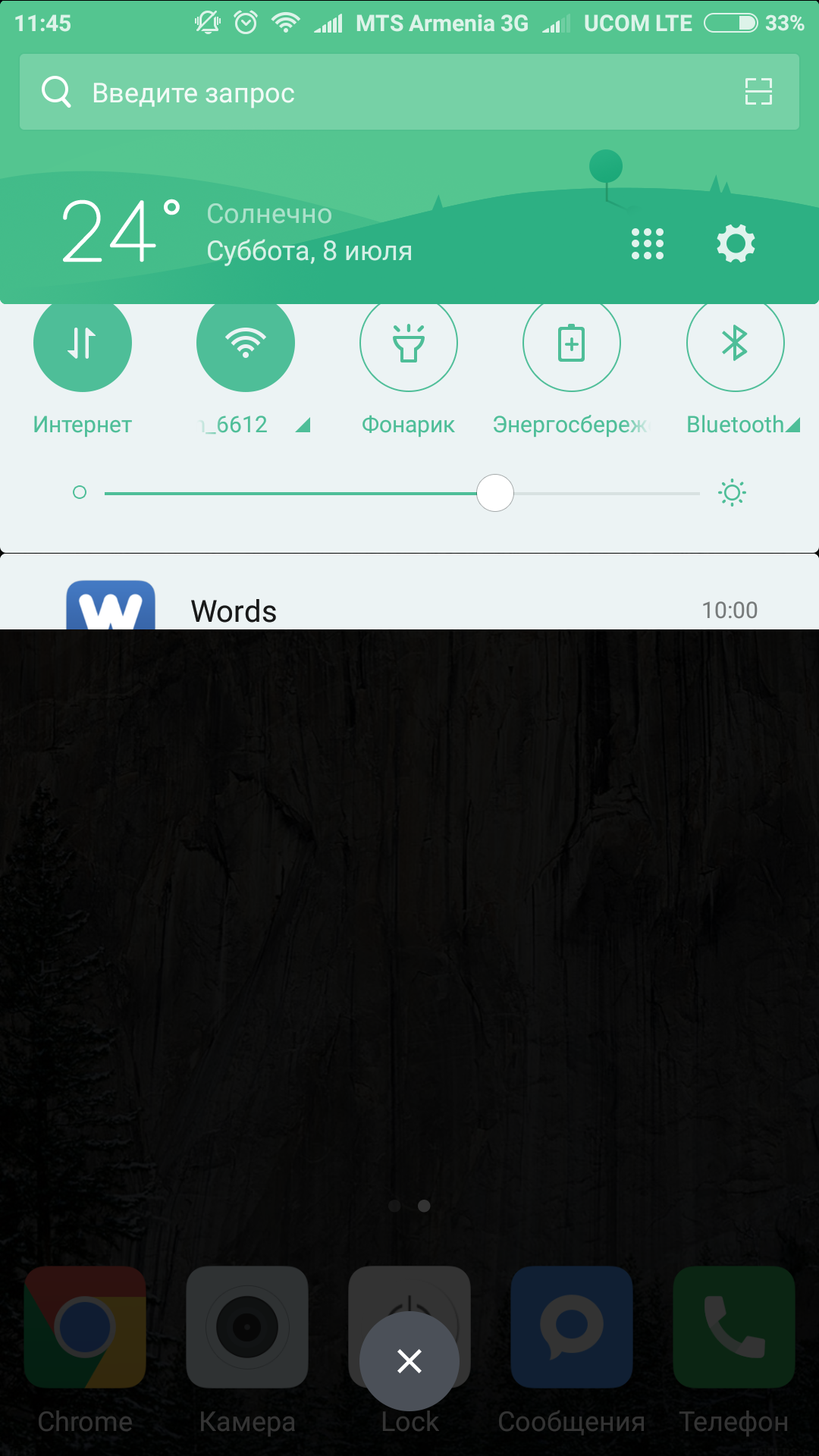

the problem with a shutter, it doesn't open fully.
Xiaomi mi5s

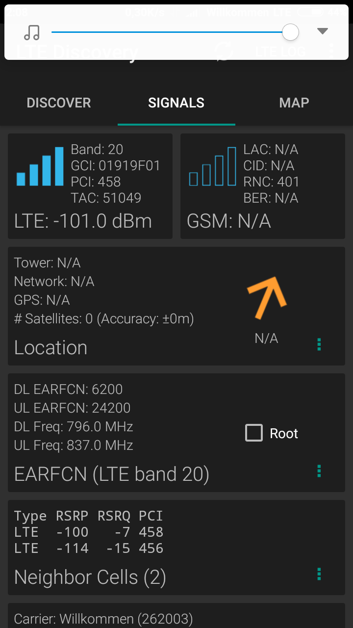

Dear developers, this weekly rom on HM4X (Santoni) global version still lost band20! Same as a week ago, again have to downgrade to android 6.0 version! Hope you'll update in next week, else seemed to work ok (auto brightness seemed a bit improved). Thanks
@mrHmrH With which app do you check that band 20 works? Thanks
I have a Redmi 4X global version (3/32 GB) and can confirm that LTE Band 20 is working with the current ROM. Regarding your previous post your device should be a Redmi 4X 2/16 GB. Are you absolutely sure that Xiaomi did release a global version Redmi 4X with "only" 2/16 GB and LTE Band 20 ? Maybe your finding may be due to a long time existing odd behaviour of previous ROMs that did show 4G on the display while actually being on GSM only as long as WLAN is activated (I am not sure many know/knew this).

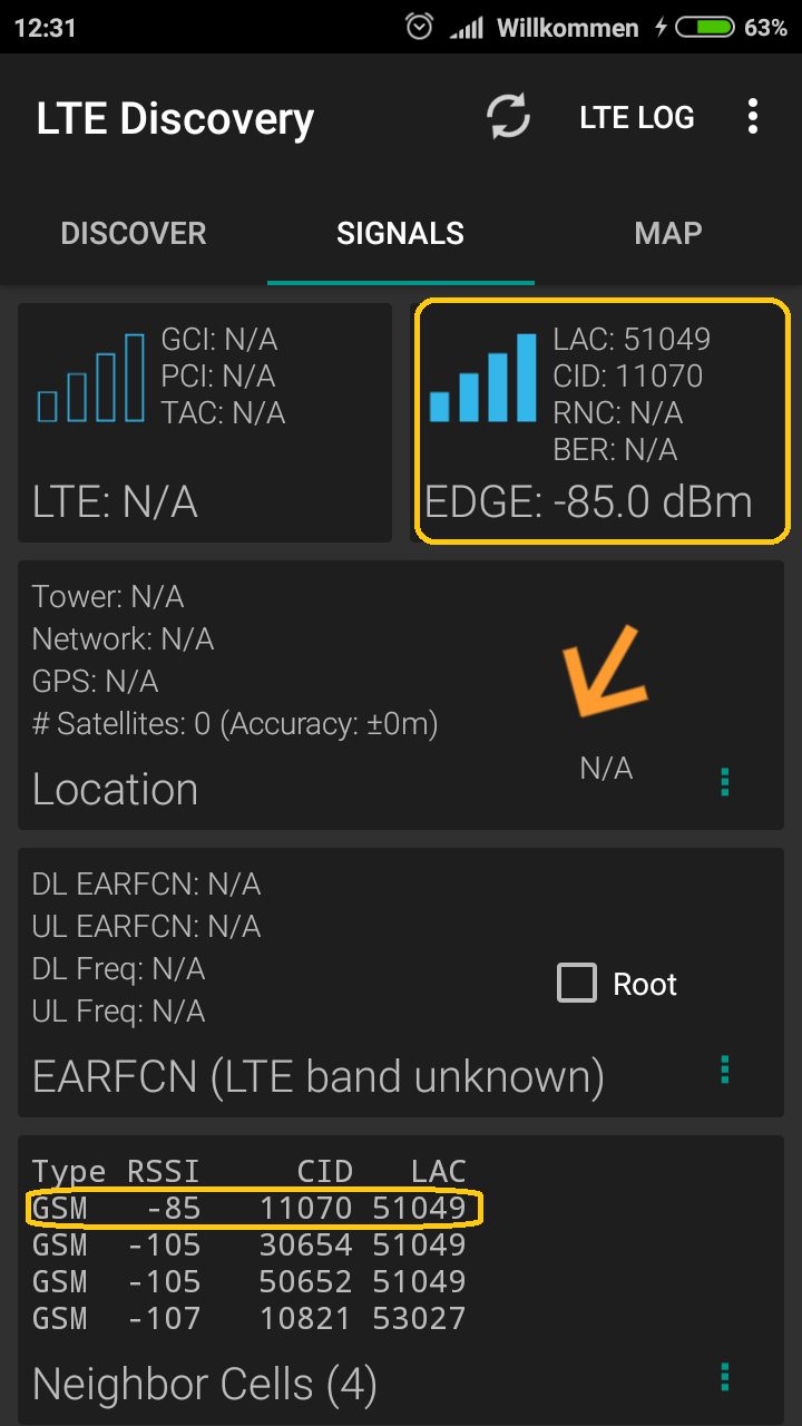

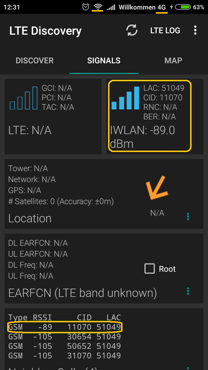

@llion
I used the app LTE discovery (was just part of the screenshot). Attached is the (almost) complete screenshot of a Redmi 4X 3/32 GB global version with the current xiaomi.eu dev ROM and also two screenshots of a second phone (Redmi 4X 3/32 GB global version) with MIUI 8.2 global stable (8.2.9, Android 6.0) installed showing 4G symbol while still on GSM only with WLAN activated.
