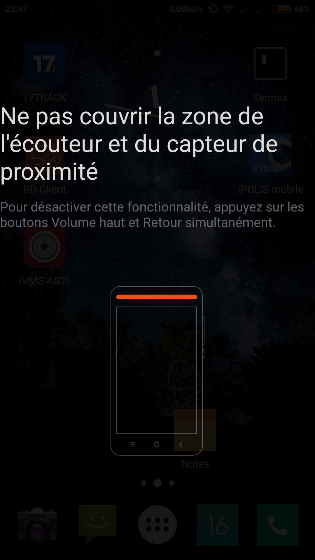

Updated MI5 from 8.1.25 to 8.3.2 Oreo and i have an issue with proximity sensor
- when i want to unlock as soon as i touch the screen I have a message " Do not cover proximity sensor area" and I have to press Vol+ & Back,
being able to enter my pin code
- If I made a phone call, screen turrn black, same thing if I answer a phone call
If someone know how to deactivate that sensor ? or another idea ?
I think flash back a Nougat rom is not possible... or is it ?
Edit: I don't have anything in front of that sensor of course, neither my fingers or a protective screen :)
I am having the same problem after Oreo update.
Calibrating sensor in cit settings solves the issue up until next reboot where the proximity sensor values revert to default.
Updated from nougat with a clean install (wipe everything).
Thanks for the Oreo rom
PS: To deactivate, i believe the setting is "pocket mode" in lockscreen advanced settings

Thanks Nexusslcd !!Removing the pocket only solved the unlock problem, but the screen was still black during calls.
Calibration in CIT made it - no more unlock trouble nor black screen during calls nor unlocking issues... until next reboot or next update.
