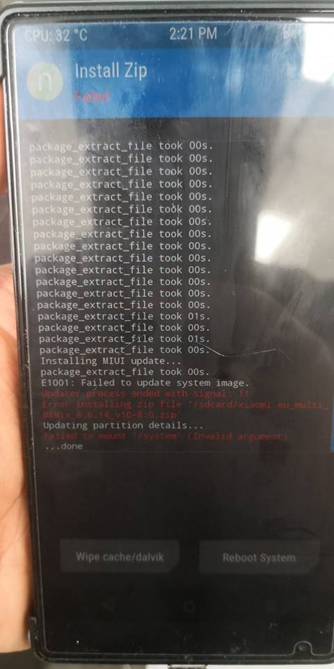

I recomend you to download rom again!
And dont edit the files because they are correctly made! And you can end brick8ng your device.
Update twrp for the latest version 3.2.1.0
I foolow you say to redownload the rom and use the twrp 3.2.1 and solve the error 7 but now have error 11
I foolow you say to redownload the rom and use the twrp 3.2.1 and solve the error 7 but now have error 11View attachment 18912
You have to format data typing yes, i recomend make a backup of your pictures music....
And not format system......
You can try too format data by taping yes and then format system, wipe factory reset and then try install miui 10
If that not solve you need to flash rom 9.6 by miflashtool -> flash recovery twrp by adb -> format data type yes -> wipe factory reset -> install miui 10
