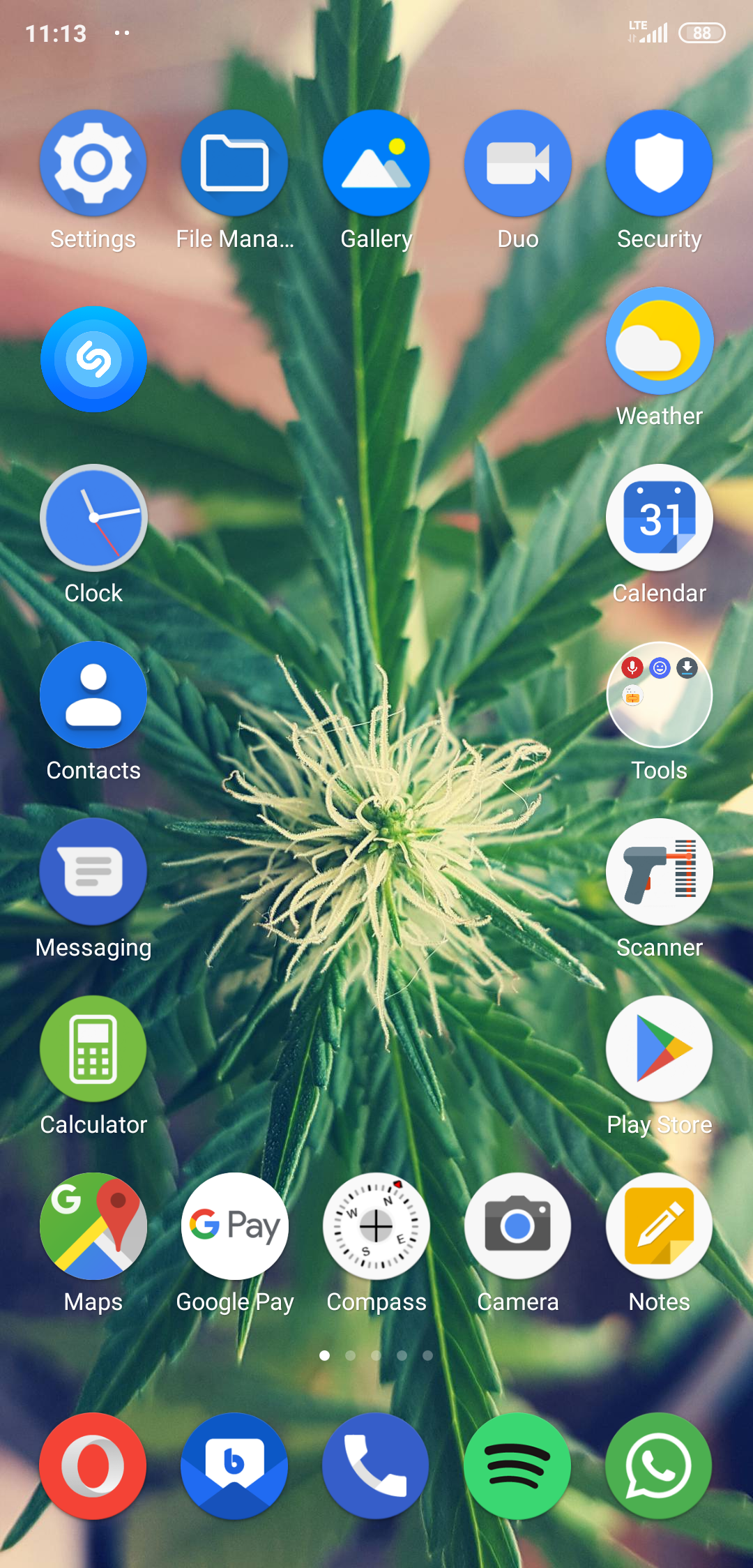

There are dots next to time. There sometimes 2 dots sometimes three dots. And its killing me not knowing what that is. Can somebody tell me?

Son notificaciones que no encajan con puntos.

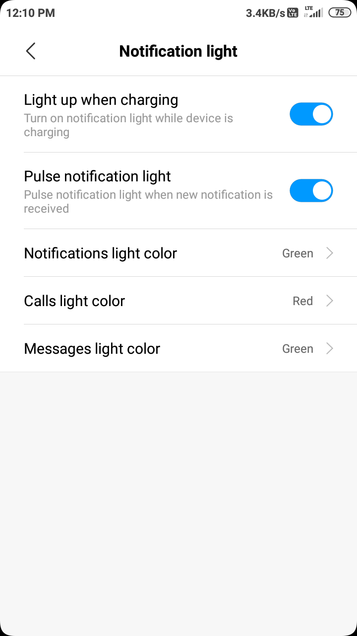

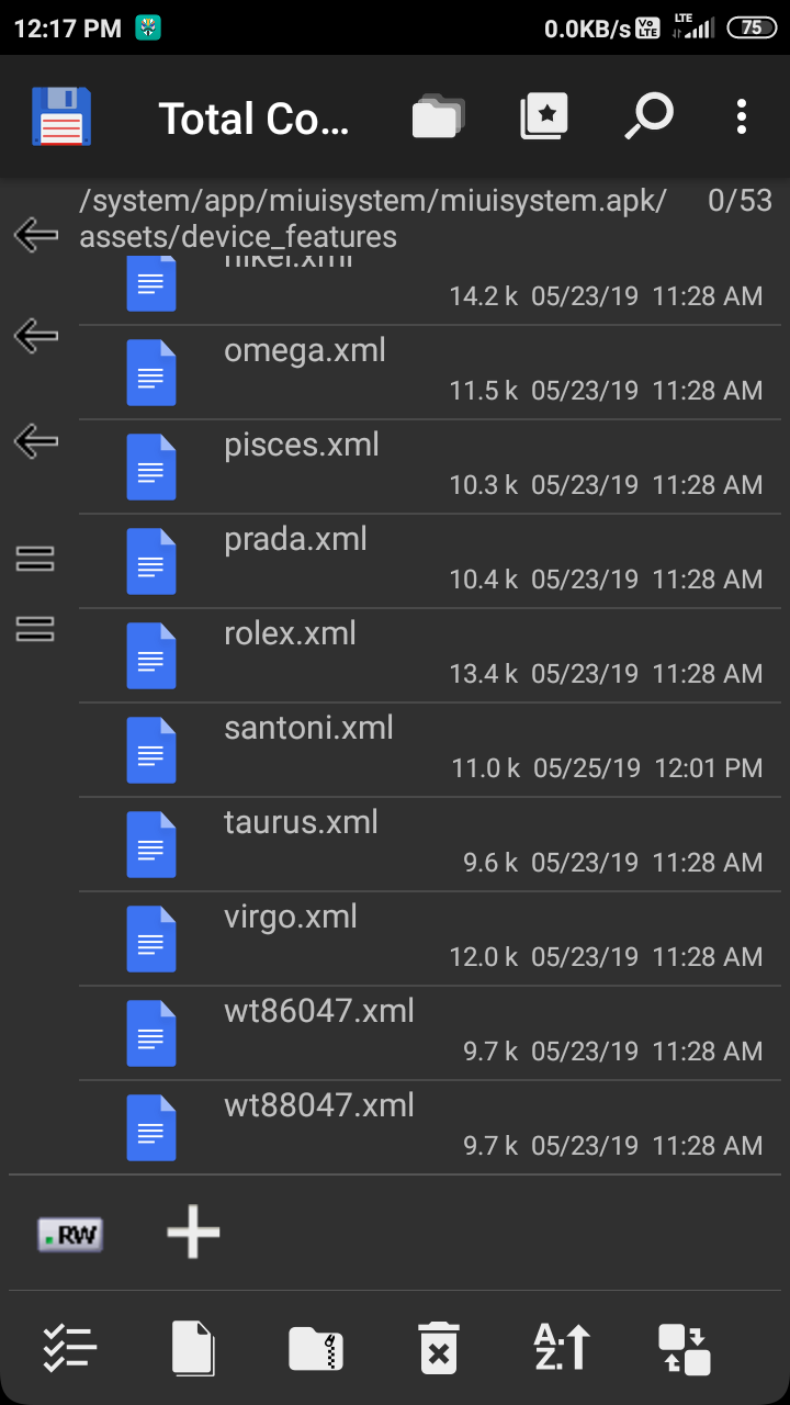

Ok dev I figured out what cause the disappearence of notification led color settings on Redmi 4X and i was able to re-add these options, here is how:
Look for system/app/miuisystem/miuisystem.apk
In the apk look for assets/device_features/santoni.xml
In that file look for line <bool name="support_led_color">false</bool> then set it to 'true'.
I copied the .apk to sd, opened as .zip made the mod then saved, deleted original .apk, copied modded one then rebooted. First boot takes a bit longer after this but now it has the option to multi colored leds again.
Maybe you could change this in the next build.
