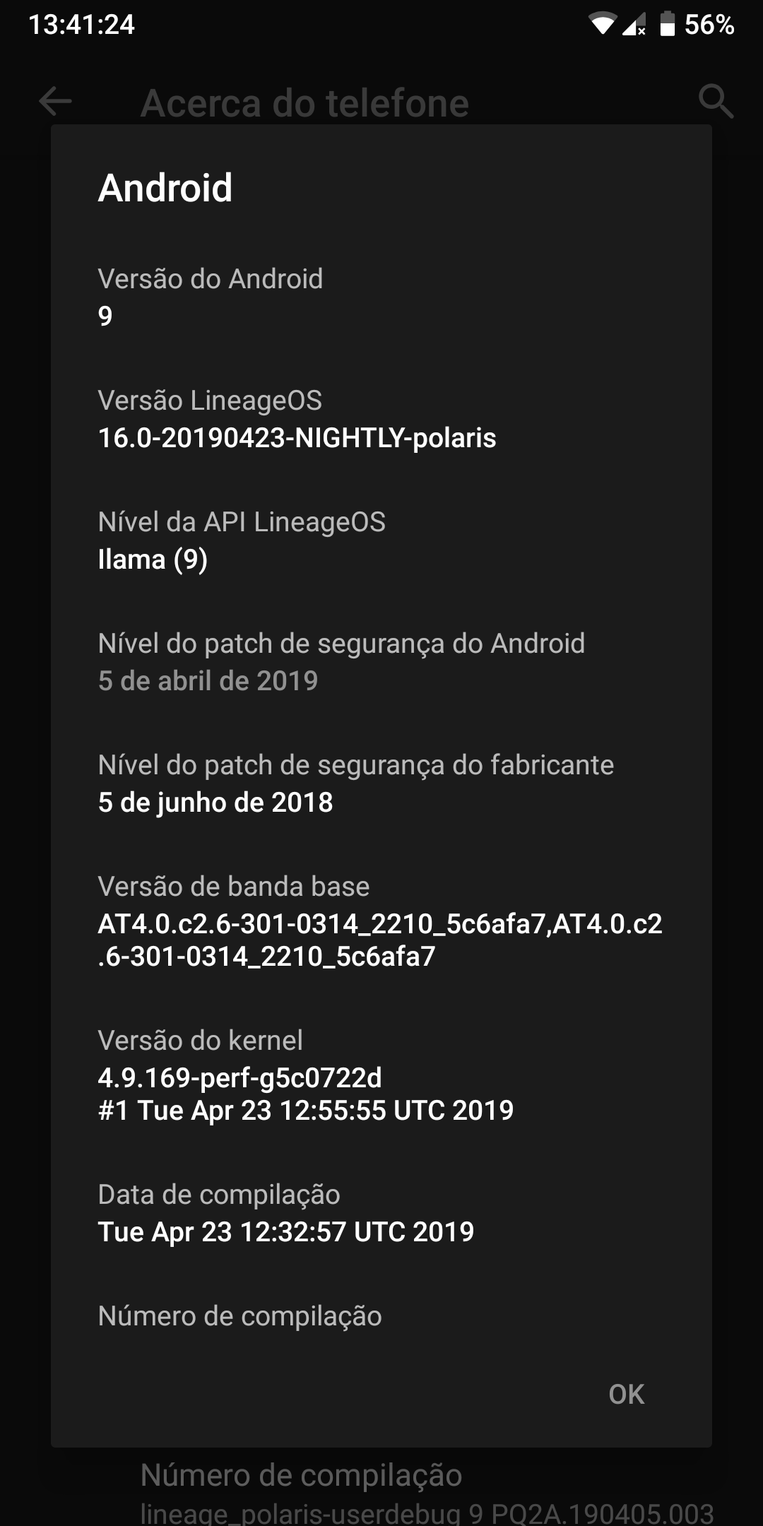

Phurya
Dec 19, 2016
24
I hope sooner or later some developer will be able to inspect and increase SAR ratings if this is the source of problems. I don't care if any value is too high or not, but I need phone that is accessible and data and voice are working.
9.4.18 so far looks much better than global stable (that one acted like it has damaged antenna). I'm still testing and I agree - that is shame for xiaomi that they allowed to kill main feature of their flagship device.
Phurya: what is Your country? What baseband version You have in aosp?
I'm on Portugal right now, I live here, but travel a lot because I'm a industrial solderer, 2 weeks ago I was on Turkey, and same problem, same issues.

I had no echo problems, but a lot of call dropping, and frequently not being reachable... latest weekly is just the same for me, so I'm using LOS 16, works flawlessly.
It's unacceptable Xiaomi has oficiall builds that makes their phones nearly unusable.
