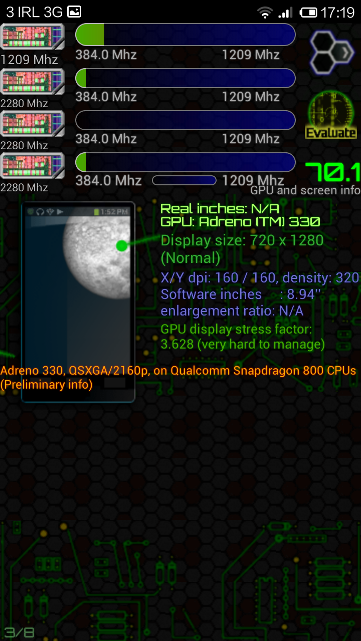

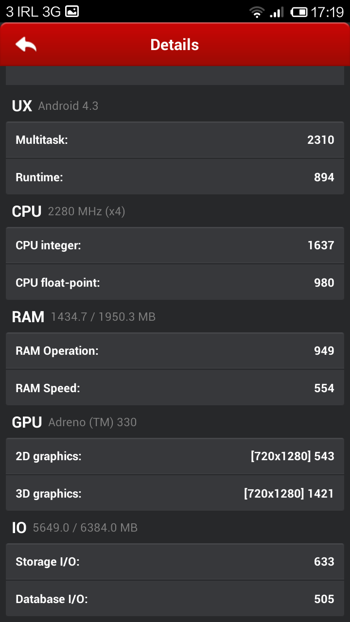

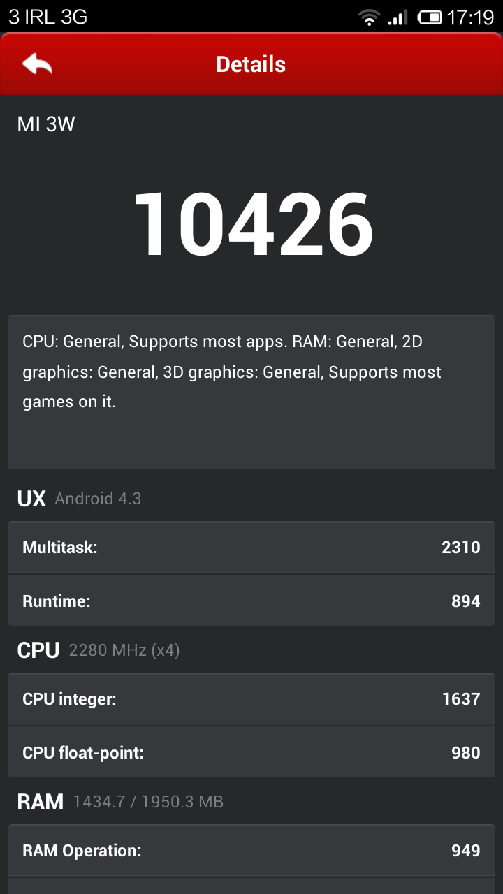

I could not run Antutu as it freezes at 8% so I browsed the file system on the phone and found an Antutu folder which I then deleted. When I ran it again it worked but reported the phone details with a score of 10426 see pic 1,

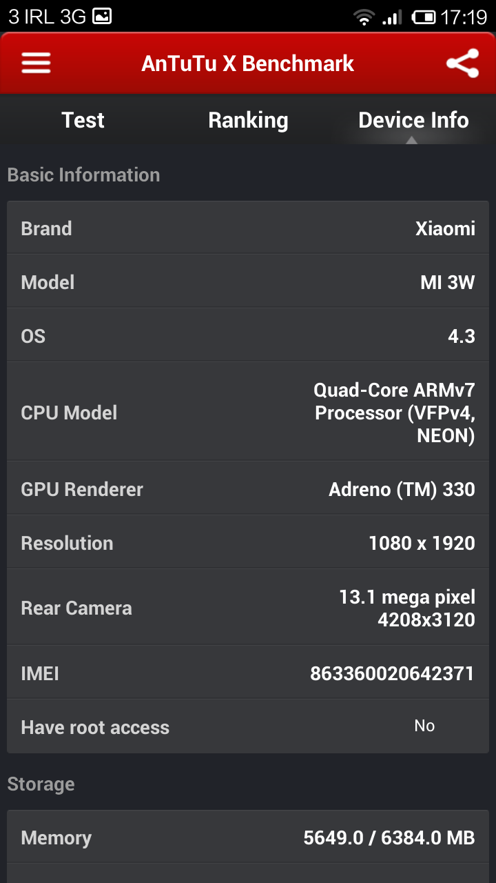

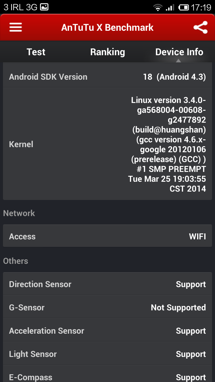

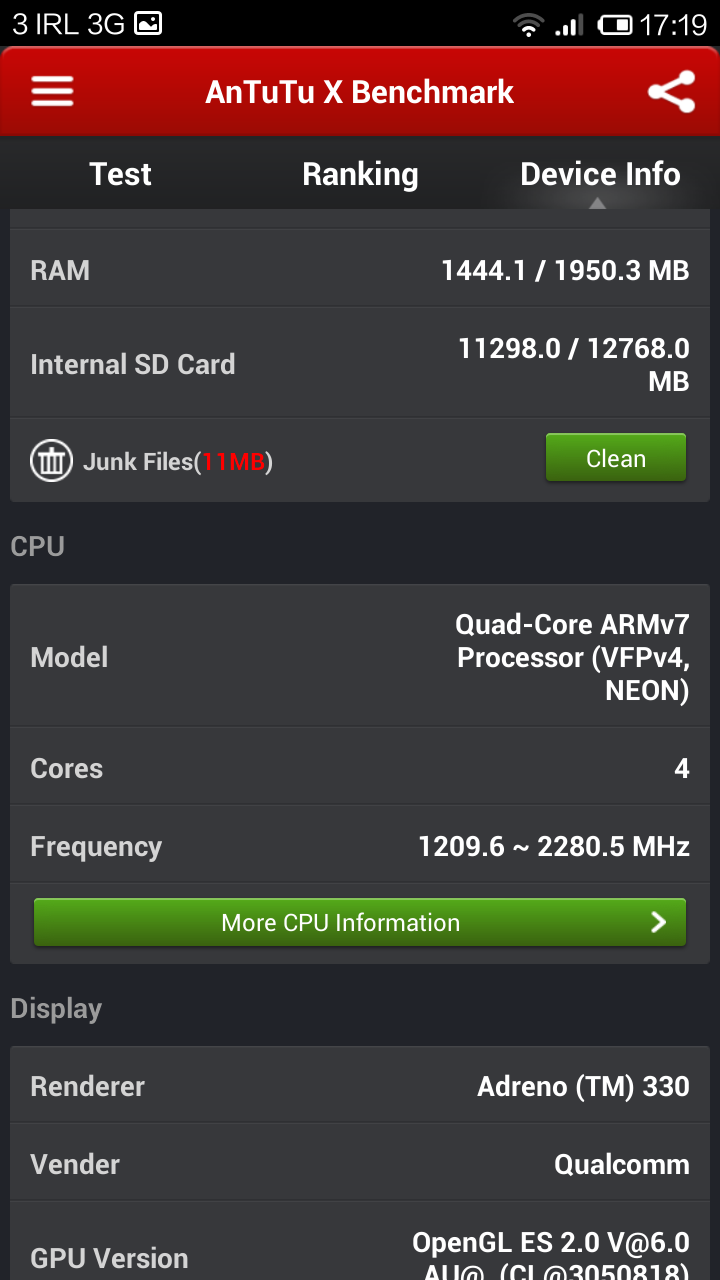

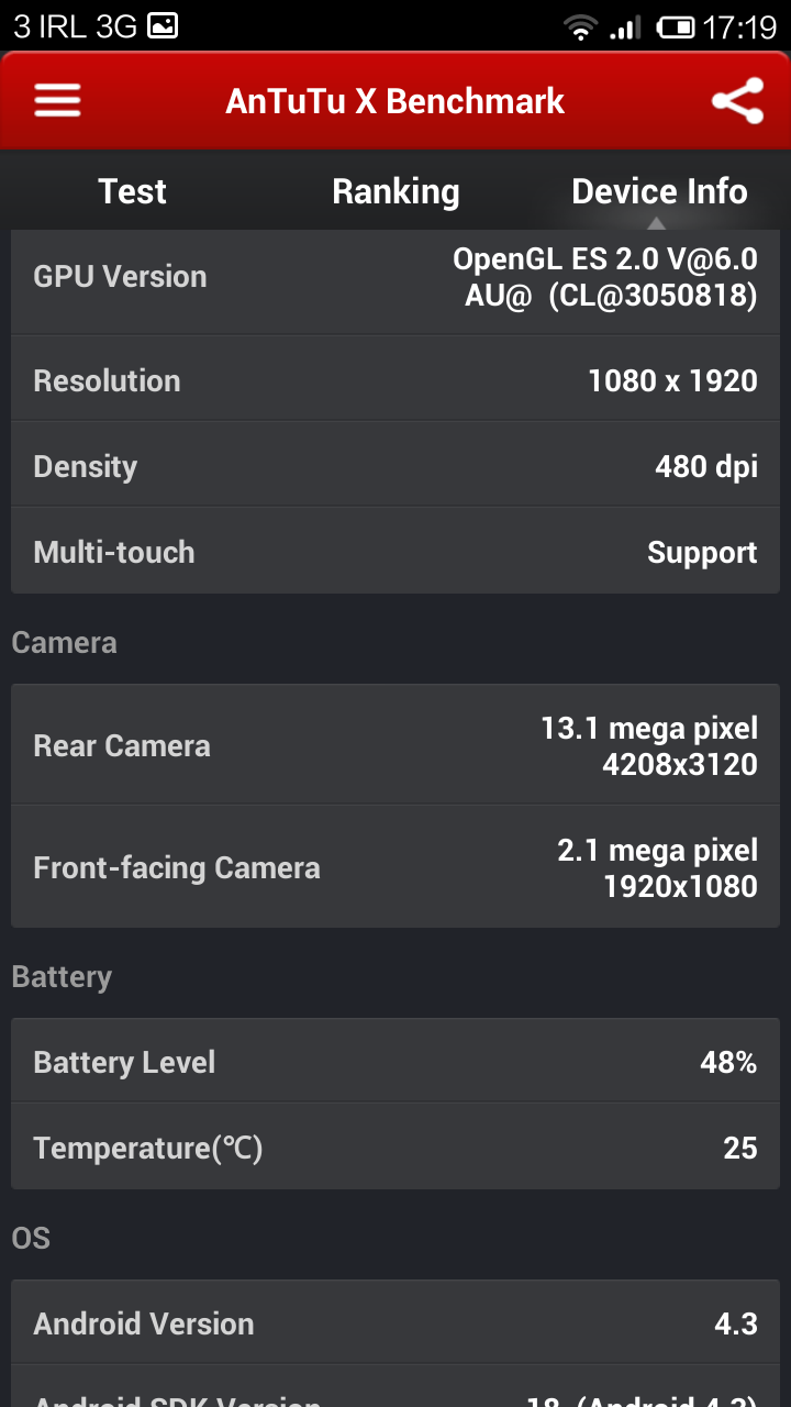

yet when I select device info on anTuTu it shows it with all the correct info see pics 2

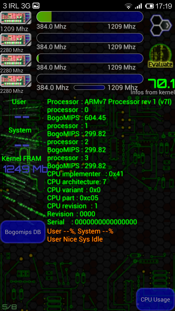

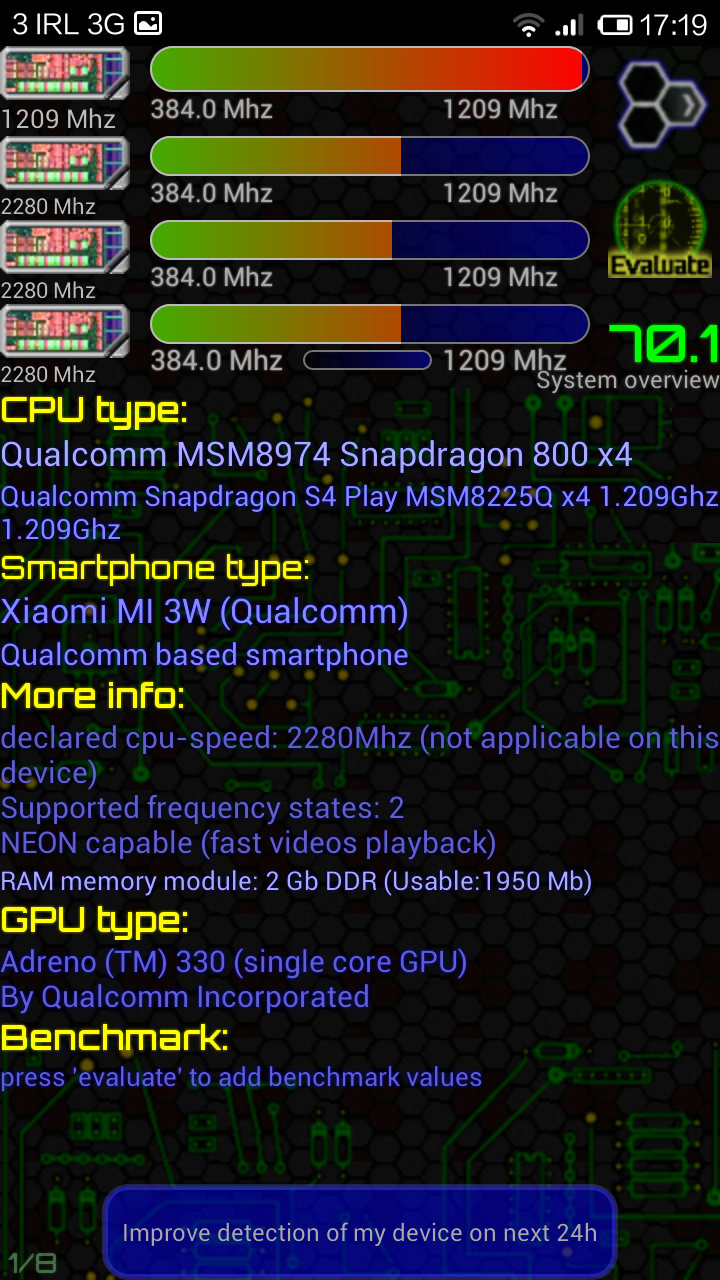

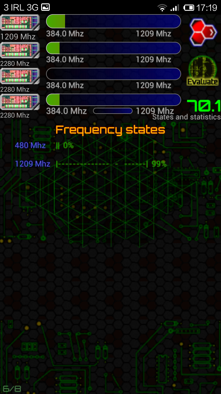

I then managed to install CPU identifier app which showed the following screens but yet stated it had a Snapdragon cpu but it only ran at 1209Mhz, plus it has a max screen resolution of 720 X 1280 and a dpi of 320 see pics

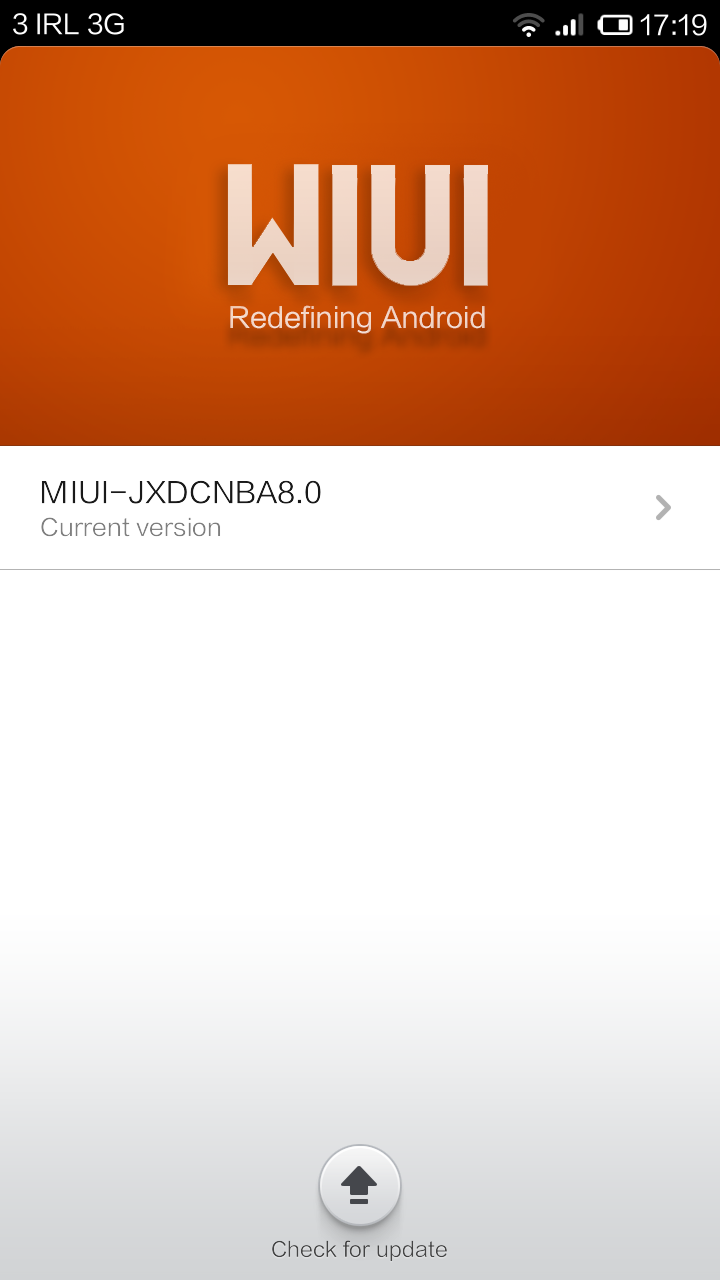

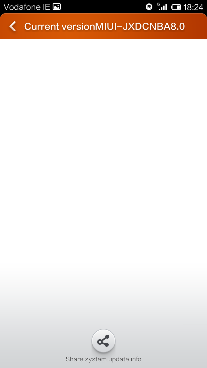

Finally I tried to update and got the WIUI screen which told me that its up to date
