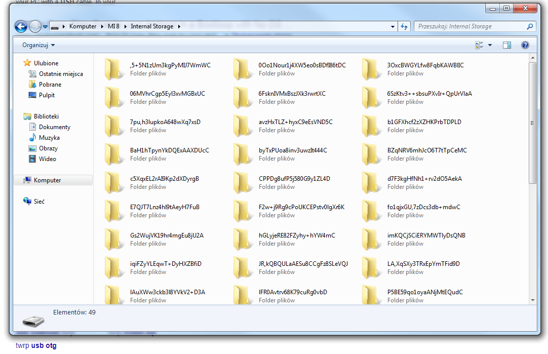

maybe someone help me, I tried flash miui eu 8.9.20 but I had a bootloop, I had the latest twrp 3.2.3, I changed the twrp to other 3.2.3 but always blootloop, the problem is that when I came back to the previous twrp it appeared to me such a strange files, memory is on the same level, so nothing has been removed but the files look like this. does anyone know how to solvel it?
