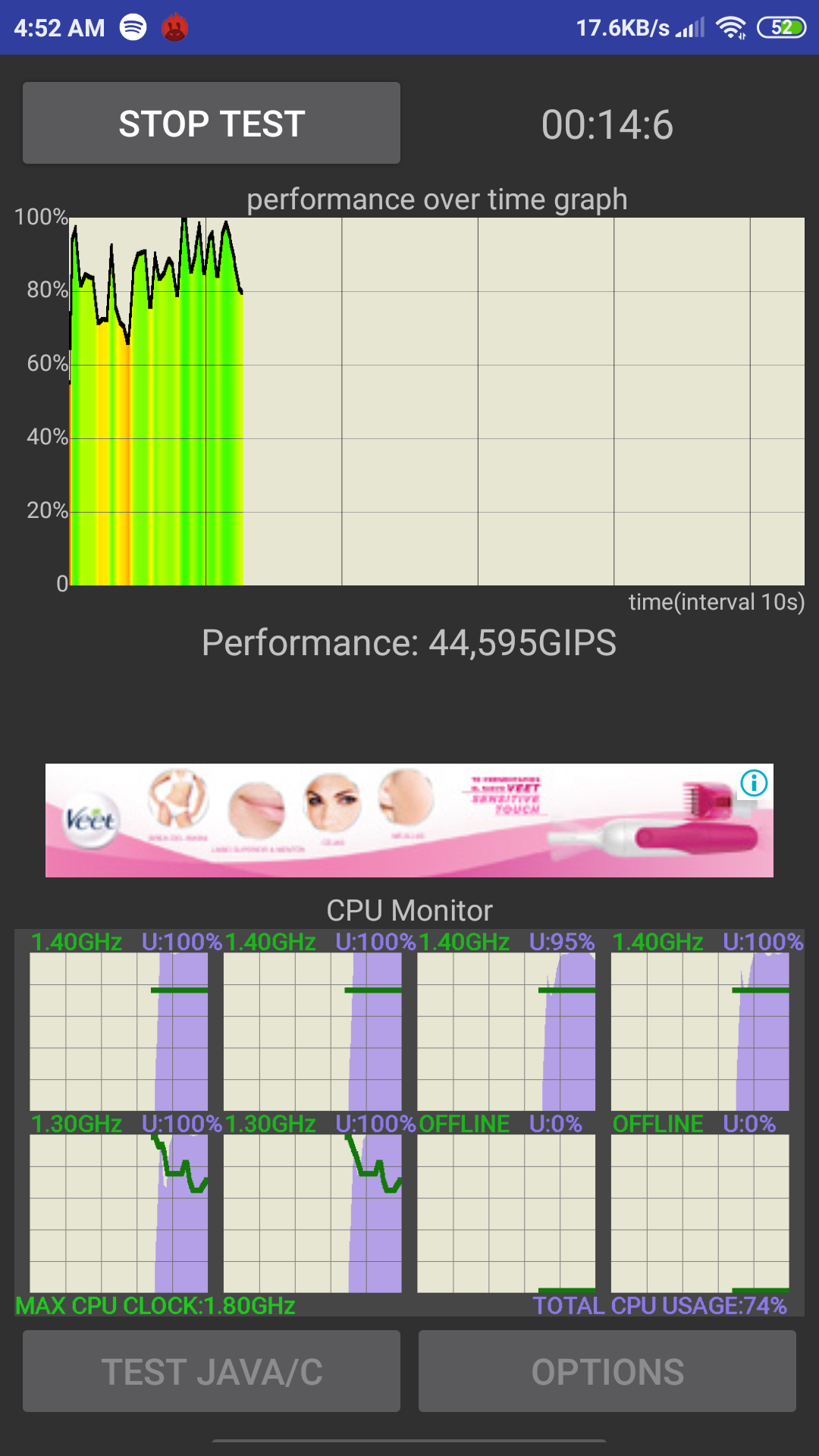

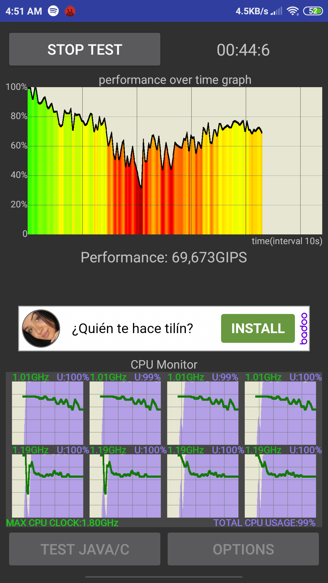

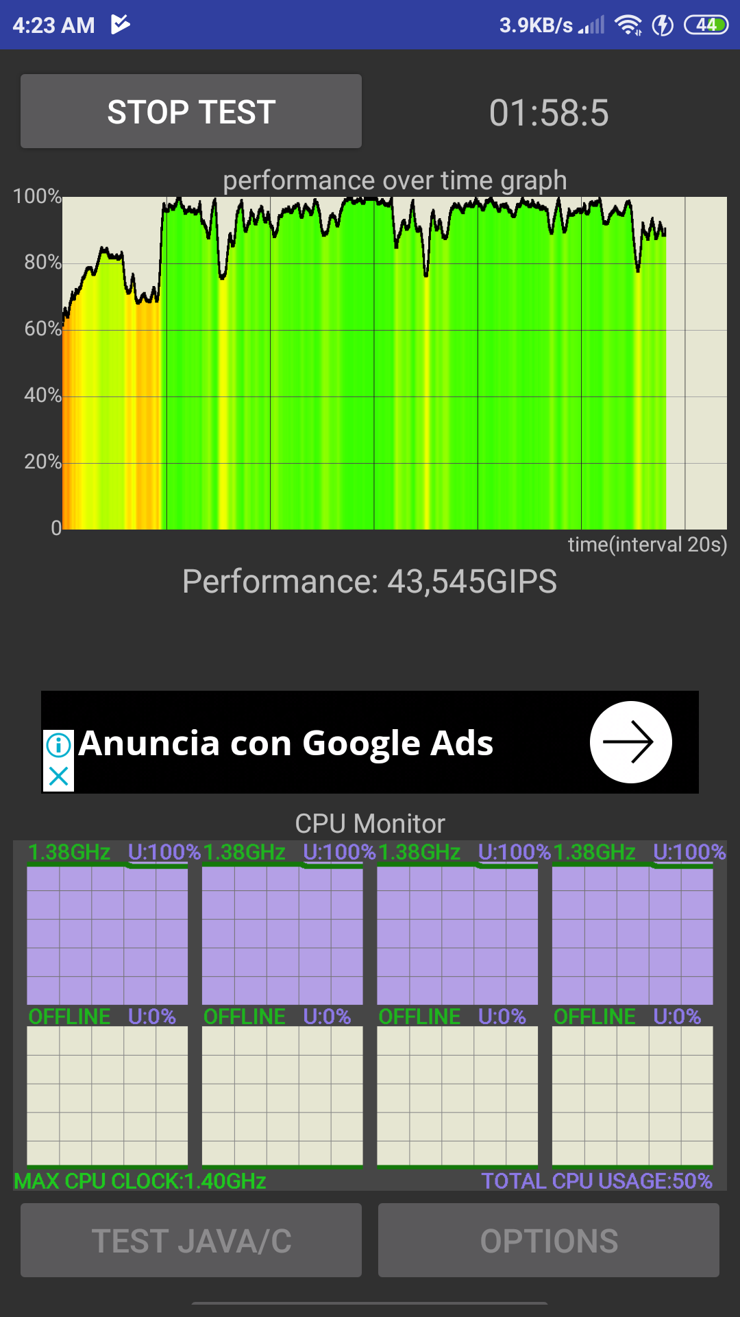

Upon reboot all cores work, but after 3 minutes they start shutting down permanently
