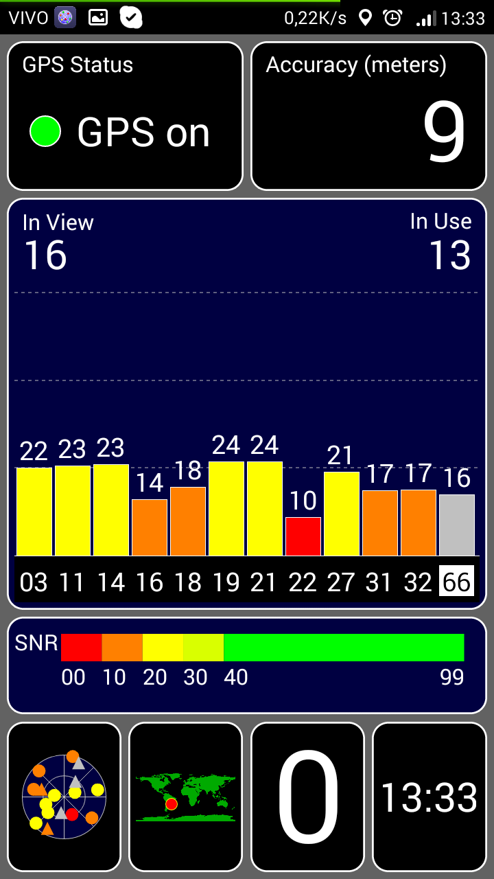

You all can see that, the signal of the GPS is weak.
The sky is very clean and the signal should be much better
see below:
how can make it better?
the signal level should be more than 24.

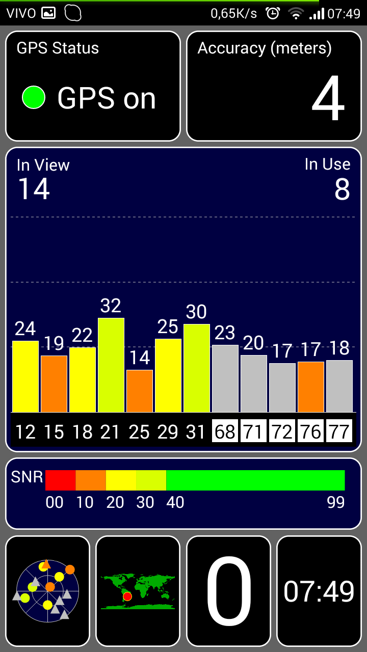

You can see that, even after 5 minutes GPS turned ON, no signal or sync from the satelites.
it should be sync after few seconds and also with a good signal, like:
