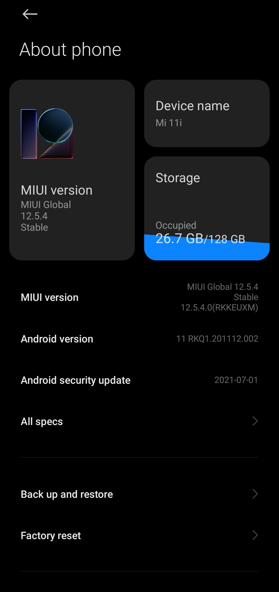

My phone model is Mi 11 i and I want to ask what is the procedure for switching from the global to the European version. From what I read there is no TWRP for haydn. For Mi 11i you can use TWRP from k40 pro if there is one? can someone help please with the steps to follow to pass on I. I applied for bootloader unlock and I have to wait 168 hours.
Here is the installation guide for xiaomi.eu ROM for your model (haydn)

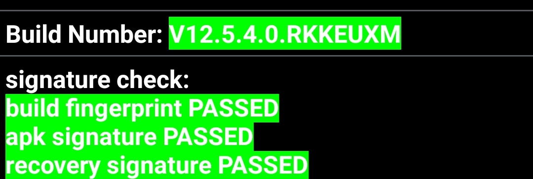

This is not spam! I need help because I can't flash. I want to go back to stock miui. That's all. Unfortunately there are problems with mi flash tool. I'm 60+ now and I don't joke anymore.
PC With Intel processor. I can run adb commands, sideload, install twrp, flash xiaomi.eu and other rom, only miui eea doesn't work. Xiaomi tool gets stuck when super flashing comes. „Super" is not flashed, installation crashes. Here is my problem:
Your third screenshot has the msg to be understood. It is blurred and we can't read it for you.
What is the reported mismatch in object made of?

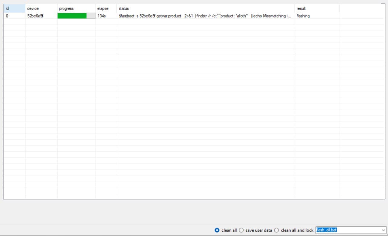

hey there,
I am currently trying to install the weekly version on my k40.
First I downloaded the zip file, extracted the contents on my computer.
Put the phone in fastboot mode and connected it to the pc.
Running the .bat gives and error message:
This package is for "alioth" devices; this is a "unknown"
the command adb devices gives this output:
List of devices attached
6814a3ed device
What could I do to enable the update - maybe remove the following lines from the batch file?
set DEVICE=unknown
for /f "tokens=2" %%D in ('platform-tools-windows\fastboot %* getvar product 2^>^&1 ^| findstr /l /b /c:"product:"') do set DEVICE=%%D
if "%DEVICE%" neq "alioth" echo This package is for "alioth" devices; this is a "%DEVICE%". & exit /B 1
TIA
6814a3ed device
set DEVICE=unknown
TIA
That's because you bought a preinstalled phone and prop file is badly modified.
I am not sure but if you flash one latest android 11 EU rom it might/should be corrected.
If not you can do what you suggest, with little risk on this phone model.
