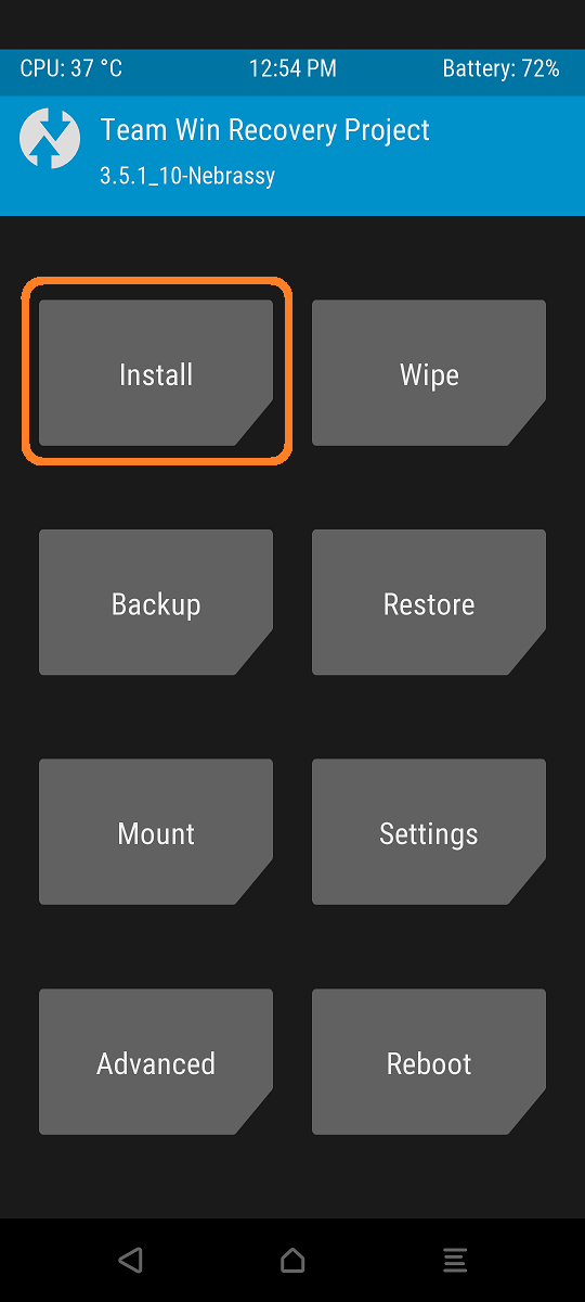

- Install rom

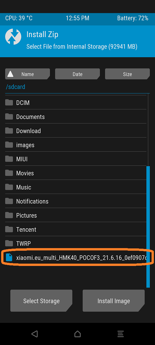

card / Install
find the required ROM in the storage

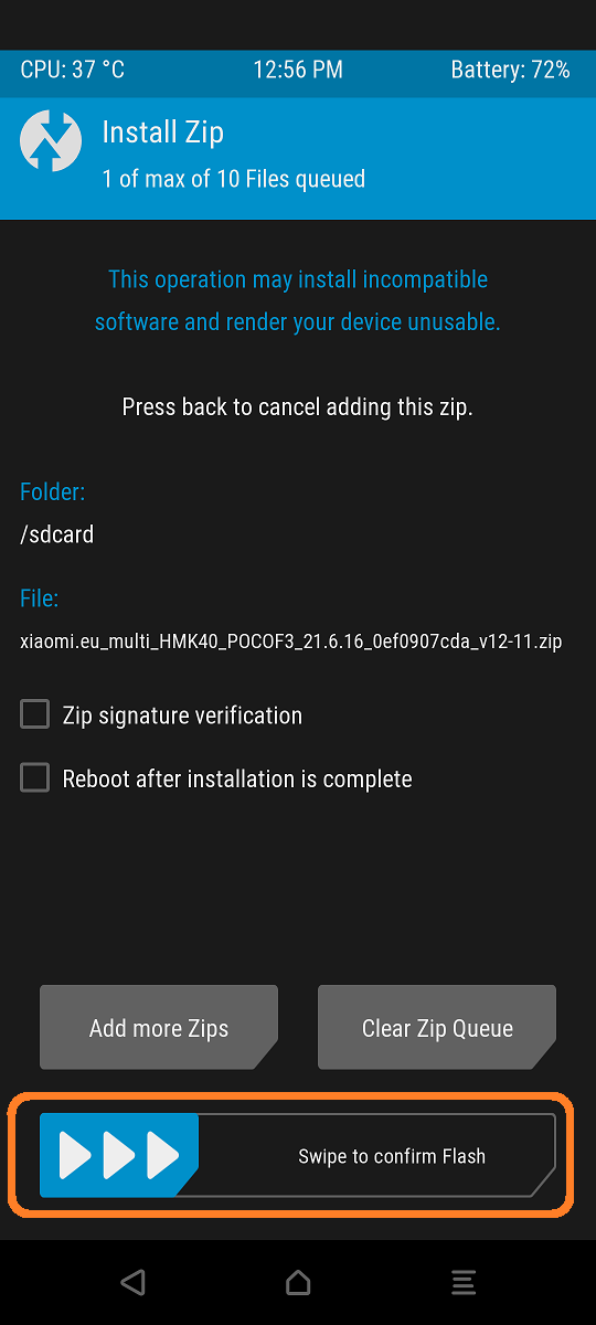

and start the installation Swipe to confirm flash

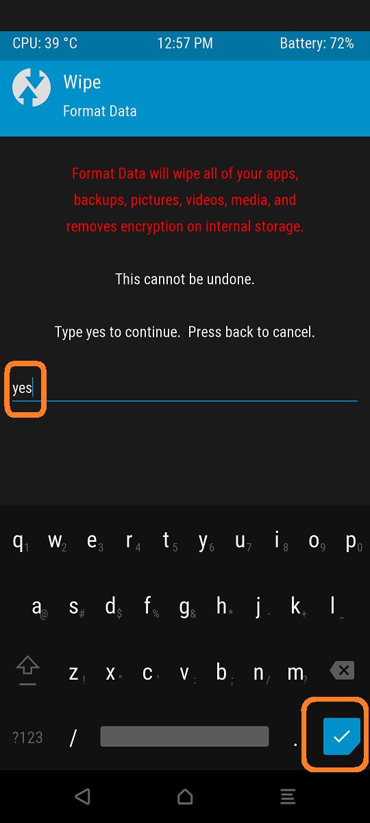

- Perform Format Data

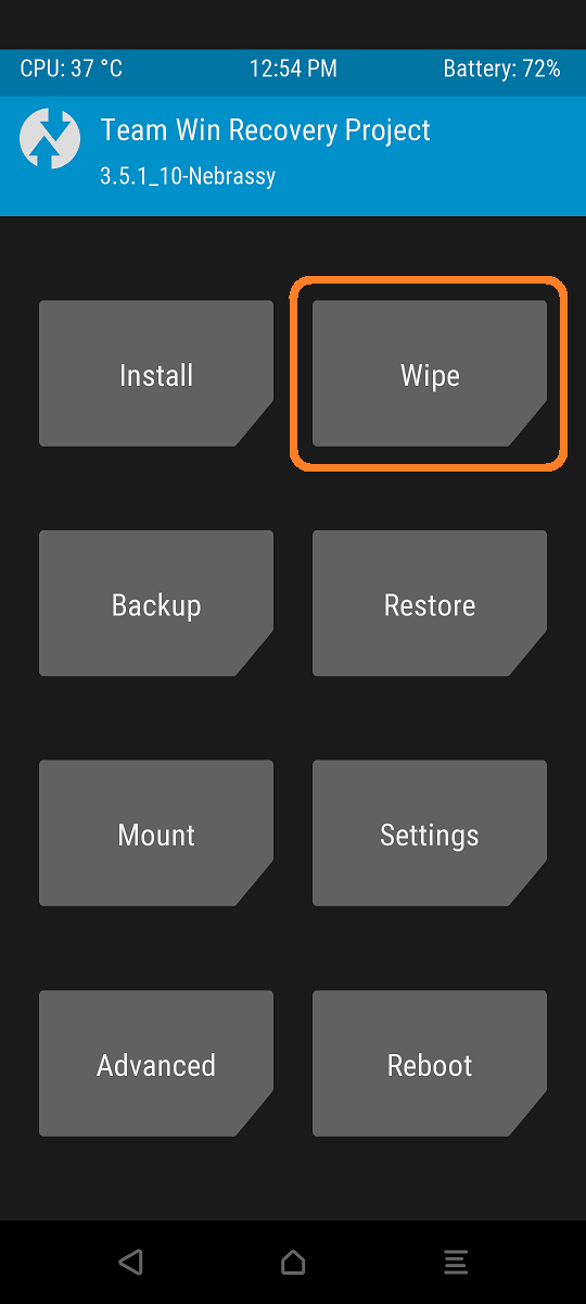

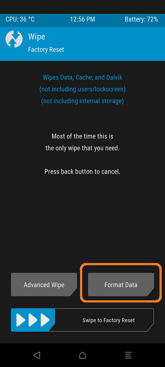

card / Wipe
Format Data
Type yes to confirm the format
