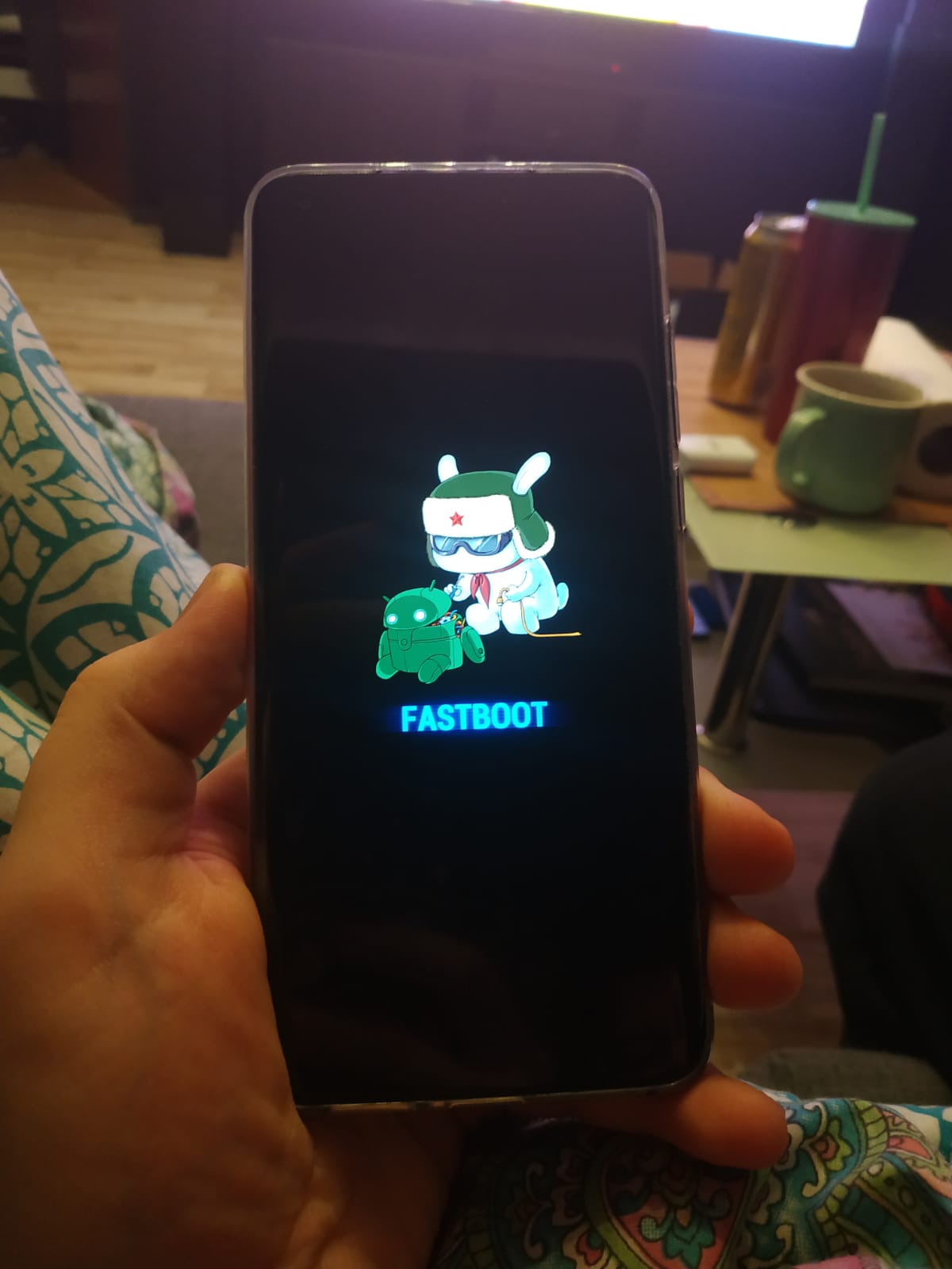

I photographed the screen of my phone when I rebooted into recovery: first attached picture

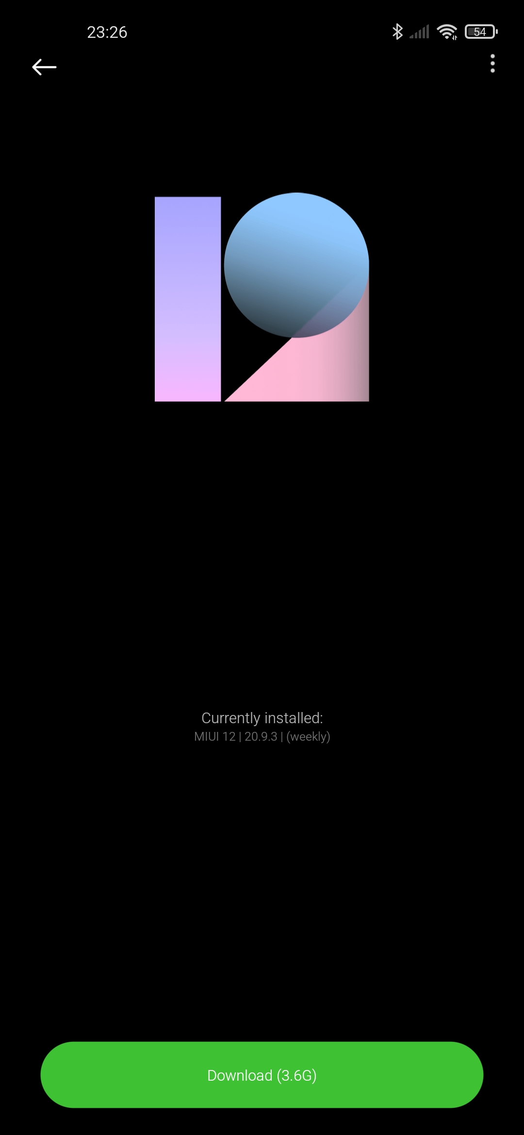

I also screen shot the updater page in MIUI settings: second attached picture
Looks like I have weekly.
Is this a problem when changing to twrp stable now or should I change to twrp weekly to keep all data?

If you want to preserve your data, you have to stick with weekly. Since your weekly is Android 10, you have to look for the latest Android 10 Weekly, that seems to be https://xiaomi.eu/community/threads/20-10-22.57990/
Either your do flash it the same way you already know (fastboot), or you go for twrp.
Just download the latest weekly, as that is what your currently using, install twrp from fastboot, reboot straight away to twrp.
Make a nandroid back up in twrp, copy it to your PC as a back up, then install latest weekly A11, wipe dalvik and cache ( not format), reboot to system. It will take a while to boot but as long as you see 5g and then miui, just wait.
If it fails, then go back to twrp and move your back up back and restore, then install each weekly in turn until you get latest.
