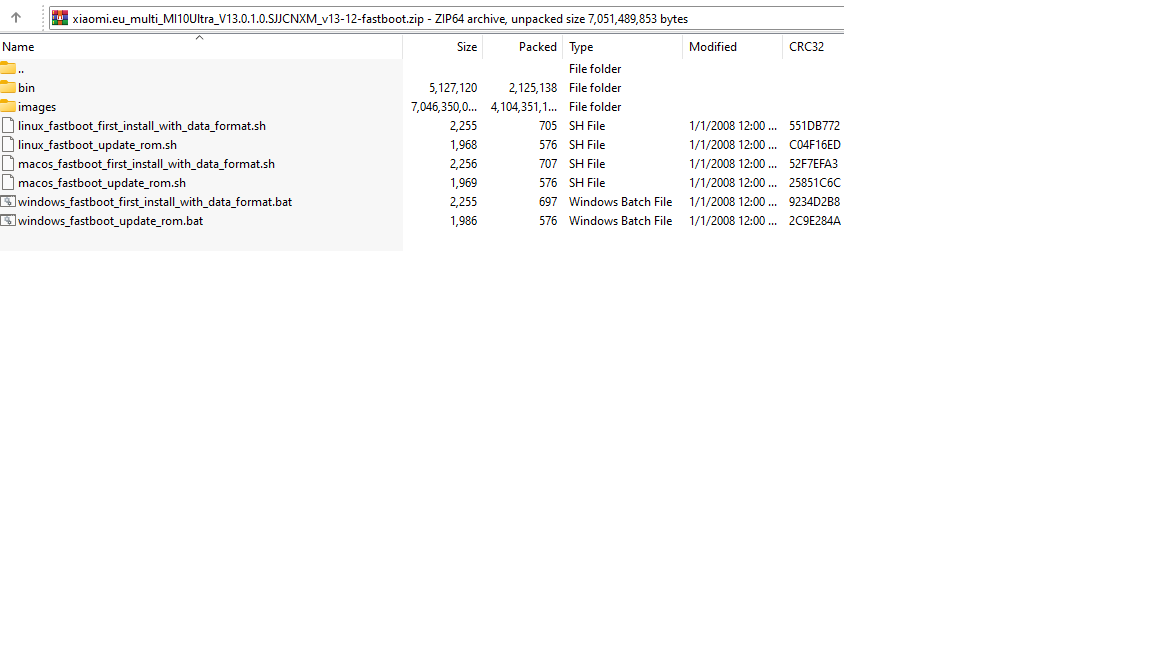

hello, im no expert in this, can advise how you installed this? i tried miflash the eu version but it keeps rebooting to twrp.
i'm currently on the china version of miui 13.
i downloaded the eu version off this site but doesn't have flashall.bat that i see in youtube tutorials.. may i know what's the exact steps to installing this?
Thank you!

It is as simple as:
1. Boot your phone to bootloader via command/terminal
Code:
adb reboot bootloader
2. Double-click on the appropriate .bat file:
a) Operating systems - Linux, MacOS, or Windows
b) If you change ROM base - china ROM to xiaomi.eu or from weekly to stable - you should choose with_data_format. It will reformat your phone, so be warned.
You might need to properly setup your adb.

I hope you have unlocked bootloader before you try installing the ROM form here....
If yes, then just follow the instructions above. If not, unlock it first

this is easy and it works!! thanks mate!
