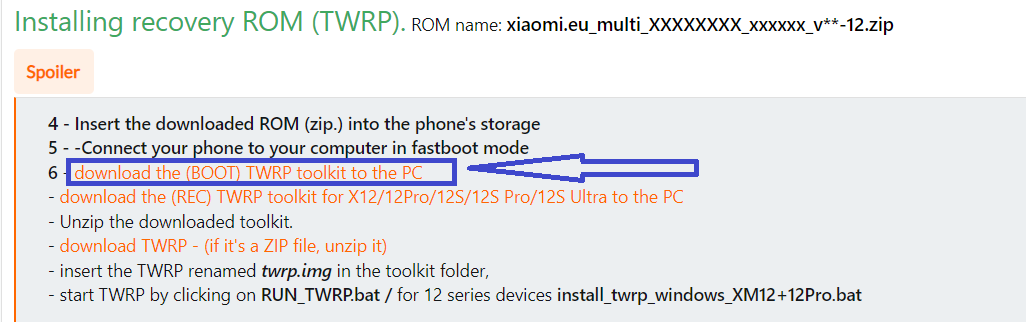

Hi,this twrp toolkit run also on MI 11i or only for 12 series's?
There are two tools. One is for series 11 and the other is for series 12. You have it written there.
