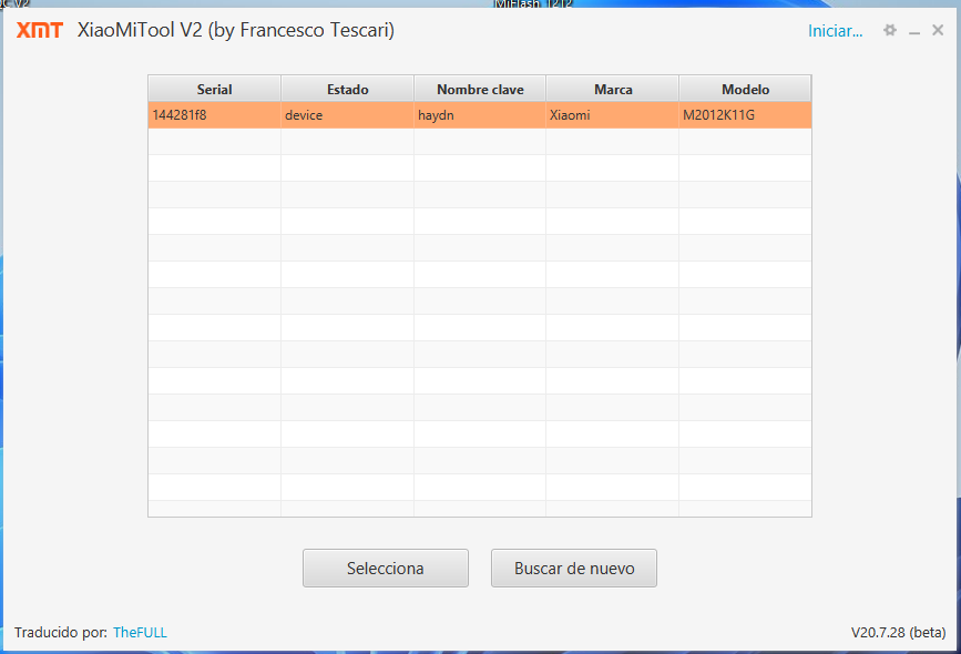

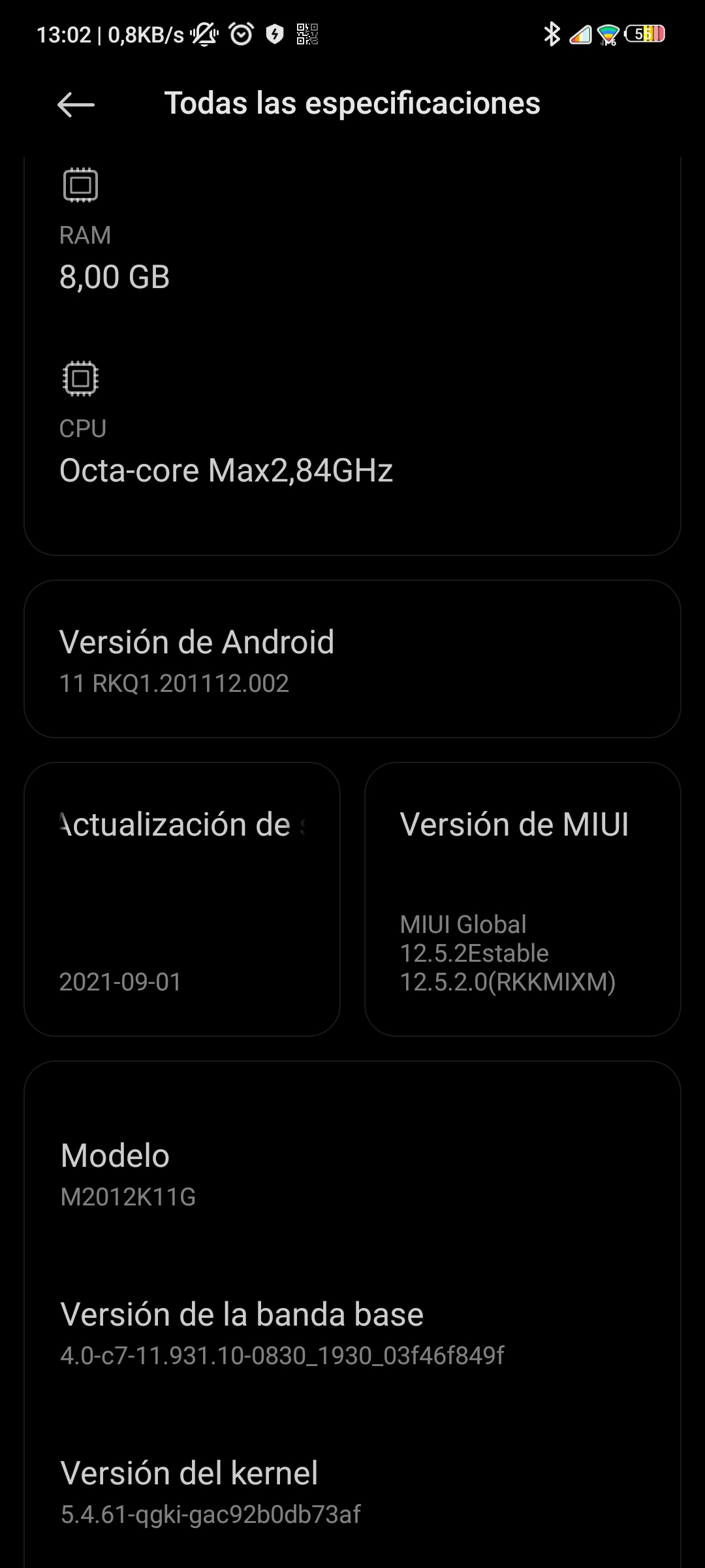

hi, I have the xiaomi M2012K11 G5, equivalent to the MI 11X I think, I could install this rom I have the global rom thanks
Uhm... Probably not... First of all there's no "G5" model designation, you probably mean M2012K11 5G. That's still a Poco F3 and so on, not a device compatible with this ROM. If you want brick your phone then go ahead. ;)
look at the photo in the previous post
It is not pocophone because on the box it clearly says MI 11i;)
Where did you buy the phone? Also, where are you getting the model information from? Maybe someone put a Pocophone F3 into a Mi11i box. Again, I would trust the box less than the proper model designation found in the phone itself.
You check the model by going into Settings -> All specs and look what it says under "Model" and that's the only thing that matters, not the box, LOL.
I mean, I don't know what you want to argue about on this forum and why you're asking at all if you're so sure. It's your phone, brick it at your own peril. ¯\_(ツ)_/¯
The photo says M2012K11G, not G5, so I have no clue where you got the G5 from. Make a screenshot of this screen to be sure:

https://www.gsmarena.com/xiaomi_mi_11i-10777.php this is my phone sir
Well, seems OK, so indeed this ROM should work. Mind though that many people (including me) have bricked their phones when flashing through fastboot and the reasons for that are not quite understood - seems to be that some version combinations (which version you're flashing FROM and which you are flashing TO) work better than others.
