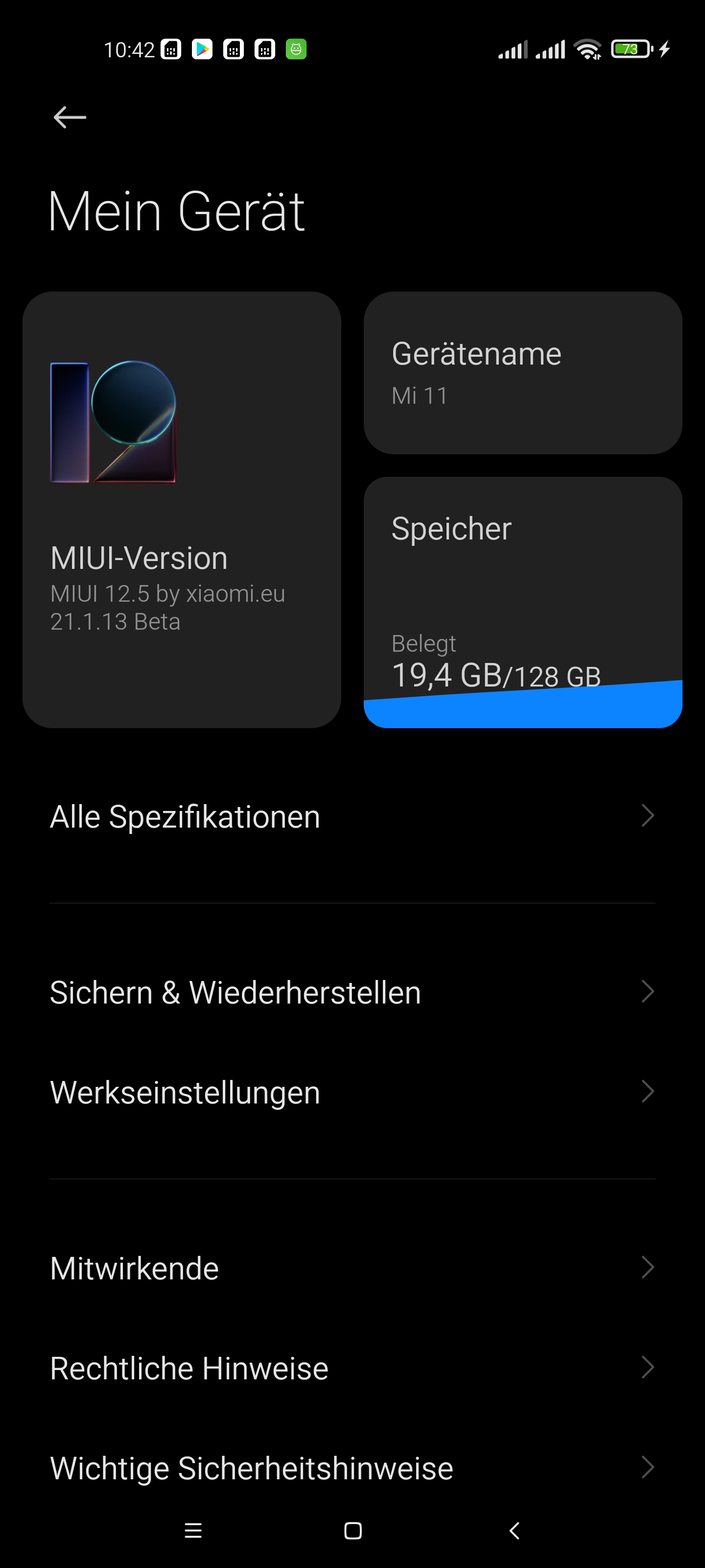

Unlocked succesfully ..
Fastboot script for windows works as it should...
First boot only takes ~5min !!!
Thx 2 devs.. now I have to restore all my stuff... I am back reporting
Edit:
seems to be working so far. nothing to complain yet :)
Edit:

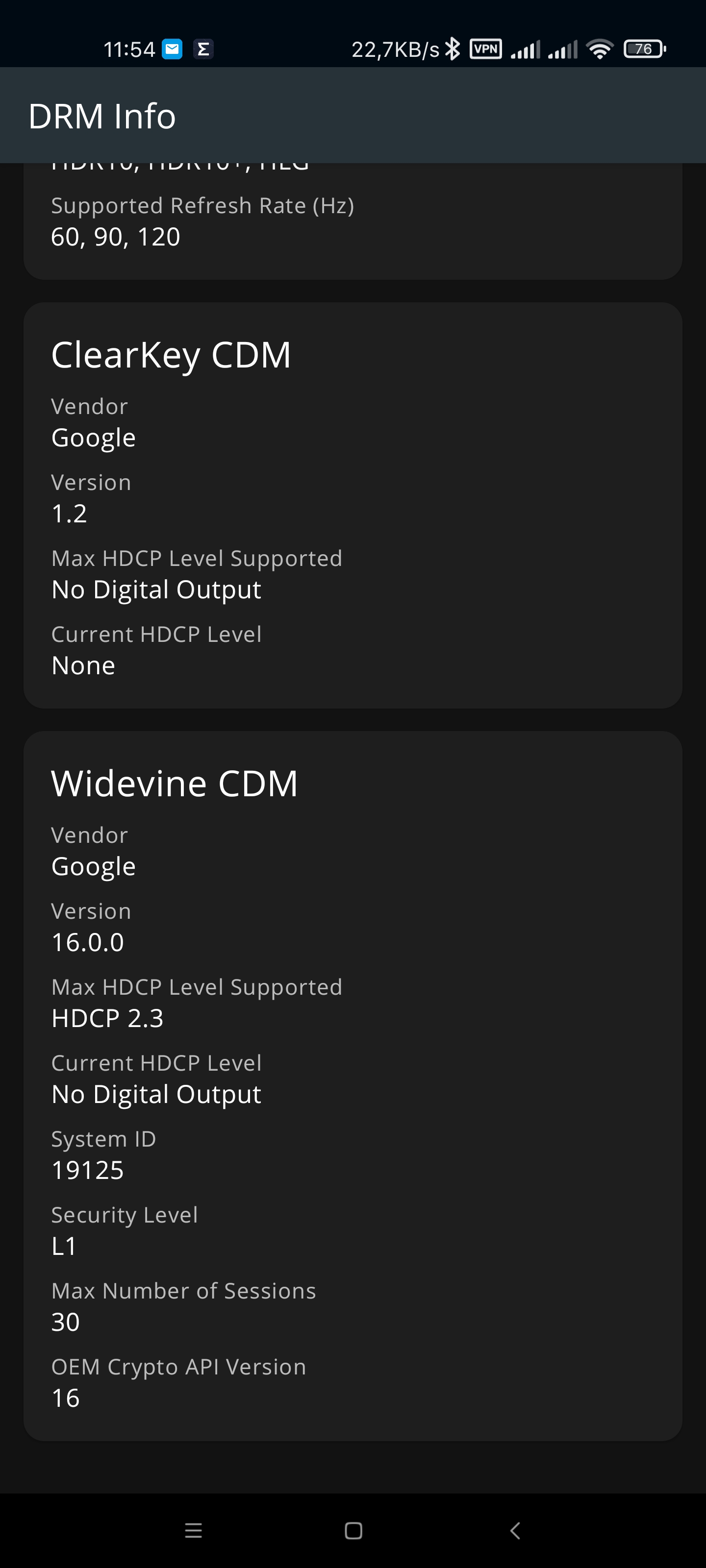

Widevine L1 (Screenshot)
I love this rom all is working for me. no problems...
Just the "4G" icon is not shown, it always shows "LTE ore LTE+"
Very nice, thanks
Does Netflix work? On my rooted S8 it also shows L1 but when i try to play sth. on Netflix, i get an error code. I have to delete liboemencrypt to use Netflix again.
