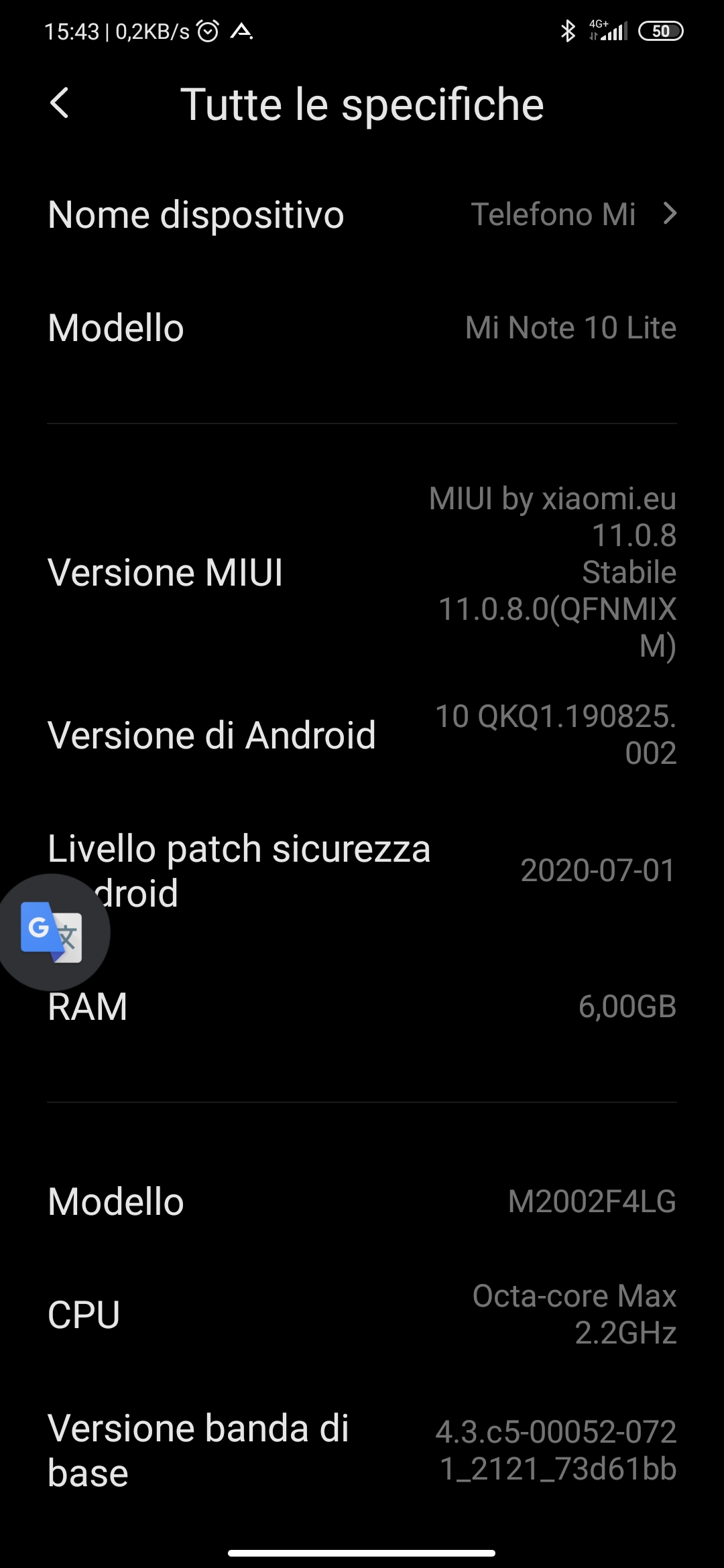

I already have this on an Italian group they recommend the EEA but you are a developer so if you recommend this, I will skip this one. Waiting for MIUI 12
Ours is a custom ROM, EEA isn't. There can be no comparison.

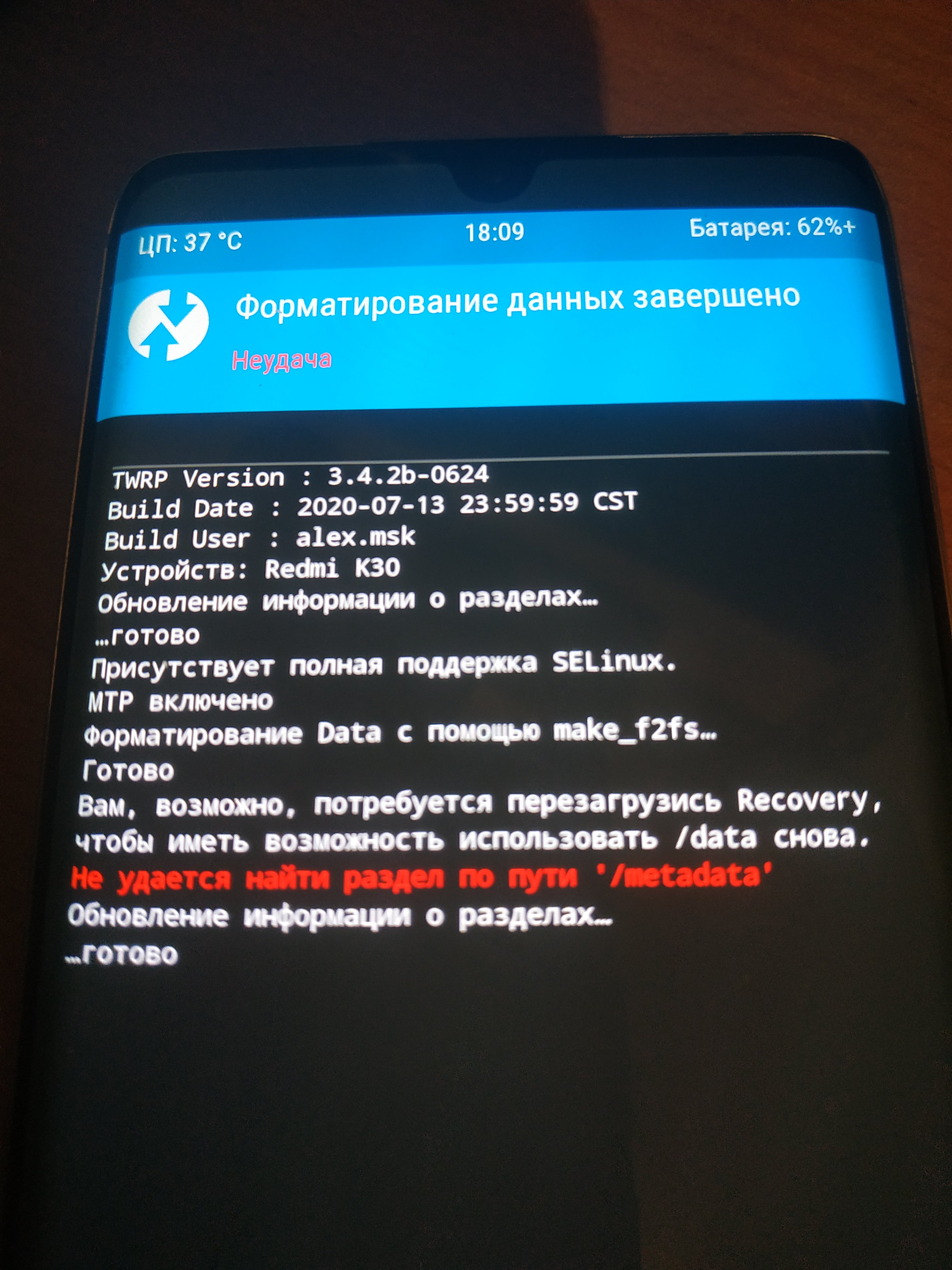

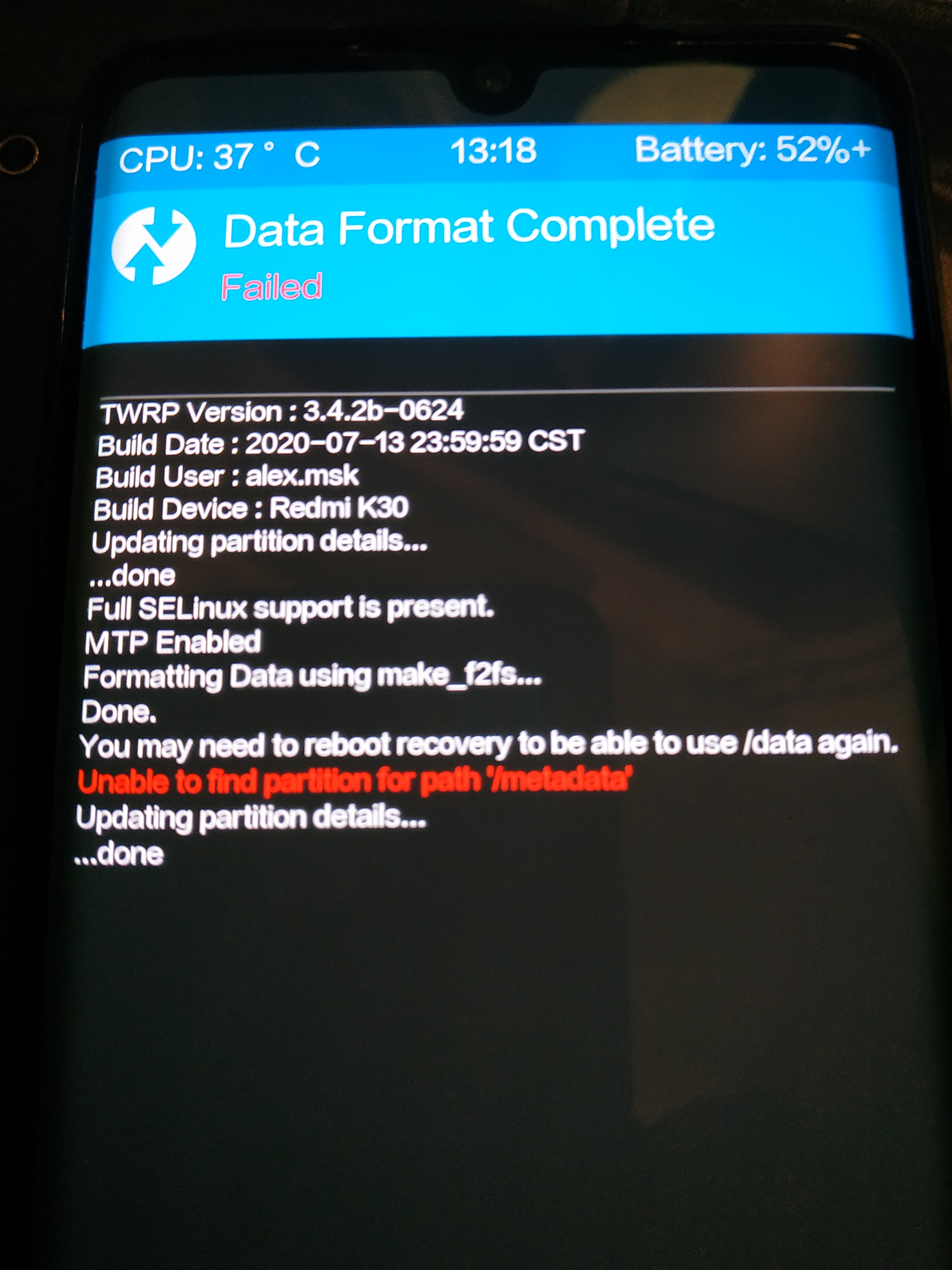

I follow the whole procedure but it always sends me in fasttboot mode and I have to use me flash
I have some difficulties with installing the twrp and ROM too.
It worked one time but then the miui updater gave an error so I installed a fastboot ROM.
The second time i tried a twrp ROM IT gave a Russian error and I ended up in a fastboot loop.
In twrp I do format data but I get this russian error about /metadata
(See picture)
31241
So I am also back on a fastboot ROM.
But when somebody has the answer i will try a twrp ROM again. I followed the list BTW.
I have changed the language in twrp from Russian to English. When I format Data it keeps saying it can't find the map /metadata.
I have chosen to change/repair file system to ext4 and back to the filesystem it was: F2FS
But the error about /metada was still there.
Unless that problem I have installed a recovery rom.
The rom is working, the only thing is it the miui Updater gives an error when you use the miui Updater, and download a newer rom.
(Checksum doesn't match)
So I installed the newer rom from twrp.
I hope there will be a newer stable twrp available, wich doesn't give the / metadata error.
Try to reboot to recovery from recovery
I tried it again today, all the steps from first page.
and also again: recovery from recovery

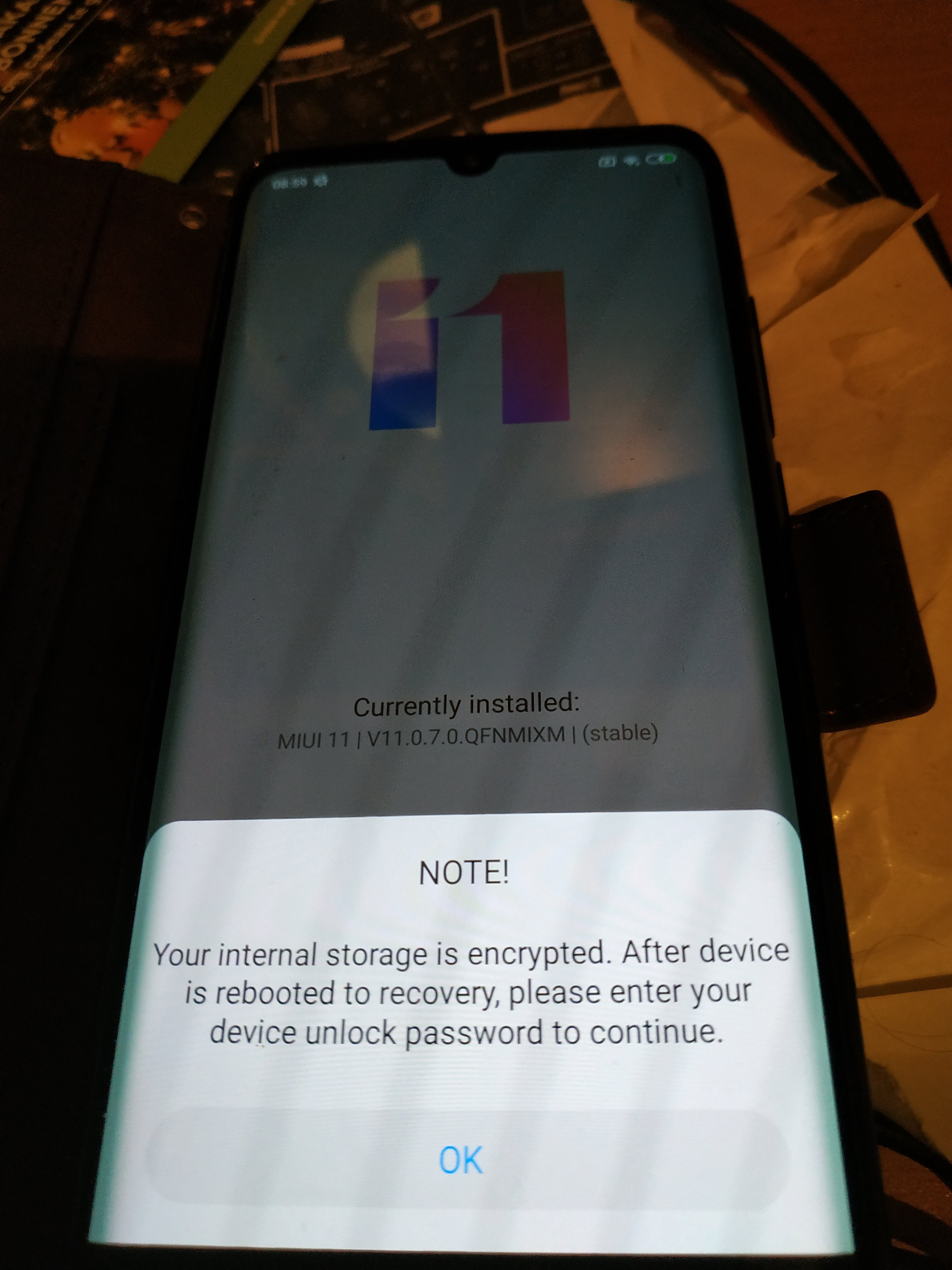

In twrp it keep saying: can't find /metadata (first picture)
In the miui Updater when I choose the update package (miui 11 zip file)I get this error about encription (second picture) In twrp there is no possibility to give a password.
But nevertheless the phone is working so I don't know if these 2 errors are important.
