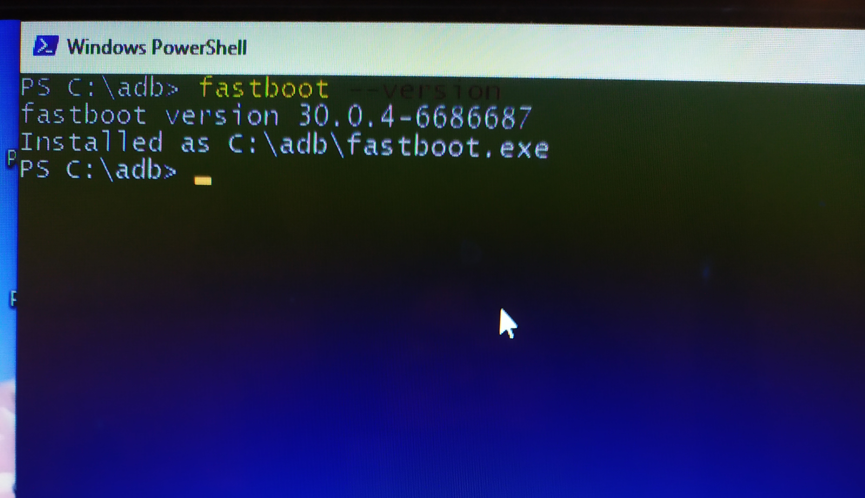

But I need to check something, can you type "fastboot --version" in PowerShell and take a screenshot of the result?

Hi, typed ^fastboot version^ in PowerShell like you asked me yesterday, ecoo what comes out

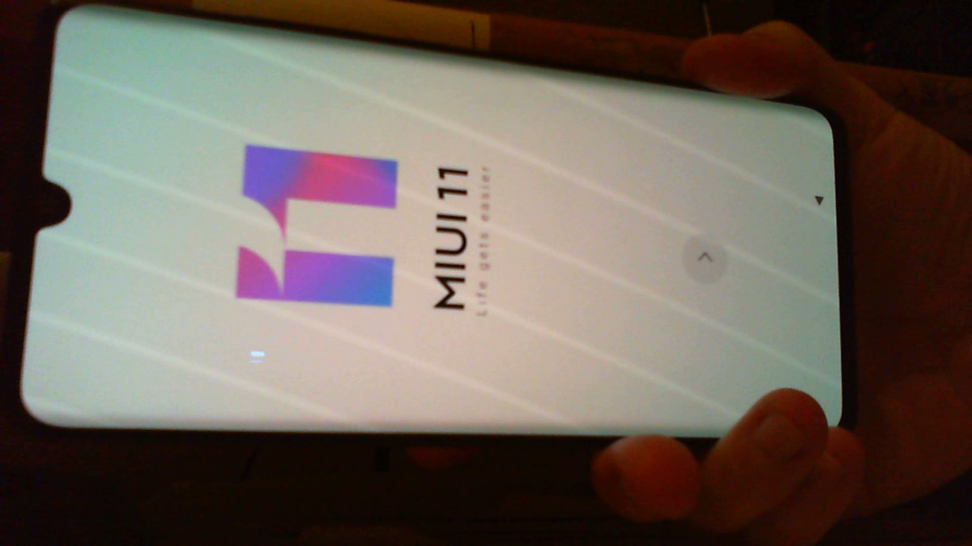

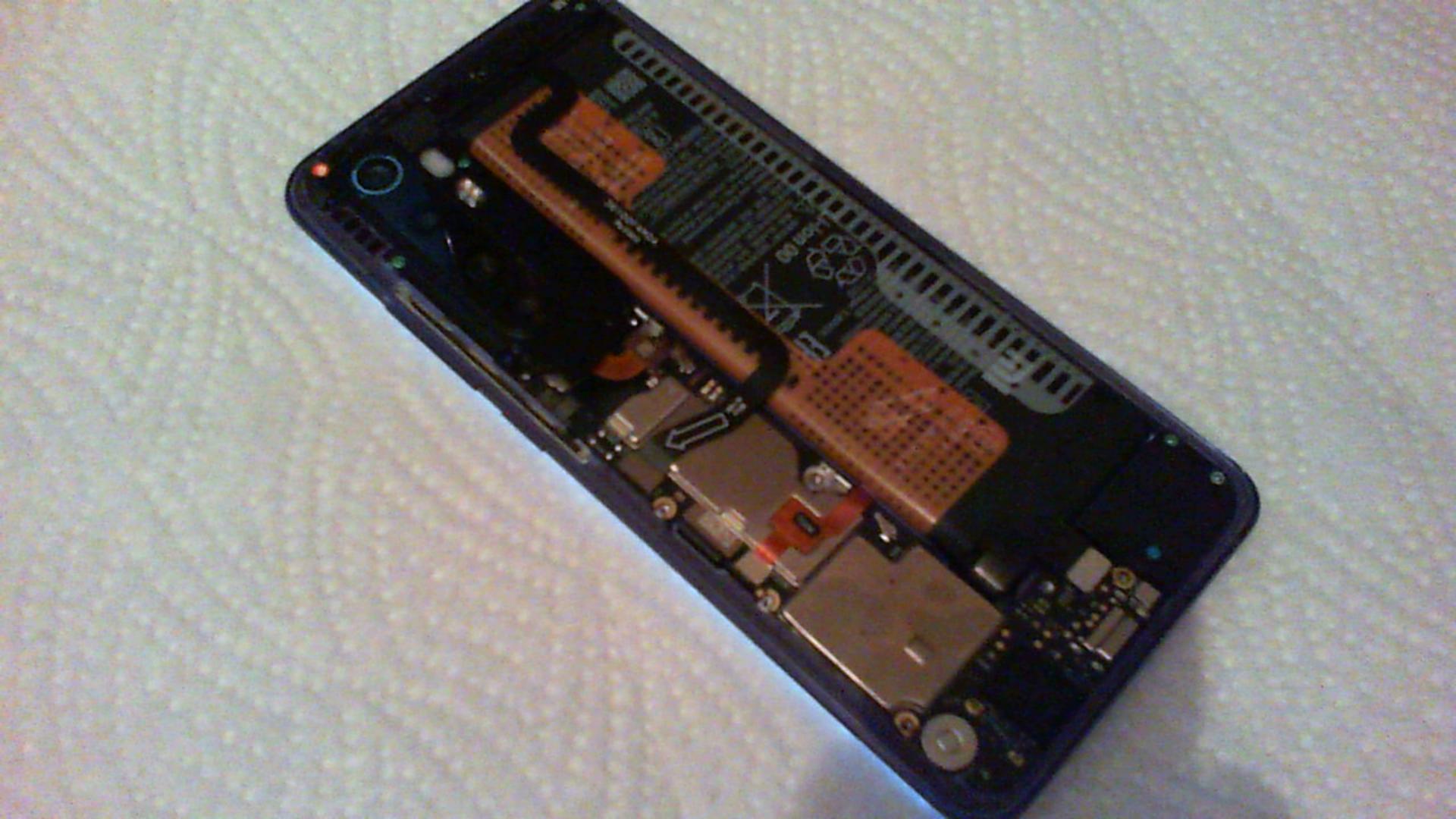

BRICKED-PHONE repaired!
VERY SPECIAL THANKS TO Angeluss69 - He was professional in bringing it back alive in every aspect!
Look for Angeluss69 - Hey managed to get the job done VERY WELL! Without him my phone would be still bricked by now!
1. I was totally paranoid because of the teamviewer-situation (its not the most nice feeling to grant someone you do not know
access to your computer) - I tried to setup a sandbox, worked - but inside the sandbox the phone driver didnt show up.. - so
no "backup-security" from the sandbox..
2. I wasnt sure if this really will work out, because my phone was really LOCKED TO THE FULLEST.
3. I was absolutely full of critics if that would work out.
Angeluss69 DESTROYED EVERY DOUBT by his professional way to deal with my problem:
Helpful, polite, very supporting, VEEERY PATIENT, got the SKILLS you need from a person who does the job right!
CHEAP PRICE compared to my actual situation (ship the phone to the china-manufacturer because european
OFFICIALLY STORE AUSTRA was not able to help in no way - EVEN GERMAN SHOP was not able to help - shame on
you Xiaomi for your customer-support!!!!)
I was so full of doubts when the right person wrote to me: I can unbrick your phone
I thought.. okaaaay.. hm.. maybe, maybe not.
YES HE CAN!!!! And he did!
ONCE AGAIN, look after him, if you got a bricked Xiaomi - he will clear up every issue!
THANK YOU, ANGELUSS69 ! ! ! !
