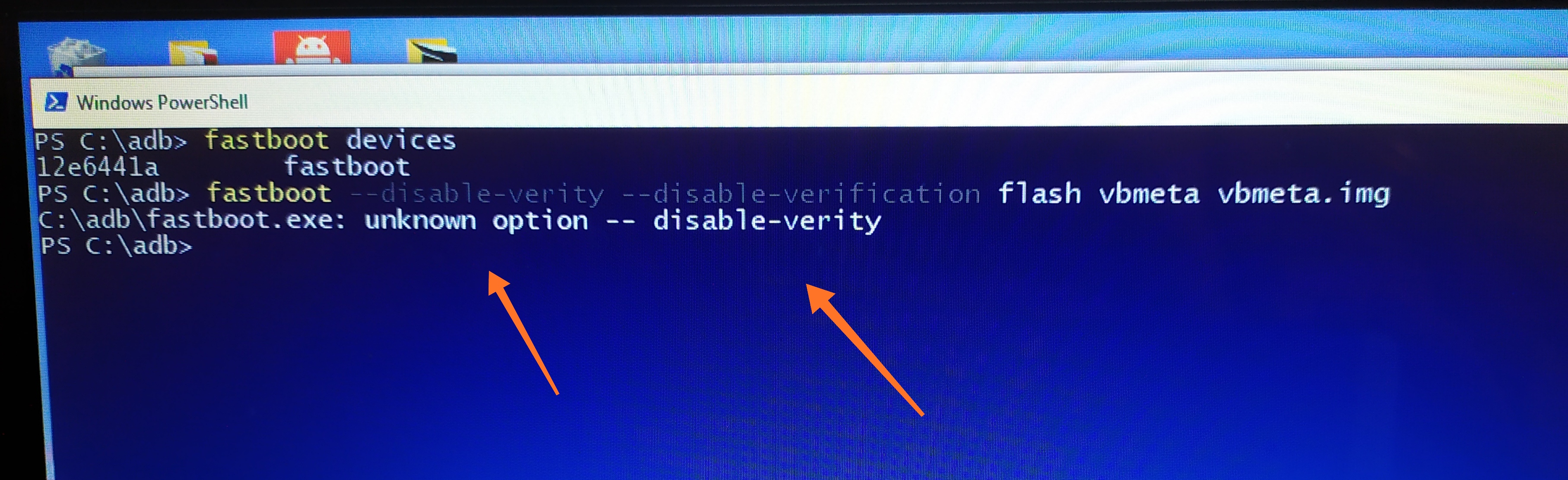

Hi, I tried to install recovery as described in the first post and also watched the video, but the recovery does not install and I get this screen with unknown option - disable-verity. How can I solve?
copy this line then paste it in command line
fastboot --disable-verity --disable-verification flash vbmeta vbmeta.img
