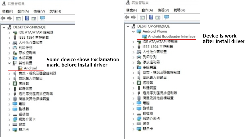

Hey thanks for the guide Ive been trying to install it with my cousin for his Mi11 but it won't react after entering fastboot boot twrp. Omg and I say waiting for devices even tough the device is unlocked and in fastboot mode and USB debugging is activated as well pls help
Do u see the phone as ADB Device in the device manager when its connected via USB cable? If not.. then..
Reinstall the driver (the official one) http://bigota.d.miui.com/tools/xiaomi_usb_driver.rar
Pro tip: Put your Windows before into "Test mode" (google for it) it makes the driver installation easier.
https://www.tenforums.com/tutorials...river-signature-enforcement-windows-10-a.html <-- There are two options - choose one.
To check device manager from your computer first, I show you the different about W/O & W/ driver.

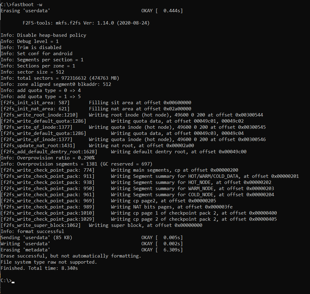

You can try to wipe the data partition and the cache partition in Fastboot mode, the fastboot command is fastboot -w
Thanks a lot for keeping up with me mate,
Fastboot -W doesnt seem to do the trick .. I get this error
