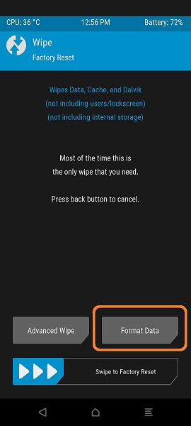

Now I'm stuck in a bootloop into TWRP. Model is Mi11Ultra.
Hey guys I tried flashing with the following steps:
1. Copied xiaomi.eu_multi_MI11Pro_MI11Ultra_V12.5.20.0.RKACNXM_v12-11.zip to main sd storage
2. fastboot boot Mi11Ultra(Pro)-twrp3.5.1-recovery-21.5.9-decrypted.img
3. Install xiaomi.eu_multi_MI11Pro_MI11Ultra_V12.5.20.0.RKACNXM_v12-11.zip
Make a Format Data.
Instalace recovery ROM (TWRP).

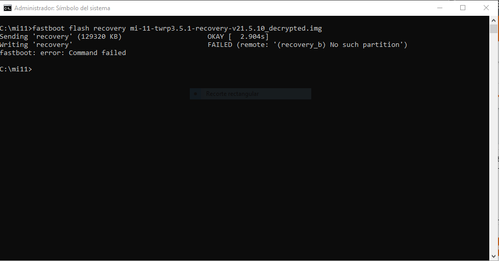

On mi11 miui global 12.5.9 stable. bootloader unlocked
C:\mi11>fastboot flash recovery mi-11-twrp3.5.1-recovery-v21.5.10_decrypted.img
Sending 'recovery' (129320 KB) OKAY [ 2.904s]
Writing 'recovery' FAILED (remote: '(recovery_b) No such partition')
fastboot: error: Command failed
Why can't I install recovery?

Rename the recovery mi-11-twrp3.5.1-recovery-v21.5.10_decrypted.img to twrp.img

Don't be lazy and read first post...
