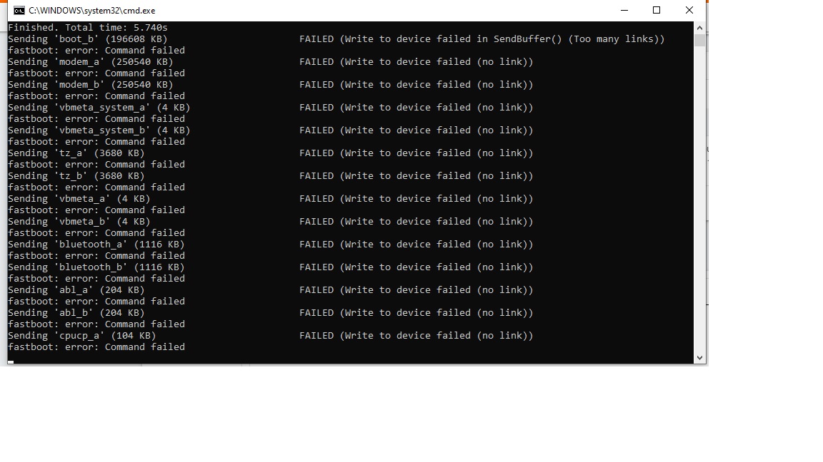

hey guys.
I have a bit problem, I think.
So, I was on 13.0.12 china rom, unlocked bootloader and tried to flash xiaomi.eu 13.0.12 with first install with data format. however, it doesn't seem to work, errors, all over.
What do I do?

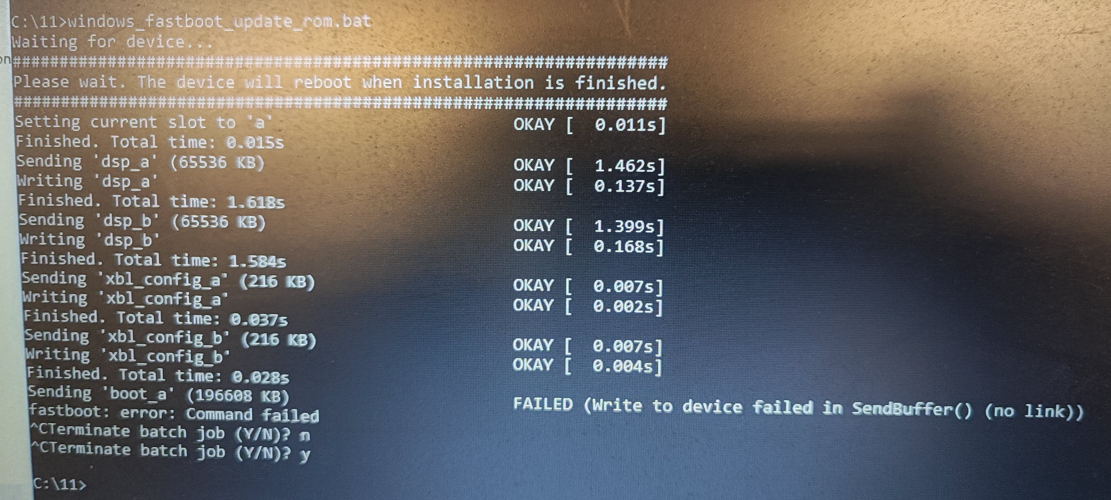

I was using TWRP on 12.0* stable rom for Xiaomi 11 (Venus).
Today, I tried to install 13.08 stable rom with fastboot and it brick my phone.
what should I do ? any luck that I could get the phone up ?
I guess TWRP caused the brick; fastboot installation failed at "sending"boot_a".
how did you try to install it?

hi,
not sure if I get you correctly.
I put my phone to fastboot.
=> windows_fastboot_update_rom.bat
attached is the screenshot
or should I NOT terminate that and be patient.
