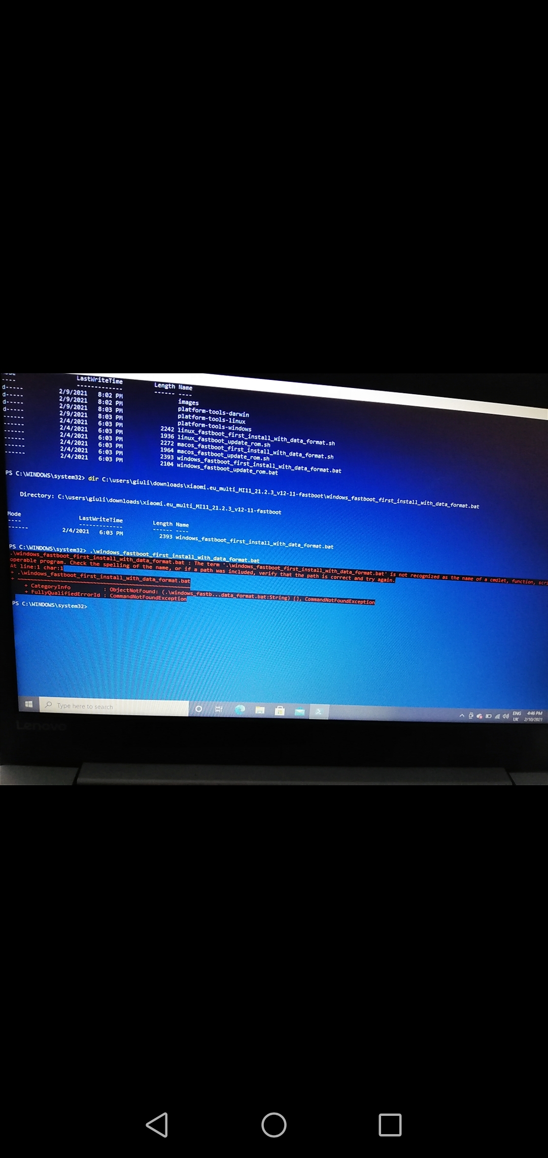

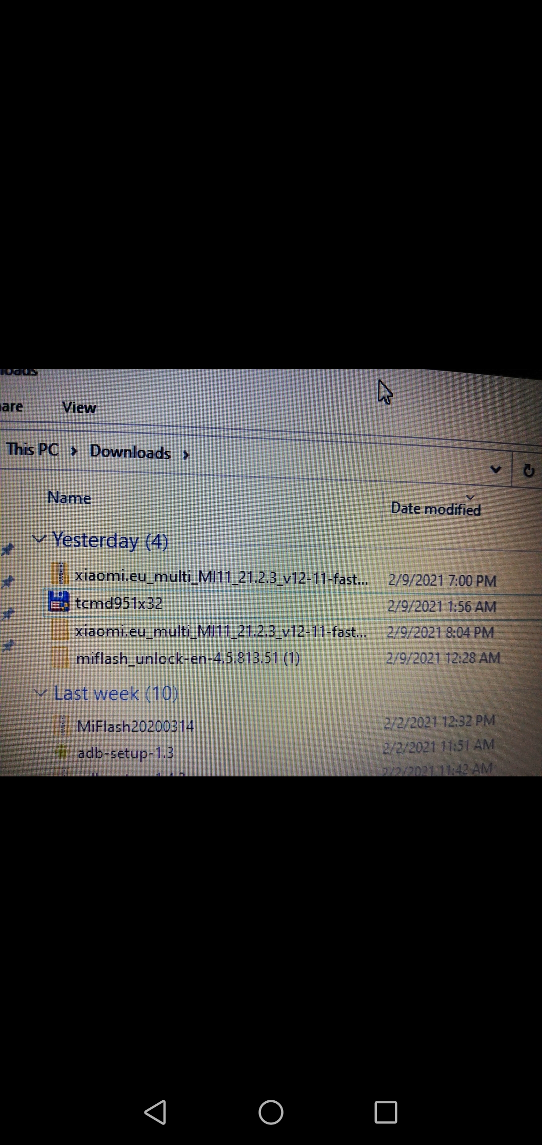

Here is what i did. I downloaded the eu rom, unzipped, then i opened power shell as admin and navigate into the folders and as you can see at the end i can't go ahead. I have never done staff like that before, I'm new on all this so am i missing something?? What i did wrong?
- Connect your device in fastboot mode
- open the rom folder and right click on an empty space while holding shift key
- click open command window here
Type "windows_fastboot_first_install_with_data_format.bat" and hit enter
Na so you go run am ;)
EDIT: i see where your issue is.
From your 1st screenshot it is looking for the script in "c:/windows/system32"
You need to change your current directory to the rom folder directory
cd c:\users\giuli\downloads\xiaomi.eu_multi_MI11_21.2.3_v12-11-fastboot
Hello, you don't change your current directory with the " dir " command. You should use " cd " command. ^^
