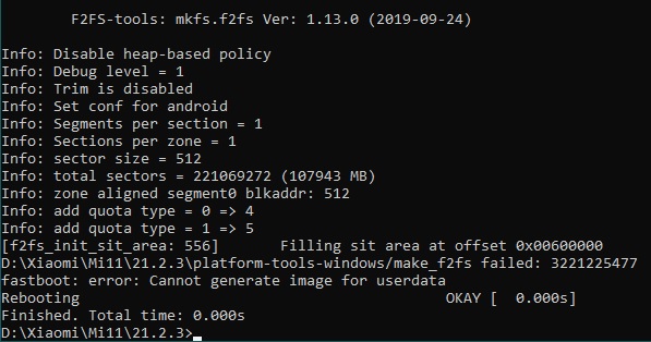

My phone boots up just fine, doesn't seem to be any problems but I got this error at the end of the flashing. Someone else also posted this error so just hoping someone can say what causes this and if they think any problems will arise? Thanks, devs!
34934
Nuschi
May 3, 2020
11
i had the same mistake. Now I install everything with Knoppix. This works flawlessly on every Windows system. Its a simple DVD...
